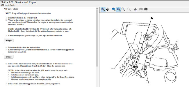

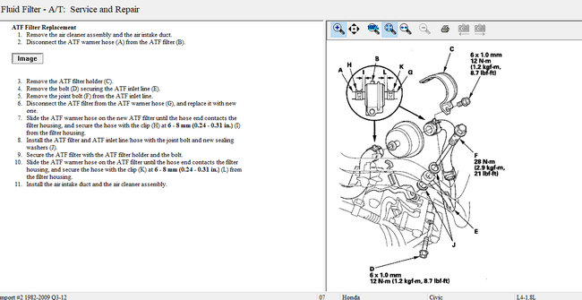

Where is the transmission filter located in the car listed above LX model?
Feb 28, 2018 at 3:21 AM
SEVAG P
  • 405 POSTS
transmission fluid filter located inside engine compartment under the air cleaner assembly, check the picture below.

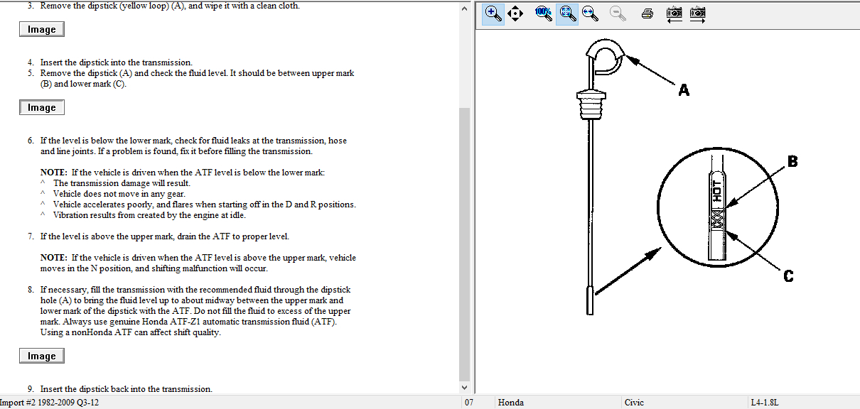

also check the procedure how to check the ATF fluid level.
