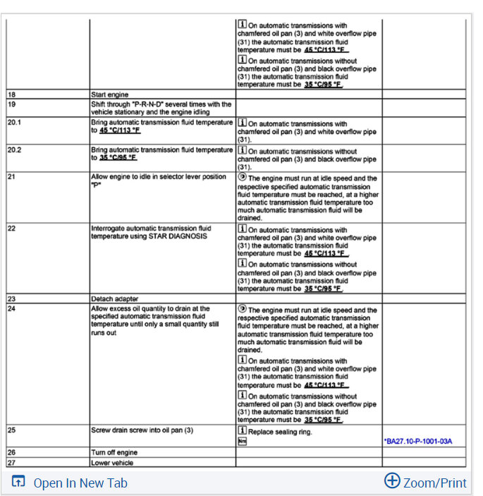

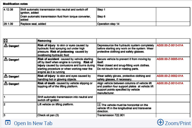

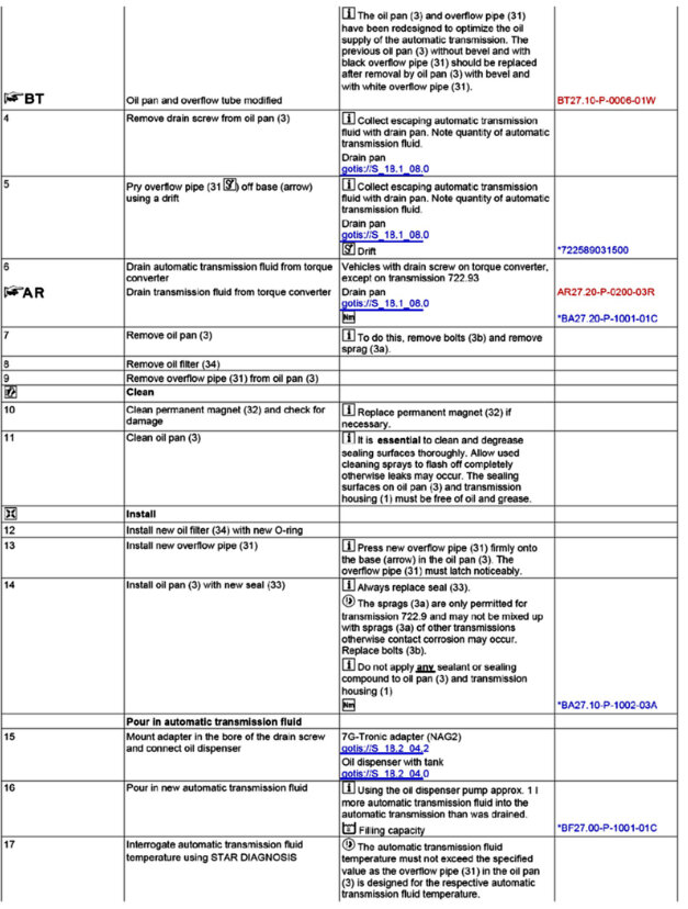

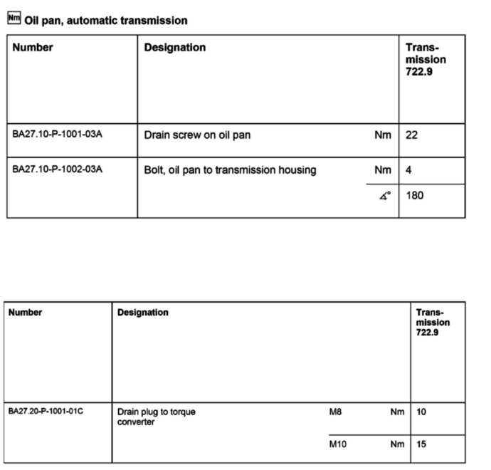

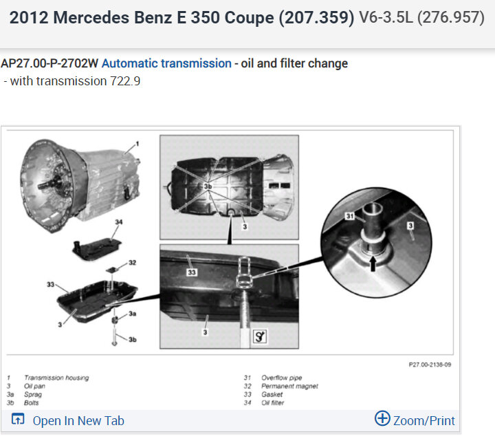

Oh yes, the transmission fluid must stay in good condition so I would change it out, also I would clear the adaptive learning as well so the car can relearn. I have found that helps a lot as well.
Fuchs .................... Titan ATF 7134 FE
MB 236.15 ATF .................... A 001 989 77 03
MB 236.15 ATF .................... A 001 989 78 03
MB Automatic transmission fluid .................... MB 236.15
Shell .................... ATF 134FE
Shell .................... Spirax S6 ATF 134ME
