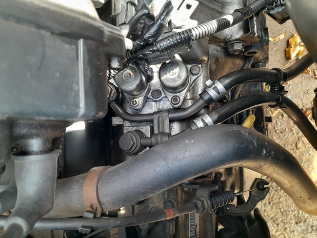

Hi, when I drive on D4, the gear stuck on 1 and does not change to 2nd 3rd gear immediately. I have to drive at least 50 mts with higher acceleration, then only the gear moves to higher gear. Sometimes, i change it to D2 for it to shift on 2nd gear, drive a little, then change to D4 for the gear to move on 3rd and 4th.
There's also a transmission oil leakage but I have checked it and cannot find where the leakage came from.
I have also noticed a vibration issue on slow acceleration but when accelerating more, it disappears.
It has been more than 6 months and I still cannot find a solution of oil leakage problem. If the engine is hot or have been driving for a while, then nonissue of gear shifting.
Thanks for your help.

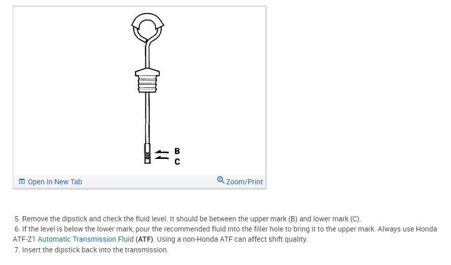

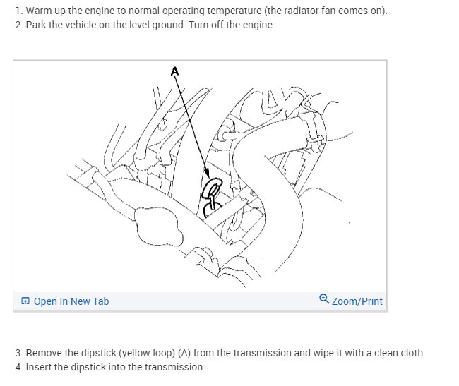

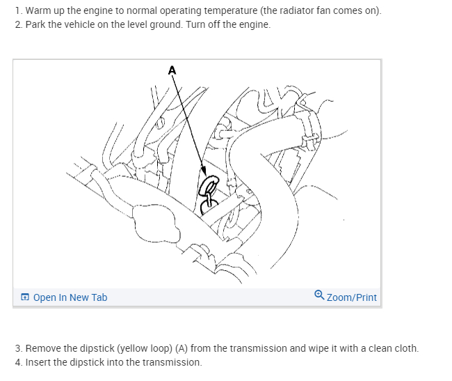

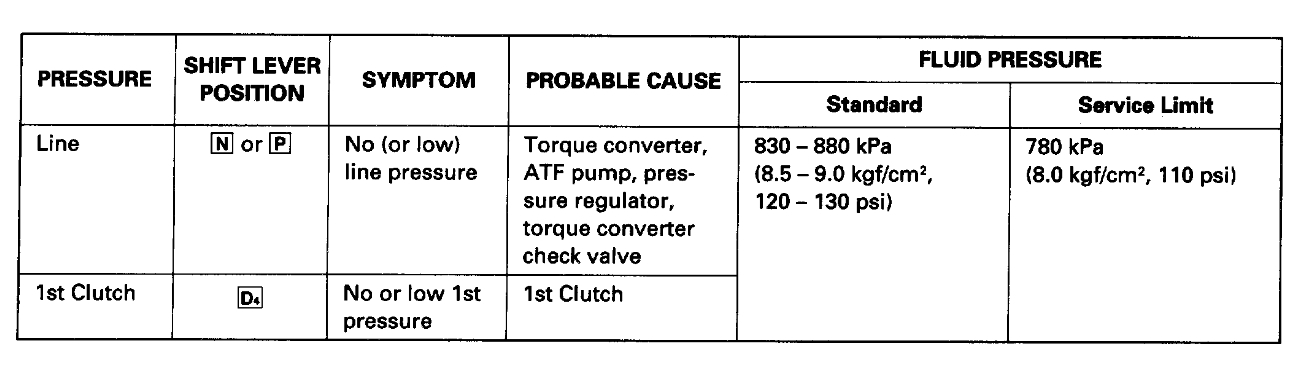

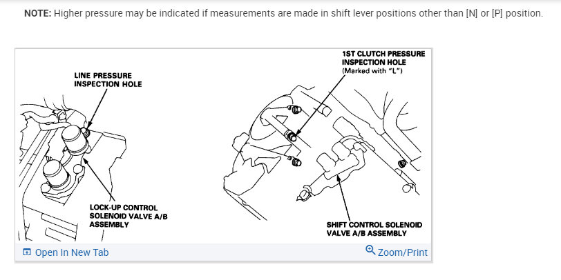

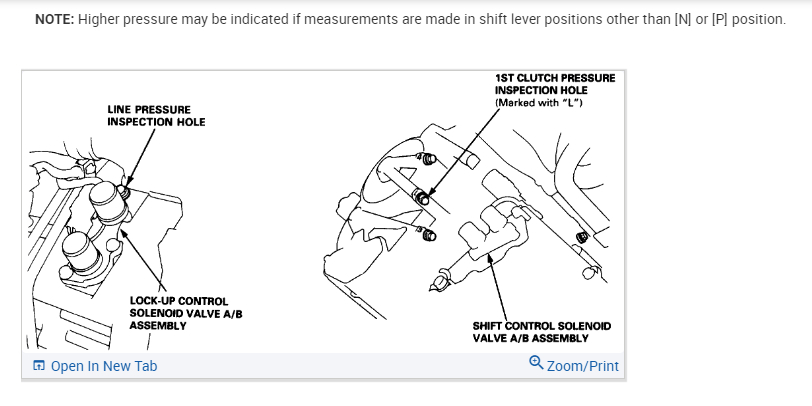

What you described sounds like it could simply be the result of low transmission fluid. Have you checked the level and condition of the fluid? If not, do that first.
https://www.2carpros.com/articles/how-to-check-and-add-transmission-fluid

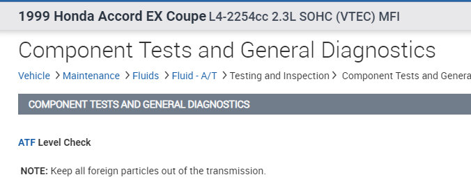

If you look at the three pics below, they are the directions specific to your vehicle. Follow them and let me know what you find.
Aug 7, 2023 at 12:43 PM

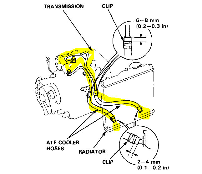

  • 110,244 POSTS

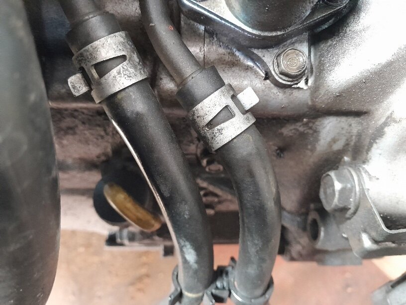

If the leak is bad enough and we lose line pressure, that can cause issues. There are two transmission cooling lines. Both will go from the transmission to the bottom of the radiator. Check to see if either one is leaking. See pic below.
See pic below.
Aug 8, 2023 at 1:11 PM

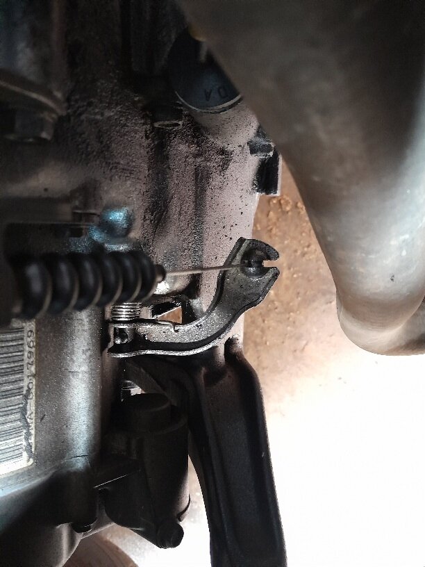

TRISHNA SINGH BUNDHOO
  • 22 POSTS

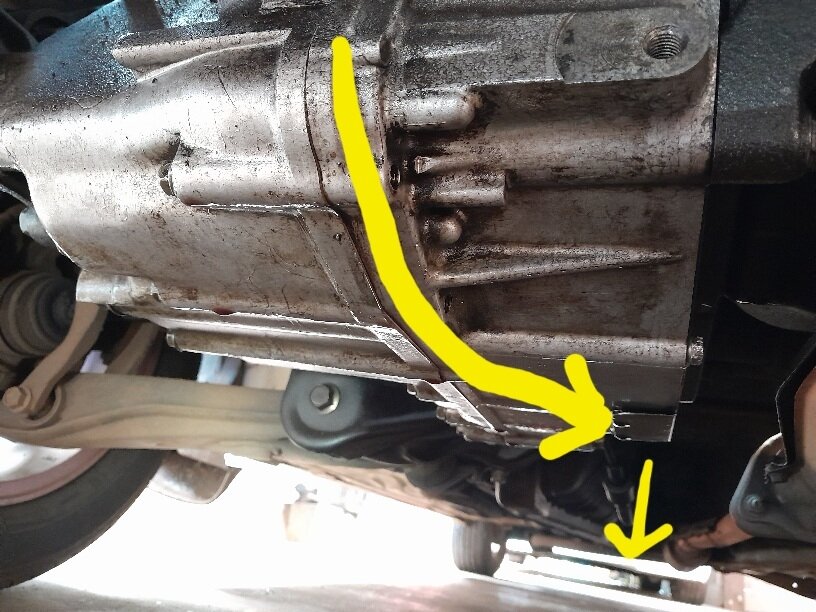

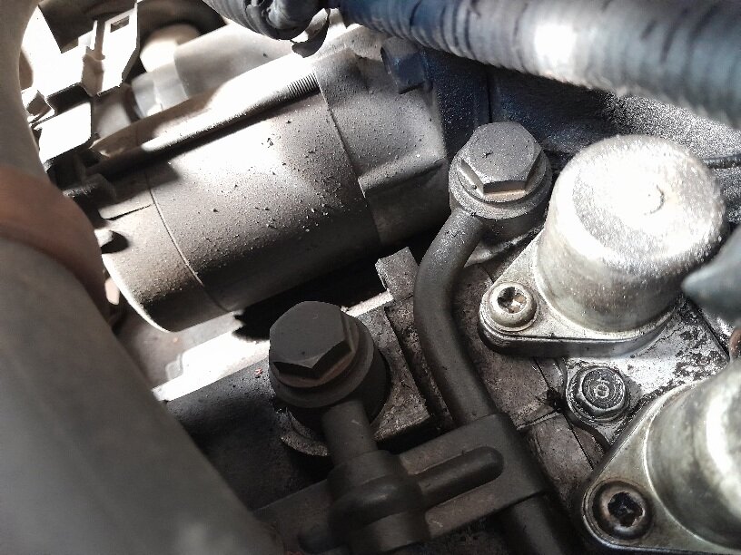

Hi Joe, have checked the places where u said and all okay. I have found some oil accumulation of oil some other places but cannot figure out where it is coming from. Also attached a picture with arrow to show the flow of oil and where it comes down. Some pictures also to help. I cannot figure out where the leak is or why the gear shift problem.
Aug 12, 2023 at 4:20 PM
  • 110,244 POSTS
Thanks for the pics. I have to say I don't see anything that appears bad enough to cause a pressure issue.

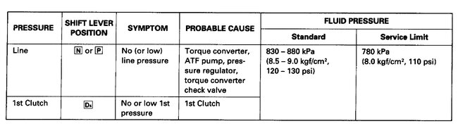

  • 110,244 POSTS

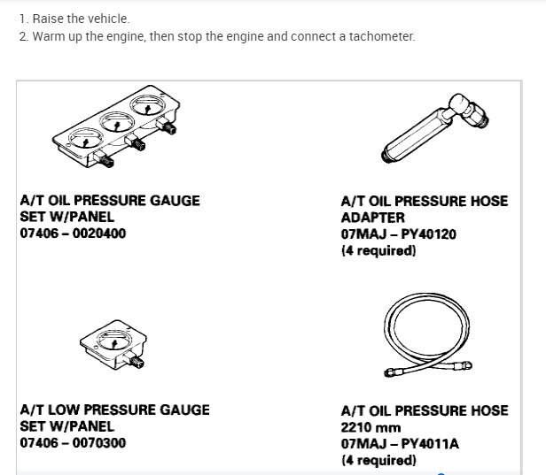

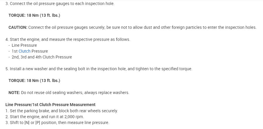

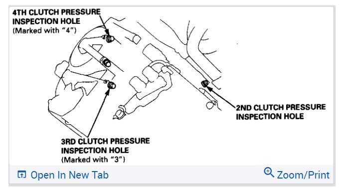

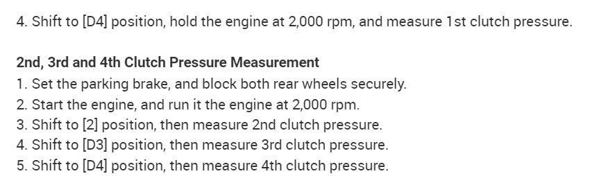

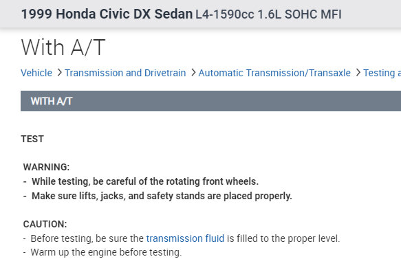

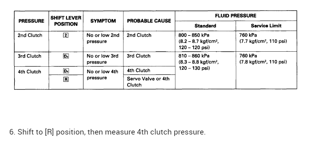

The solenoids could be on the outside or inside of the transmission. If you want, I attached the directions for testing transmission line pressure. It requires a few special tools.
Take a look at the directions and let me know if you are comfortable performing them.
Aug 23, 2023 at 12:12 PM
  • 22 POSTS

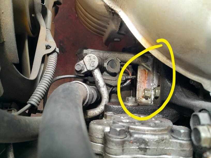

Hi Joe, sorry to get to you so late. Have been trying to look for the tools. Unfortunately, it is not easily available and if it can be found, the price they are quoting is not cheap.

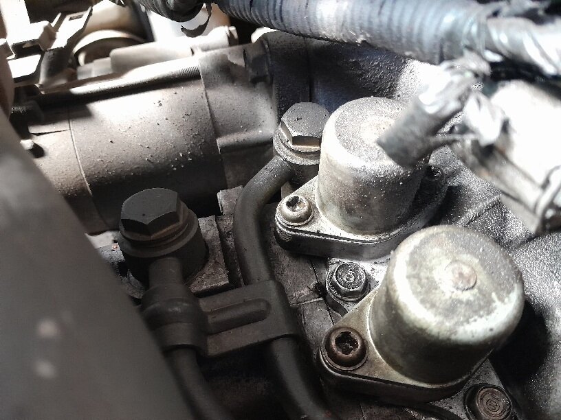

For the solenoid valve, it is outside the transmission, just below the distributor.
See the attached pic.
What is confusing is that, in the morning, when driving on D4 it is stuck in 1st gear. If you put it on 2, then change to 2nd gear. After driving around 200 mts, if shift back to D4, then it goes up to 3rd and 4th gear.
Anyhow, thanks for helping and if you can give more suggestions, I would be grateful..
Sep 19, 2023 at 9:28 PM
  • 110,244 POSTS
The idea that it works when you shift manually to second could be a pressure issue or even a shift solenoid issue. Are you able to scan the can-bus to see if there are codes related?
