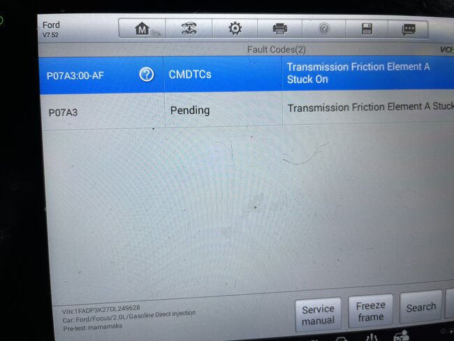

Jerky between 2nd to 3rd ir 4th gear, once u pass 45mph its great. Replaced the actuator under air-box cause that's the code i had, p07a3 now code is still pending. Could that be a fluid issue? I turned the actuator with a screwdriver 14 times and dis coke back quickly. Sprayed cleaner in there still same. I did not do anything with the actuator below.

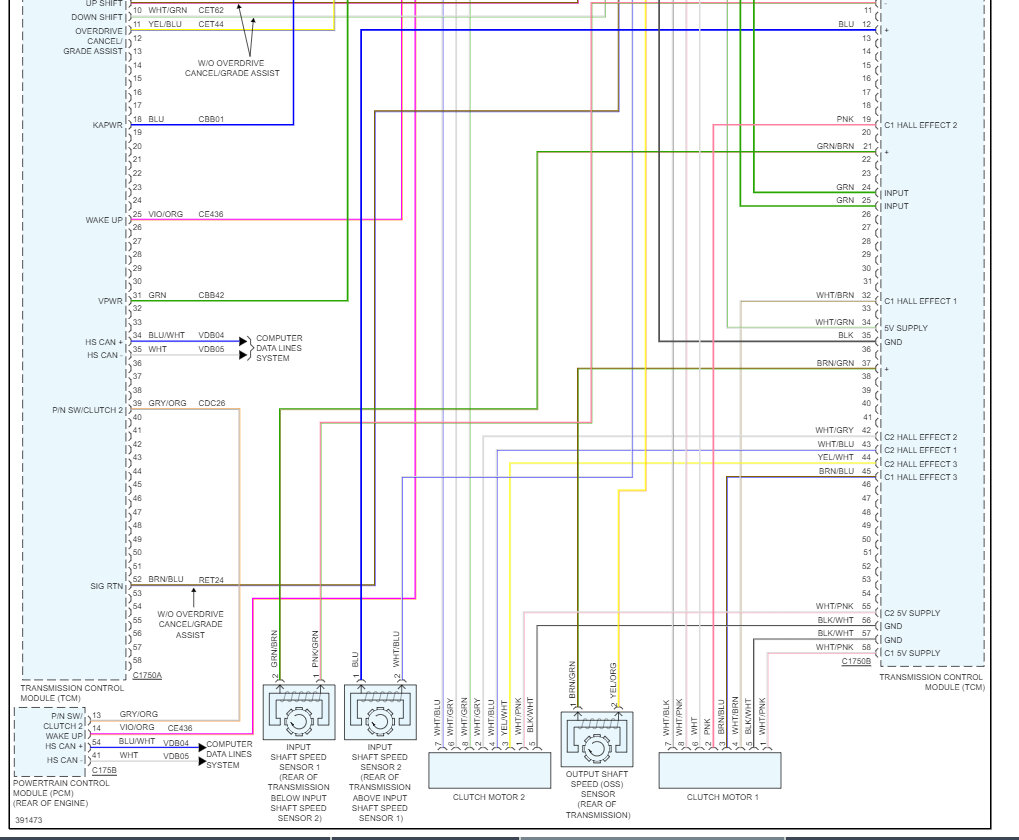

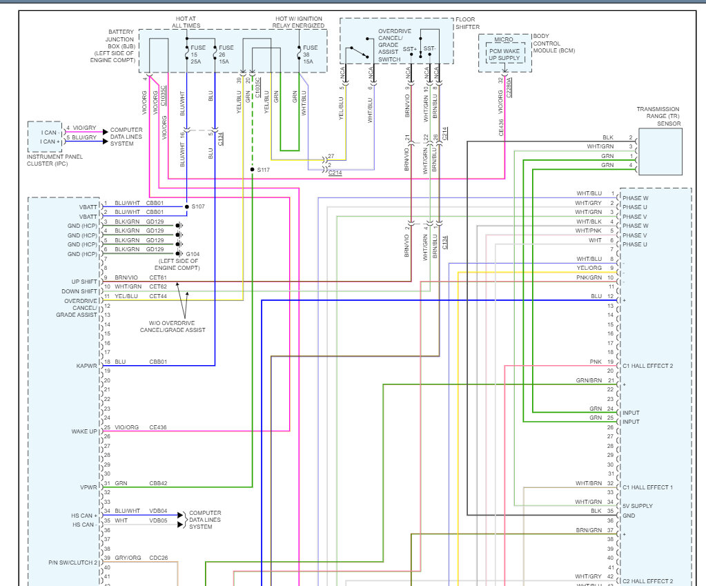

A P07A3 is usually caused by a malfunctioning clutch actuator or faulty clutch actuator fork. The TCM can also cause this.
Check out the images (below). Please let us know what you find.

But when i searched for this sensor it says everywhere that it's a code starting with 8, like p0871.
Aug 11, 2023 at 10:01 AM
BHAMDOC1973
  • 2,007 POSTS
But when looking at my code online it says Friction element A stuck on.
Aug 11, 2023 at 10:02 AM

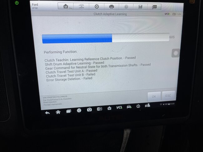

While doing transmission adaptive learning i got this.
Aug 14, 2023 at 5:02 AM

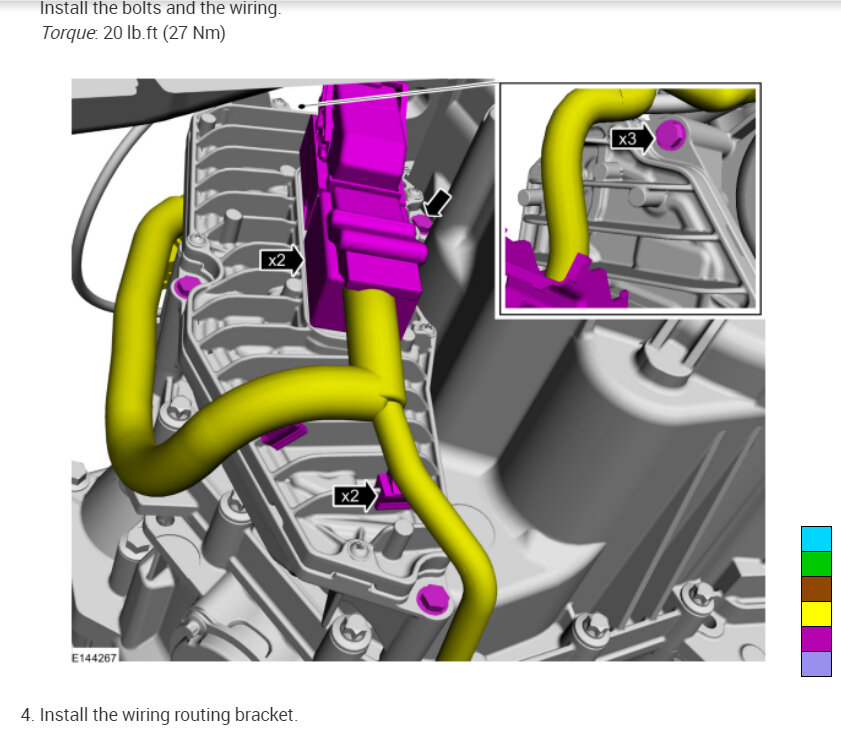

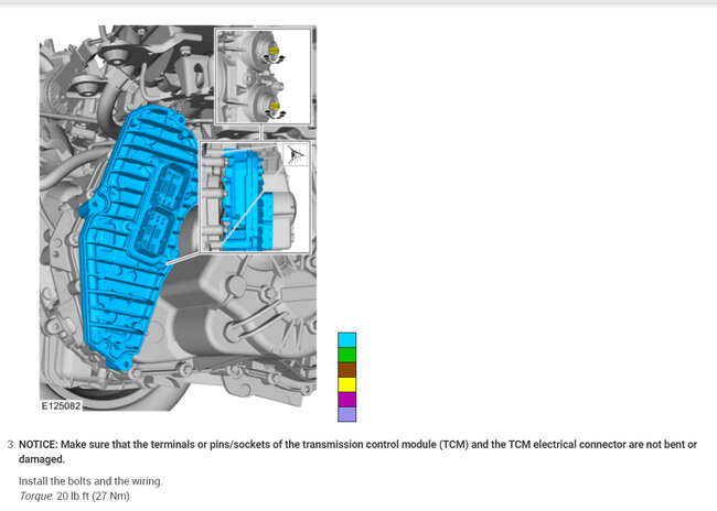

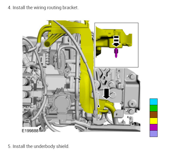

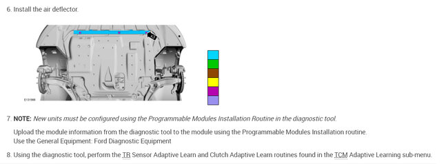

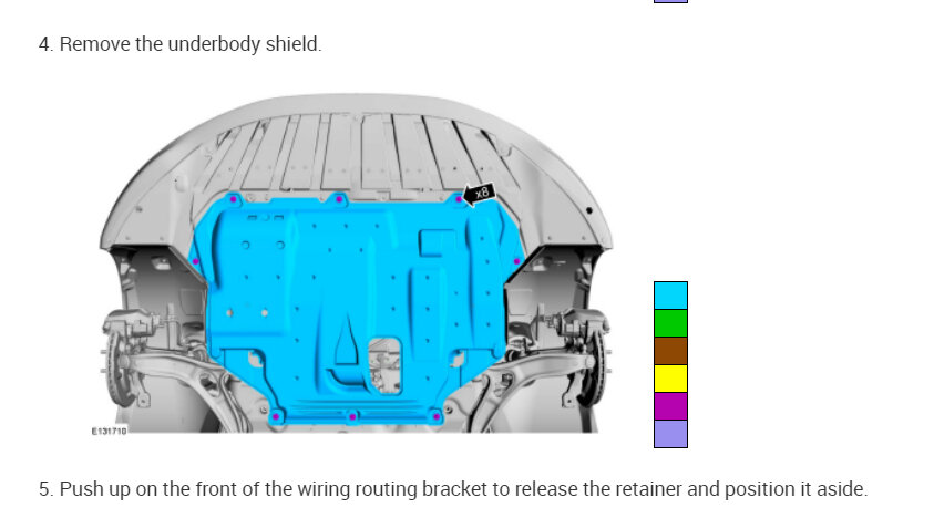

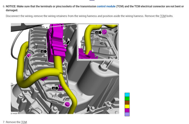

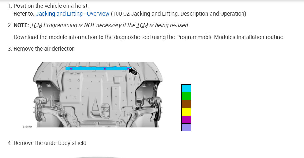

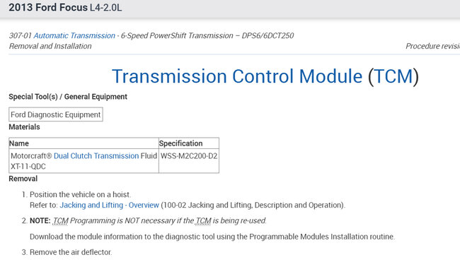

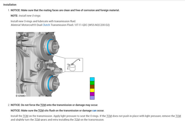

  • 55,746 POSTS

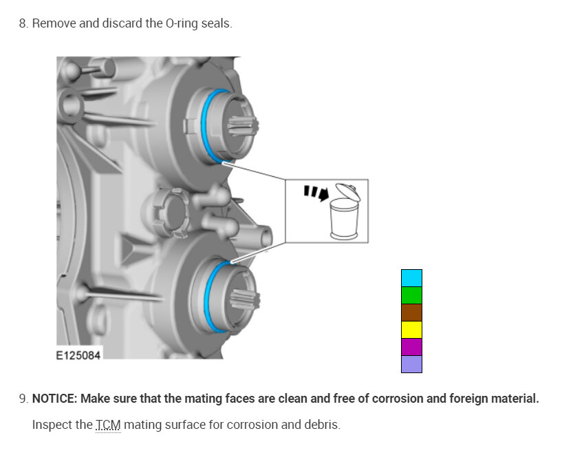

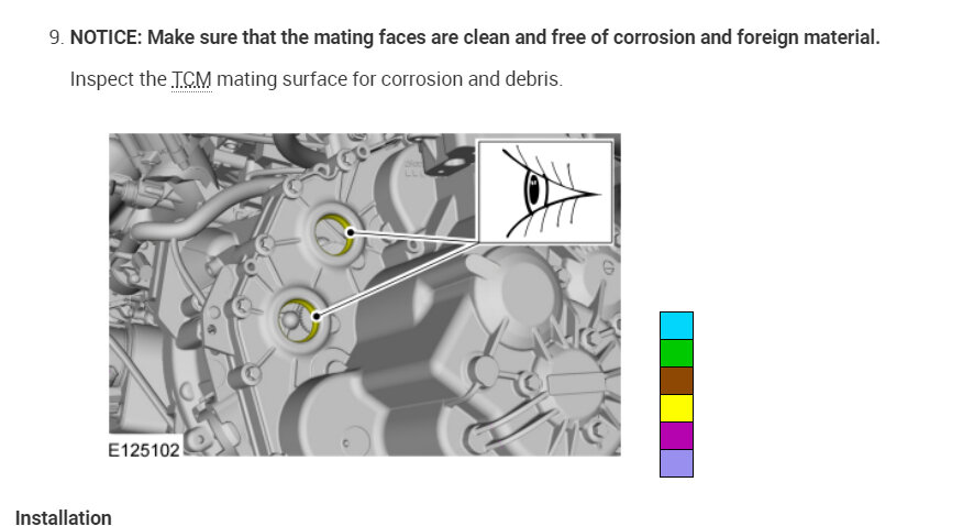

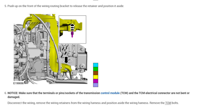

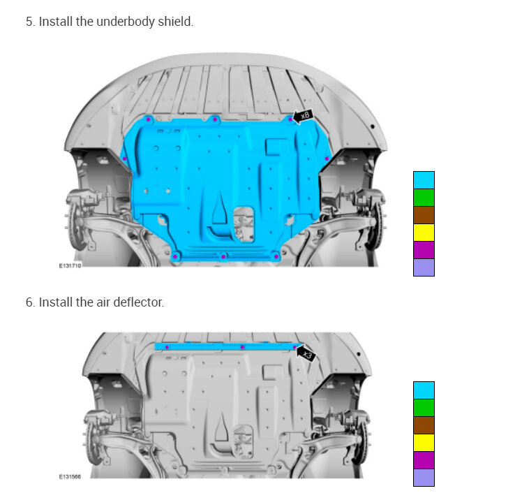

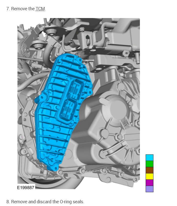

Did you change the actuator on top? Also, I have seen the TCM go out and cause this as well. This is common. Here is how to change out the TCM. Check out the images (below). Please let us know what you find.
