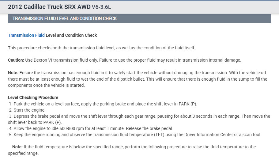

I was driving down the road and I went to accelerate to go into a passing Lane and I lost all acceleration, I was able to pull off to the side of the road and put it in park. I then went to put it in drive, and I had no gears except for reverse currently my vehicle has been down for several weeks because it did not throw the check engine light on a transmission light on or codes as to my car giving transmission problems what can this be. Like I said my car will only drive in reverse it had full transmission fluid as well.

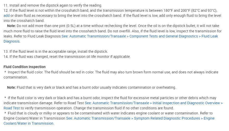

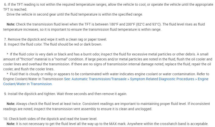

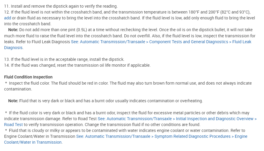

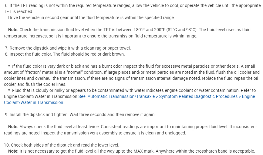

Also, have you checked the transmission fluid level and condition? If not, I would recommend doing that as well.
I attached the directions below for the fluid test. Also, let me know if the fluid has been changed and if the gear indicator is indicating the correct gear.
