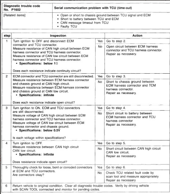

Transmission issue, jerks when put in reverse, will not change gears

I was finally able to get the code; it is p1602.

Hello again,
It sounds like you are having a problem with the TCU (transmission control unit). I've attached a diagnostic chart below to help test.Hope this helps and thanks for again for using 2CarPros.

My hot battery cable was extremely loose is there a way to reset the TCM.

Had the code cleared.shifted good ..but when I started the car back up again had the problem again

Hello again.
By just clearing the code if there is a fault the condition will keep showing up as in the case here until the repair is completed.It sounds like you are having an issue with the TCM (transmission control module) I will re-attach the diagnostic procedure again below.Hope this helps and thanks again for using 2CarPros.

Hello again,
Hoping it just could be a wiring issue. However, just to prepare you a new transmission control module from a Kia dealership is $940.00. Let us know what you find out.Thanks again for using 2CarPros.

Hello again,
After you tighten the cable let us know if the symptom returns.If so, please use the transmission control module diagnostic chart I've attached previously.Hope this helps and thanks again for using 2CarPros.
