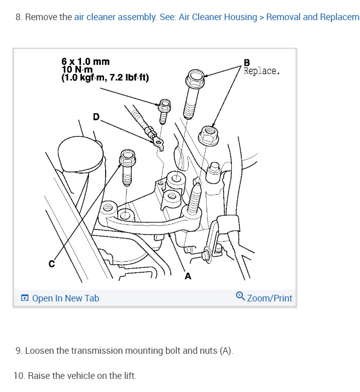

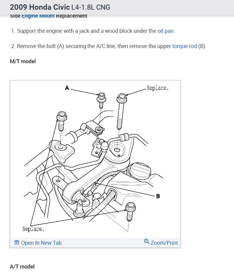

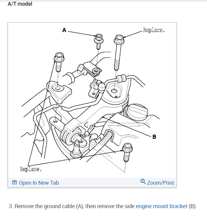

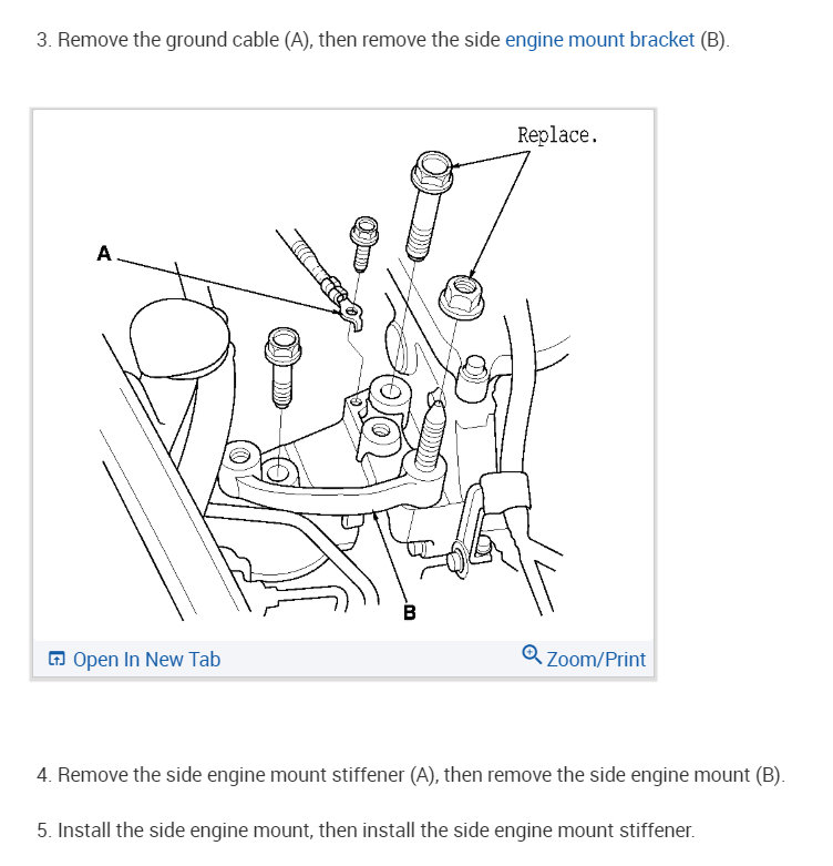

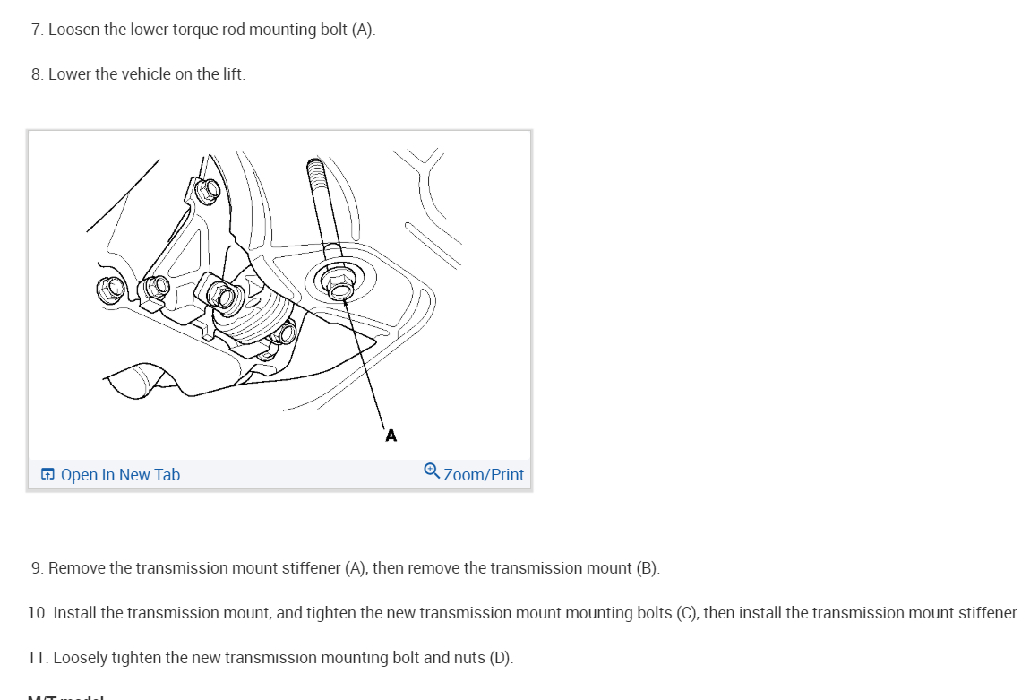

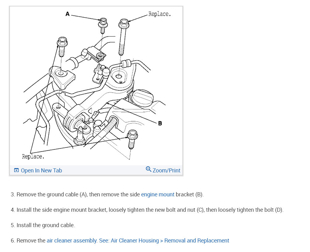

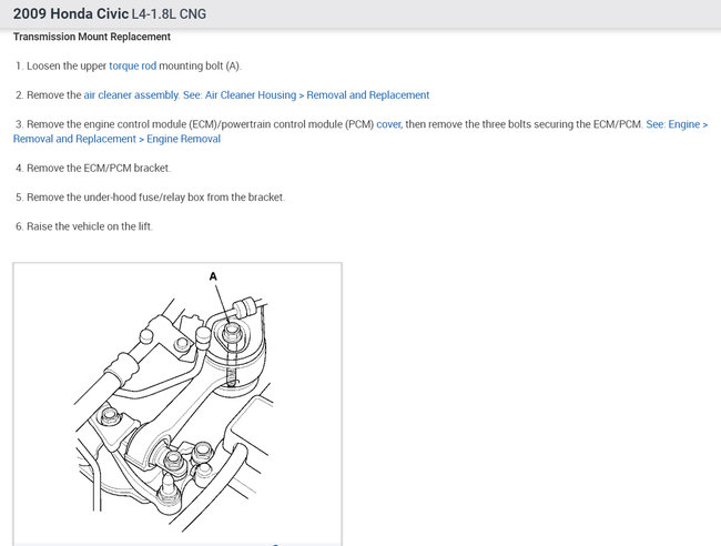

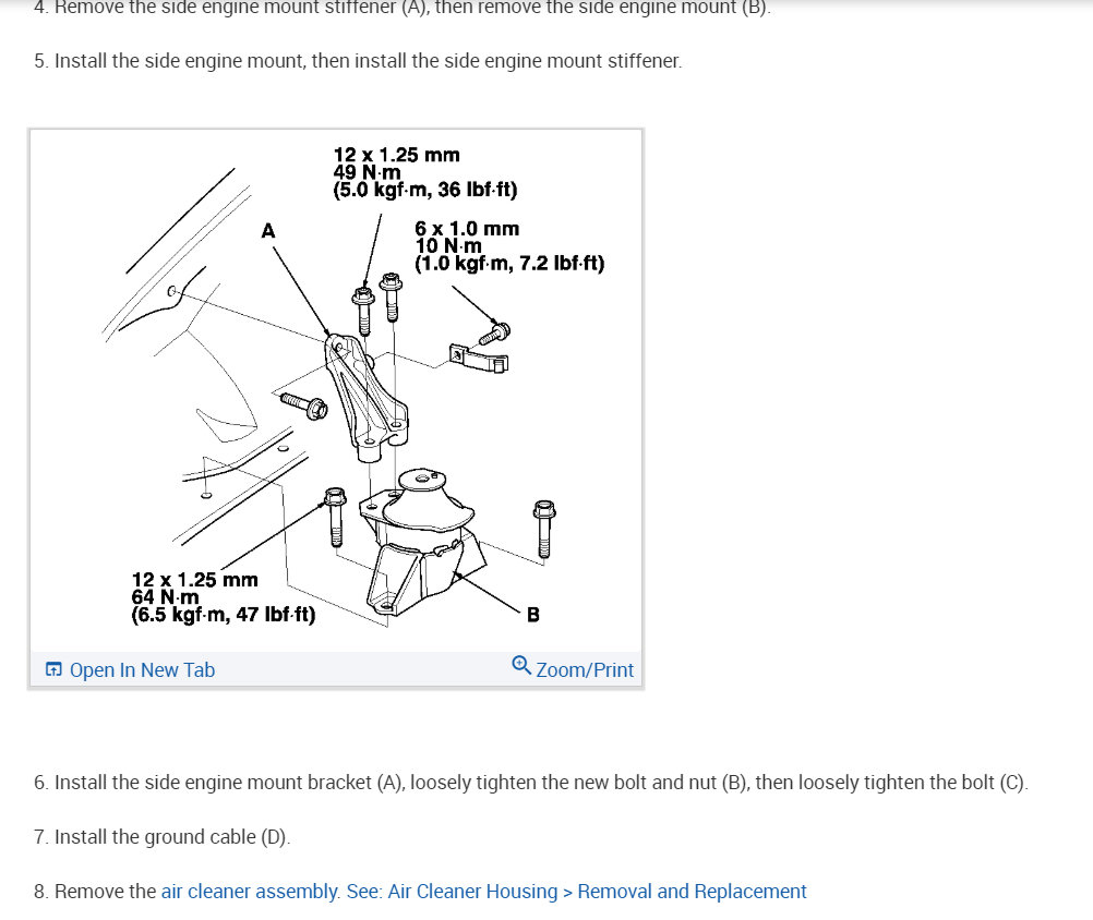

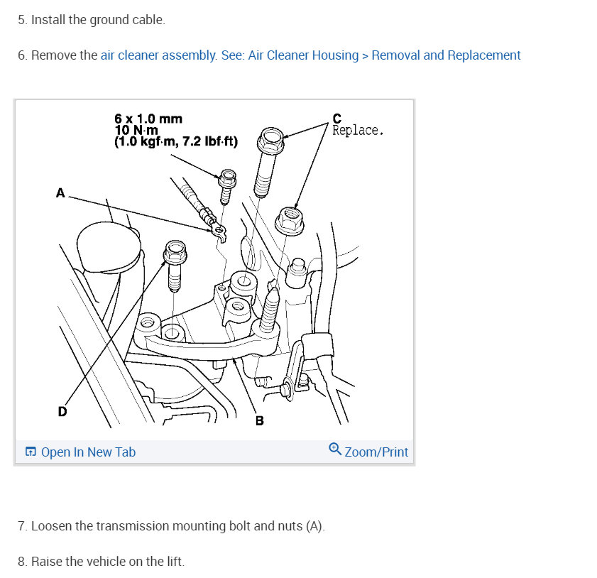

CARADIODOC is one of our best! Here are the instructions on how to change out the engine mounts so you can see whats going on. Check out the diagrams (below). Please let us know what happens.

Thanks so much Ken. and CARADIODOC. One last thing, which bolts does Honda recommend to swap out when installing the engine/transmission mounts and the upper and lower Torque Rods?
Aug 1, 2020 at 8:44 AM
NICK TCHALAKIAN
  • 6 POSTS
Oops never mind I see them in the diagram. Thanks again and stay safe!!!
