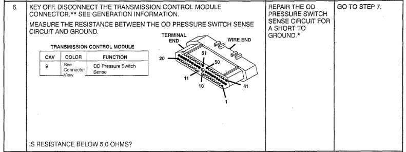

i used my scanner again and all i got was a dtc 21 so ?
May 7, 2024 at 6:24 AM

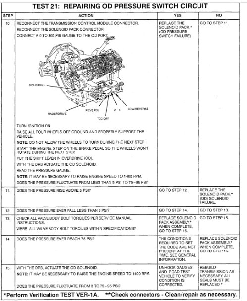

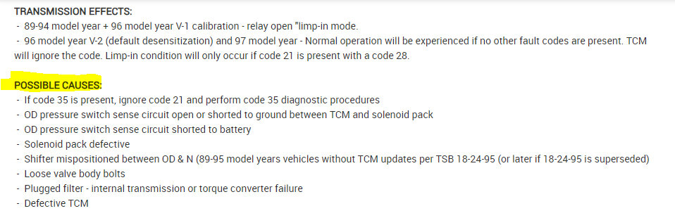

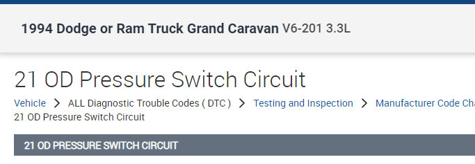

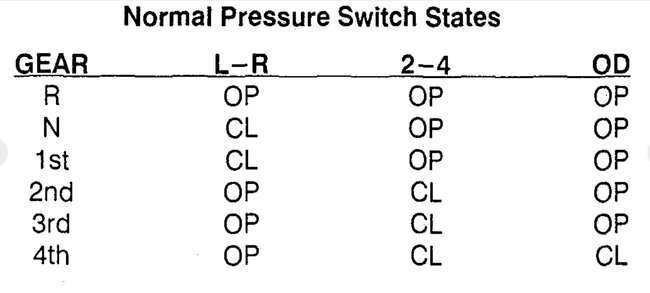

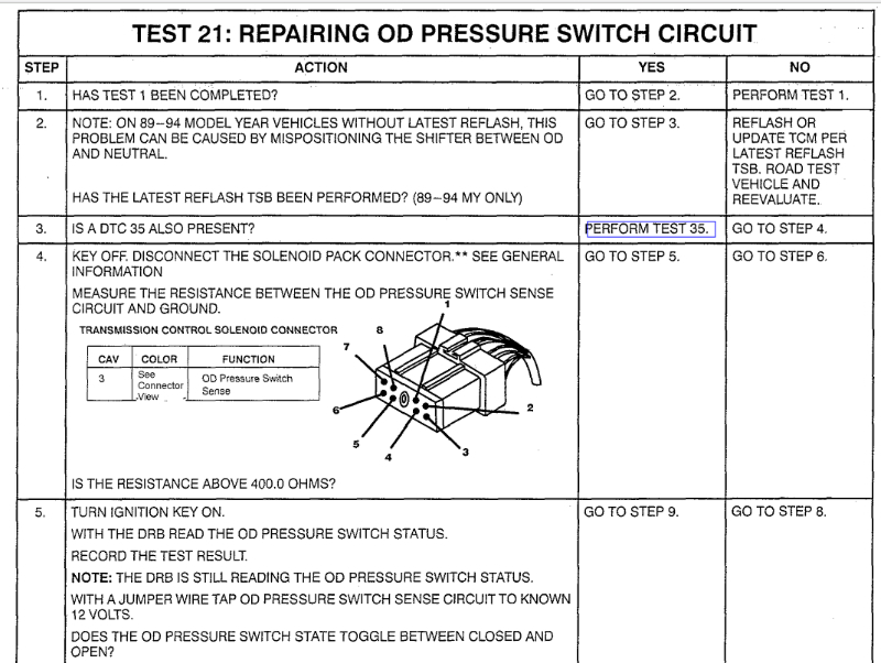

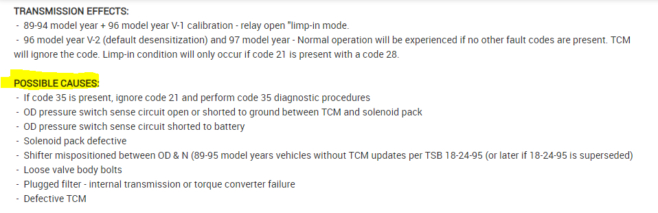

  • 110,244 POSTS

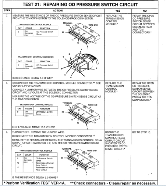

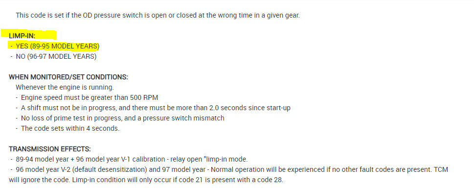

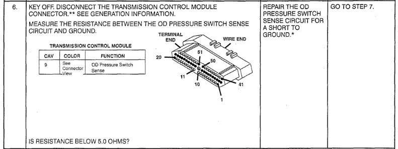

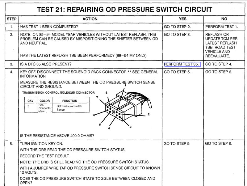

Code 21 is related to the OD pressure switch circuit. I attached the diagnostics below specific to that code. The code indicates the OD switch is either closed or open when it shouldn't be.
Take a look through the diagnostics and let me know if you are comfortable performing them. Also, let me know what you find.
See pic below.
May 7, 2024 at 11:58 AM

Hi Joe, the code 21 was done with my engine scanner. i don't have a trans scanner. So how can i figure out my speedometer doesn't work? wouldn't that give a dtc on my engine scanner? i asked for specs for the input and output speed sensors first rather than replacing them. thanks
May 8, 2024 at 1:11 AM

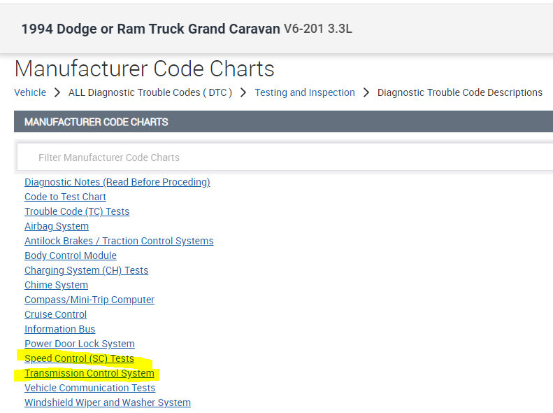

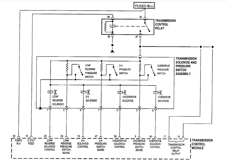

  • 110,244 POSTS

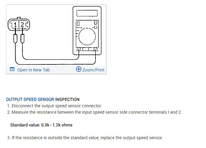

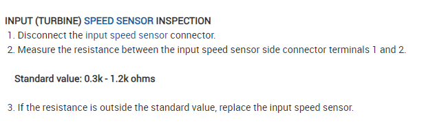

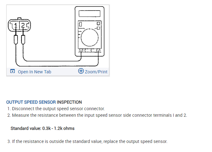

When I look for the code in my manual, the engine doesn't show up. Other things do including the transmission and the cruise control. (see pic 1)

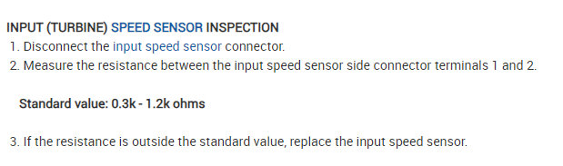

Also, I attached the diagnostics for testing both the input and output speed sensors. Take a look and let me know if it helps.
May 8, 2024 at 11:39 AM

well, joe, i encountered something strange. i see 3 sensors on my transmission 1is over the shift solenoid then there is 1 to the right of the shift solenoid then there is another to the right of that some more i pulled the harness off the one to the right of the shift solenoid and there's 3 pins in the sensor so i don't know which pins I'm supposed to use when i test for resistance ? hence I'm puzzled.
May 9, 2024 at 7:45 AM

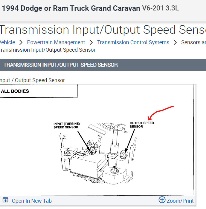

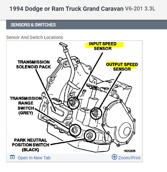

  • 110,244 POSTS
I attached a picture below showing the input and output speed sensor locations. Are these the ones you are referring to?
See pic below.
May 9, 2024 at 12:47 PM
DODGEPODGE
  • 111 POSTS
looks to be right. i guess that was the transmission range switch i pulled off with the 3 prongs. I'll try the other ones and see how many they have and try to test them? would either of them cause no speedometer? thanks
May 10, 2024 at 6:31 AM
  • 110,244 POSTS
That is very possible. As far as the speedometer, the Transaxle Control Module (TCM) calculates vehicle speed based on the input received from both the Input and Output speed sensor mounted on the transaxle. The output sensor is the most likely suspect.
I hope this helps.
May 10, 2024 at 12:42 PM

i tried to test the output speed sensor and the area is just too tight i couldn't really hold the test probes together to try to get a reading. and i didn't have the right size socket to remove it. I'm going to try to test the resistance at the TCM and see if i get a reading? Do you know if the sensors are the same for the 41te and the 41ae transmission? thanks
May 11, 2024 at 7:06 AM
  • 110,244 POSTS
If I was to check resistance, I would do it right at the sensor. The wiring itself will add to your reading.
Also, based on my manual, it is the same sensor.
Let me know what you find.

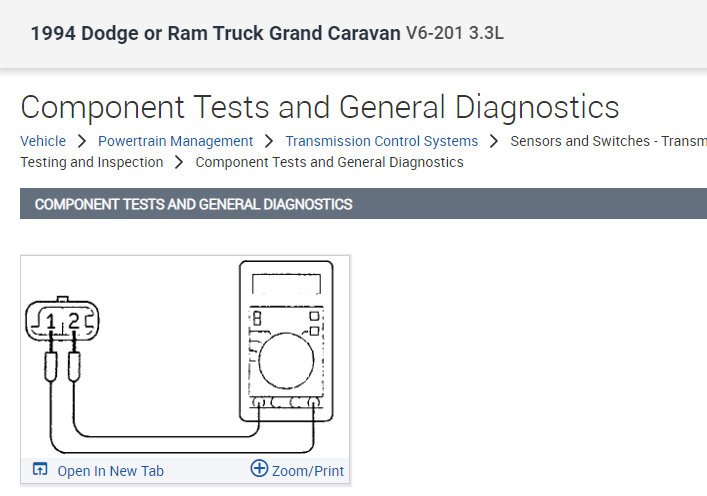

CARADIODOC
  • 34,381 POSTS
Hi guys. If I could stick my nose in here for a moment, testing speed sensor is pointless. They do not measure a resistance like a throttle position sensor or temperature sensor. Two-wire speed sensors, including wheel speed sensors for anti-lock brakes generate an AC signal voltage with the frequency proportional to speed. As with all voltages generated this way, speed is an important part of the strength, or voltage of the signal, but that voltage doesn't matter, as long as it's high enough that the computer can read it. Then, it's the frequency it cares about, not the voltage.
Three-wire speed sensors generate the AC signal voltage the same way, but then there's additional circuitry that puts out a very nice clean square wave. With their very definite rise and fall times, the timing of those signals is very precise. That's not important for speed signals, but it is for position sensors like the crankshaft position sensor and the camshaft position sensor.
To test a speed sensor, you need to connect an oscilloscope such as is used in tv repair, and you must be able to run the vehicle in gear. There's a much easier and less complicated way. That is to simply use a scanner to view live data, and see what it shows for the engine speed, road speed, or wheel speed. If the computer can read it, the sensor is working.
I've been following along to learn the solution. That's why I noticed too much time is being spent on trying to do a test that can't be done.
By the way, a lot of competent do-it-yourselfers also figure out they need to read these signals with a digital voltmeter set on AC Volts. That won't work either except to tell you if there's something vs. nothing. Digital meters are designed to read 60 hertz voltages as found in house wiring. Some expensive meters will be accurate up to 400 hertz for military use. The front tone ring on a mid '90s Caravan brake rotor has 57 teeth so the sensor will generate 57 hertz when the wheel is spinning at one revolution per second. Since speed is a factor in signal strength, the signal voltage is very low at that speed, and will likely be too low to be read by the computer. That, in part, is why all ABS systems deactivate below 9 or 15 mph. At faster rotational speeds, the signal voltage will increase, but the meter loses its response, and will likely show a lower voltage.
I should correct myself too in that you CAN measure the resistance of a two-wire speed sensor as it is just a long piece of wire wrapped around a magnet. It's extremely rare to have one read the wrong resistance value, so it isn't really necessary to know the specs. Those specs are provided in service manuals, but only for reference, and for training purposes. You're looking for infinite resistance, meaning an open circuit, to show if one end of the wire is broken off its terminal internally. If you find anything other than an open circuit, the wire is okay. Common or typical values range from 100 ohms to as much as 750 ohms, (that I have memorized), for the distributor pickup on my '78 LeBaron. You can't get to that coil of wire to measure its resistance in a three-wire sensor. The only thing you can do with those is live testing by running something to make the sensor generate its signal.
While not real common, a speed sensor can fail intermittently and work at other times, depending on temperature, vibration, or flexing wires like with ABS wheel speed sensors. A more common source of intermittent dropouts of the signal on some sensor designs is too large of an air gap. For most designs, that is set by the design of the mounting bracket, but there have been some that need special procedures to set that air gap.
Hope that helps you move ahead to solve any remaining problems.
