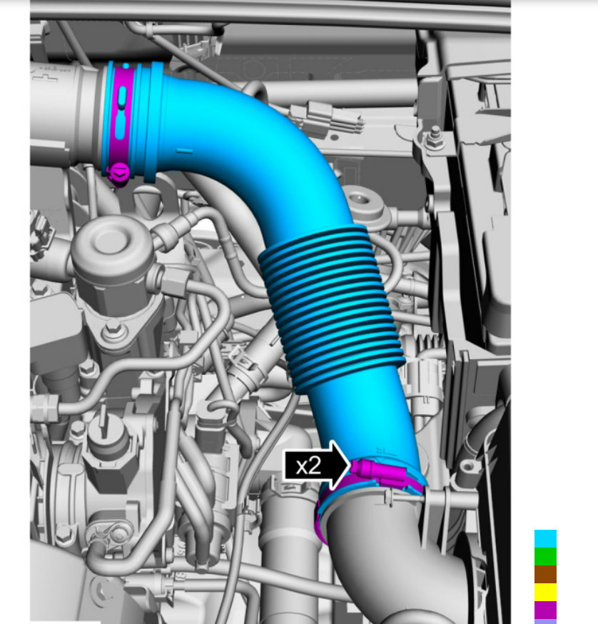

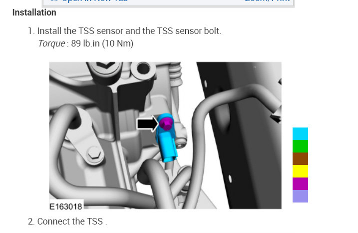

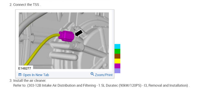

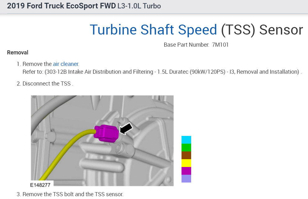

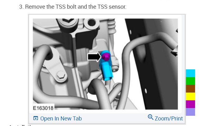

So, what happens is the turbine speed sensor can be off a little and it won't trigger the check engine light or leave a code, it just keeps the computer guessing which causes the shifting problems. Here is the location of the sensor so you can check it out and replace it. Check out the diagrams (below). Please let us know what happens.
Aug 11, 2022 at 10:26 AM

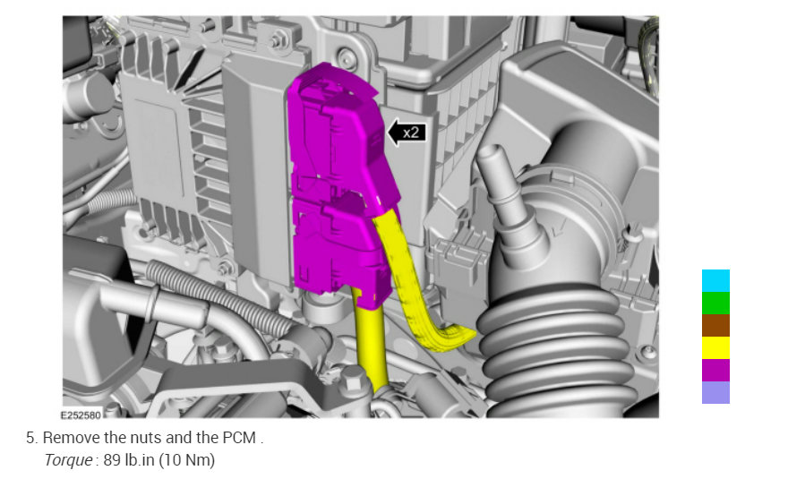

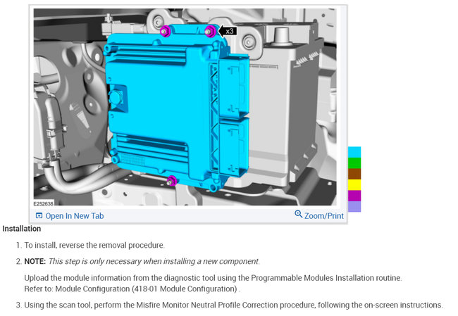

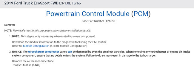

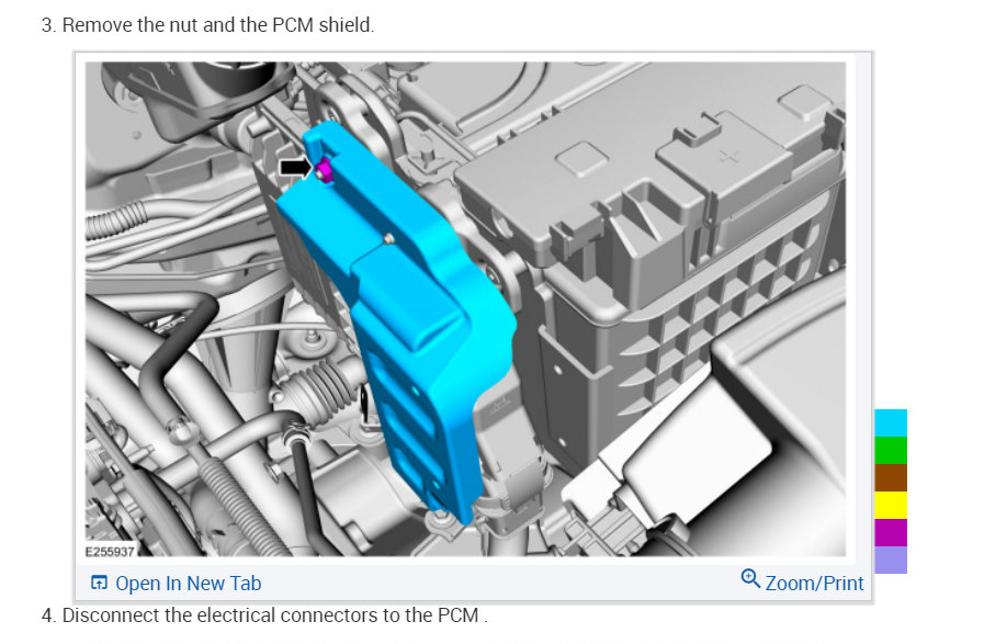

Here is how you can change the PCM out and find one by searching Google or Ebay. check out the images below to see how. Thanks for getting back to me, let me know what happens.
