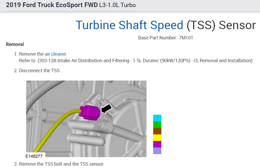

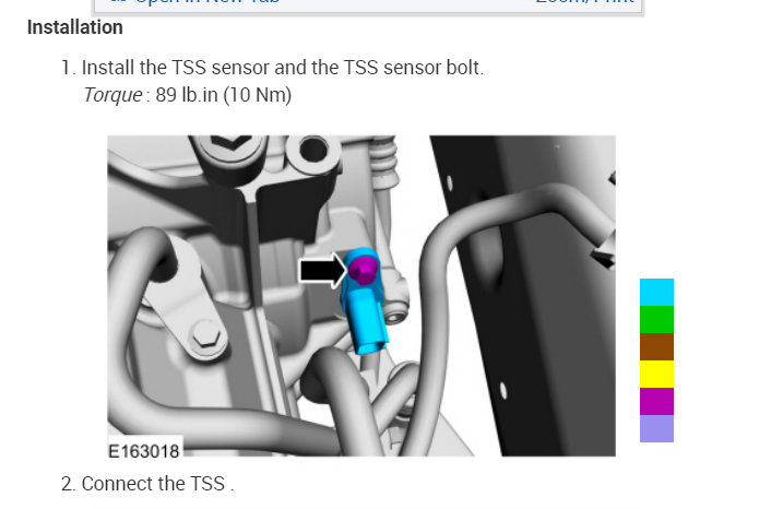

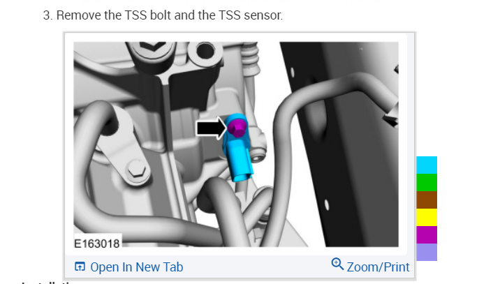

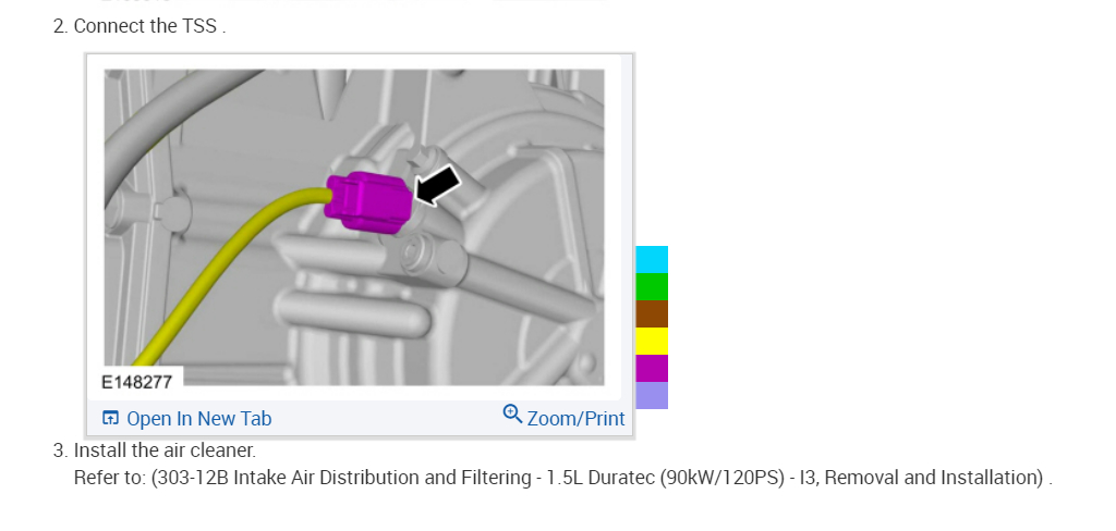

So, what happens is the turbine speed sensor can be off a little and it won't trigger the check engine light or leave a code, it just keeps the computer guessing which causes the shifting problems. Here is the location of the sensor so you can check it out and replace it. Check out the diagrams (below). Please let us know what happens.

Hello Ken, I will look into that with a dealer I think I can trust. Also, when you say off, do you mean that it is not adjusted to its proper position? Is there any risk of me doing that personally?
Aug 12, 2022 at 2:56 AM
  • 55,423 POSTS
Yes, the value of the sensor can change but not enough to trigger a trouble code, but it will affect the transmission. I am wondering if there is a code though, we should do a CAN scan which is easy. you can get a CAN scanner from Amazon for about $30.00.

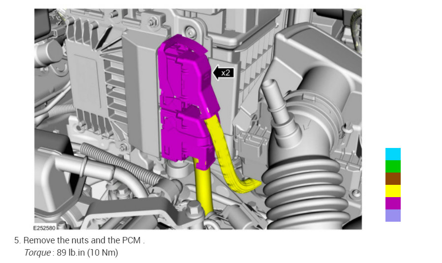

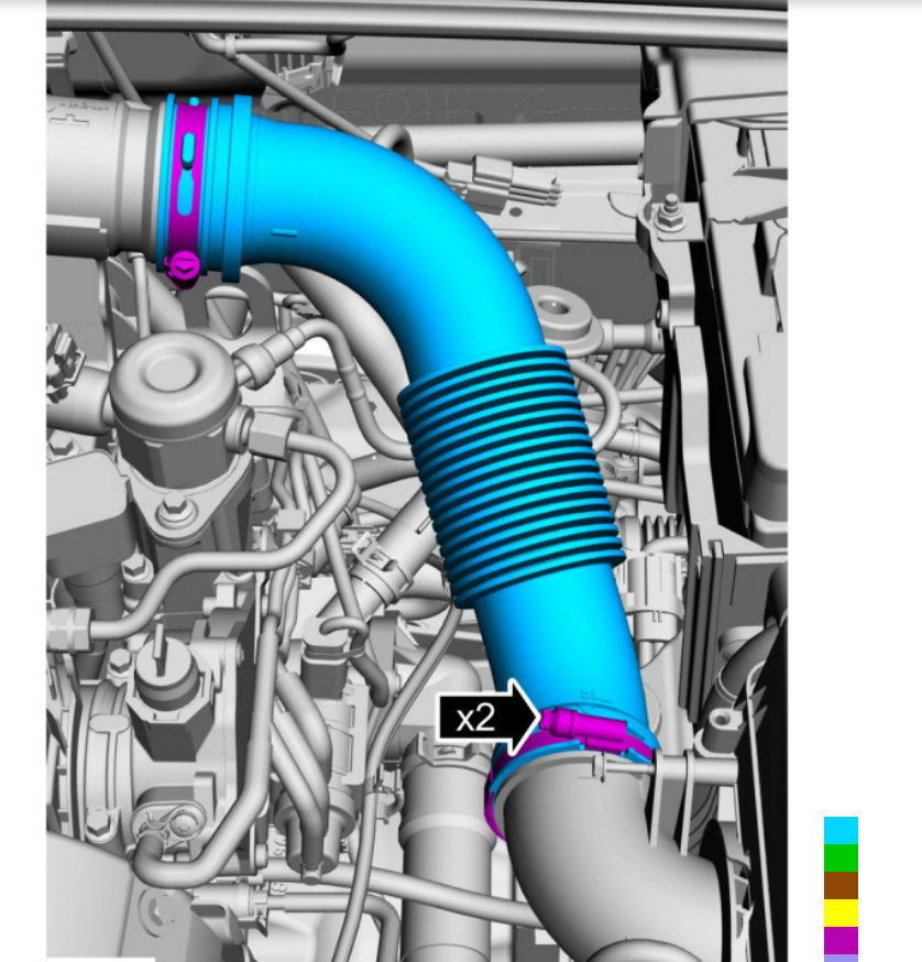

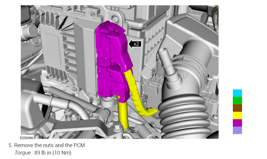

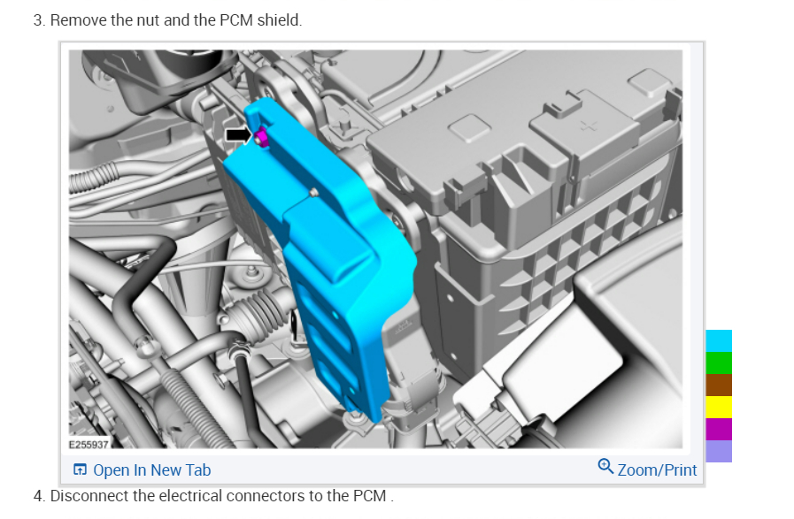

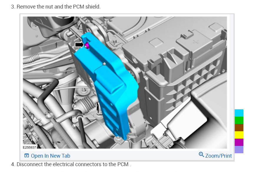

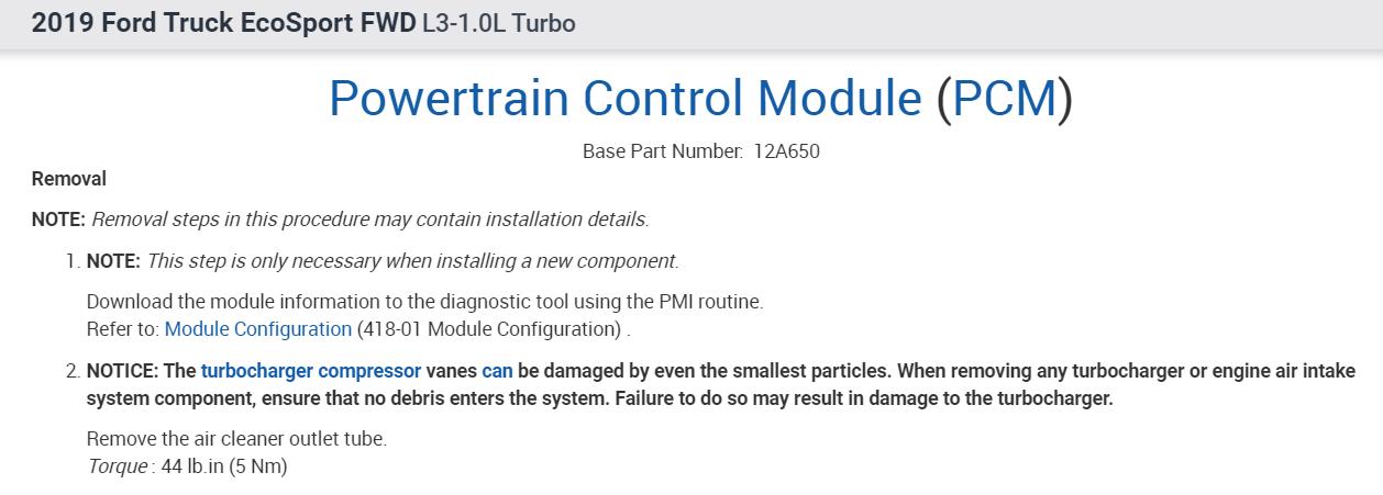

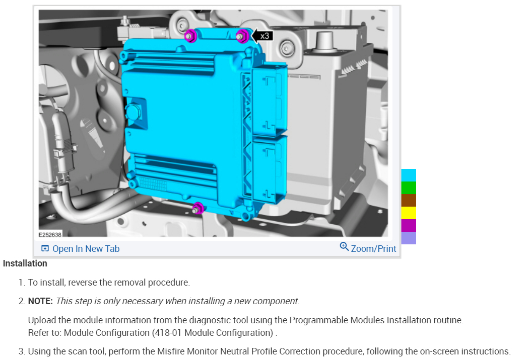

Here is how you can change the PCM out and find one by searching Google or Ebay. check out the images below to see how. Thanks for getting back to me, let me know what happens.
