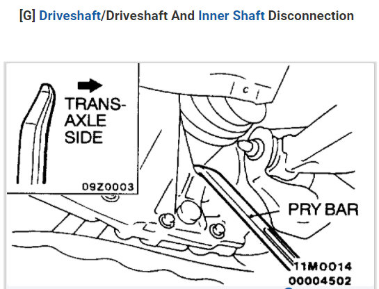

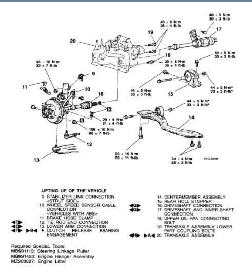

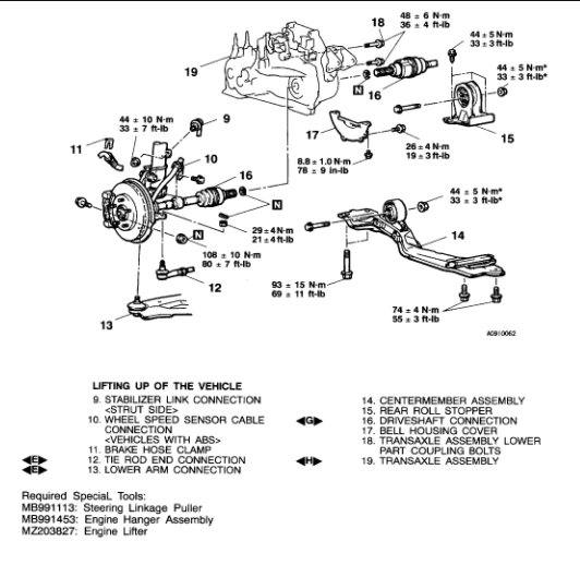

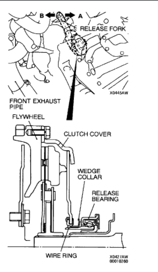

Transmission is not engaging and when it does it comes out of gear . I'm trying to change it but I can't find a used one anywhere. Are there any other interchangeable transmissions for my car?

The manual transmission for your car is interchangeable from 1999-2003. Hope this helps and thanks for using 2CarPros.
Dec 5, 2020 at 11:47 AM
DANNY L
  • 5,648 POSTS

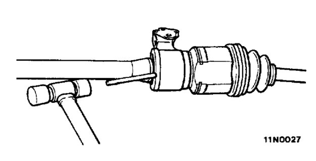

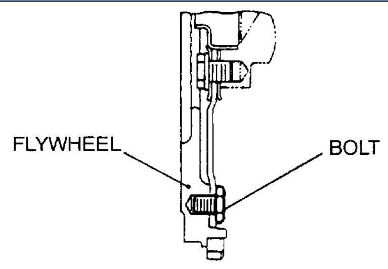

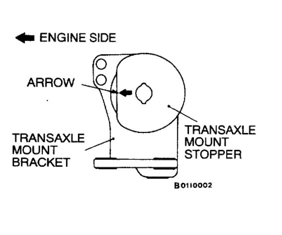

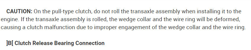

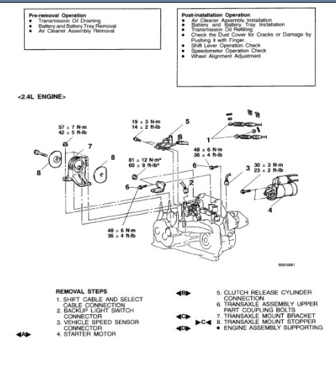

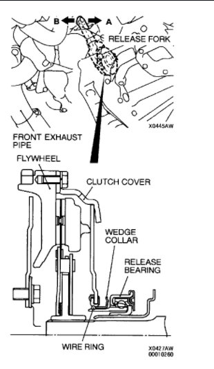

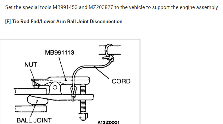

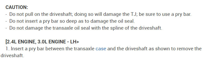

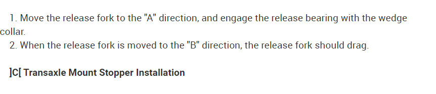

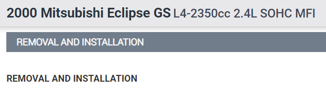

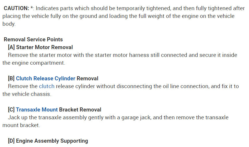

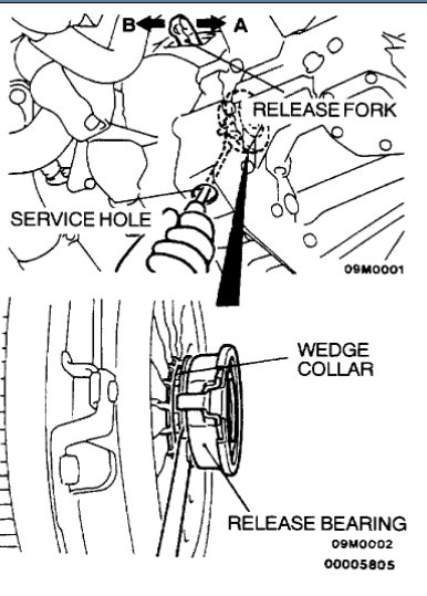

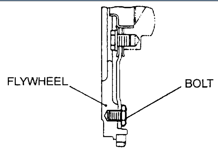

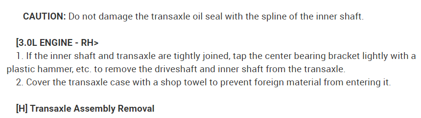

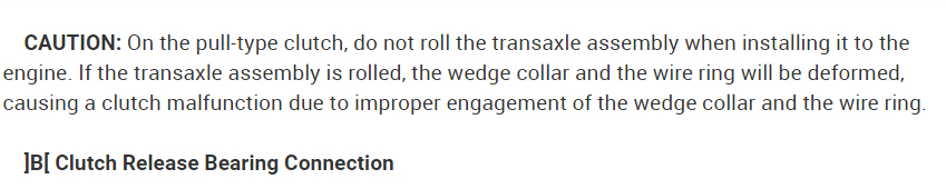

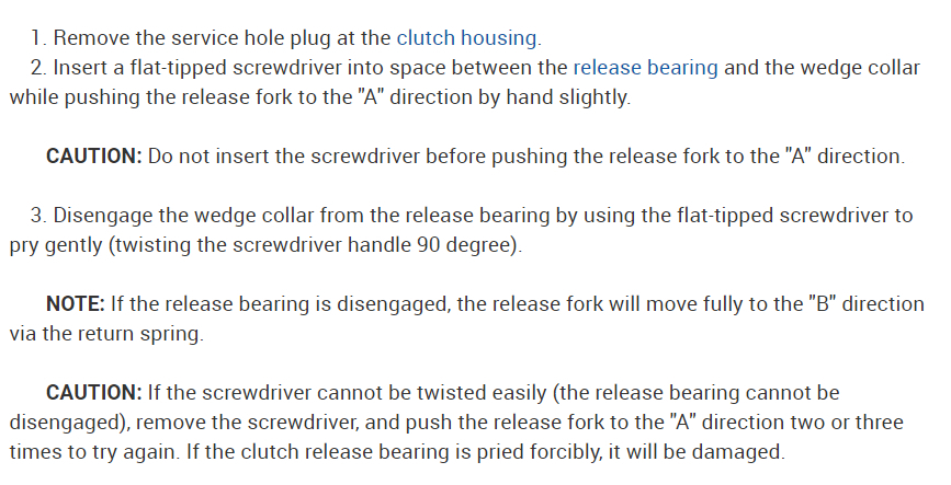

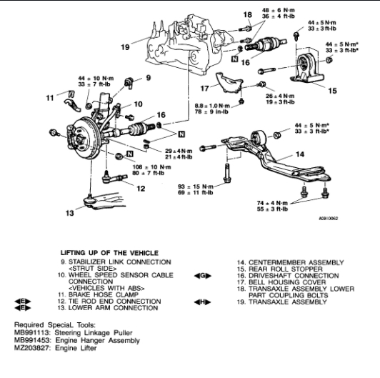

Hello again:

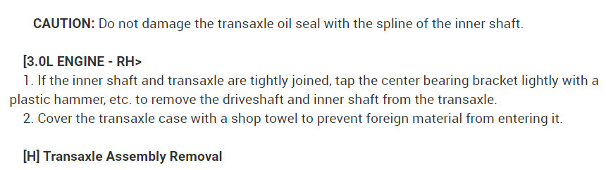

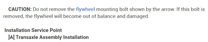

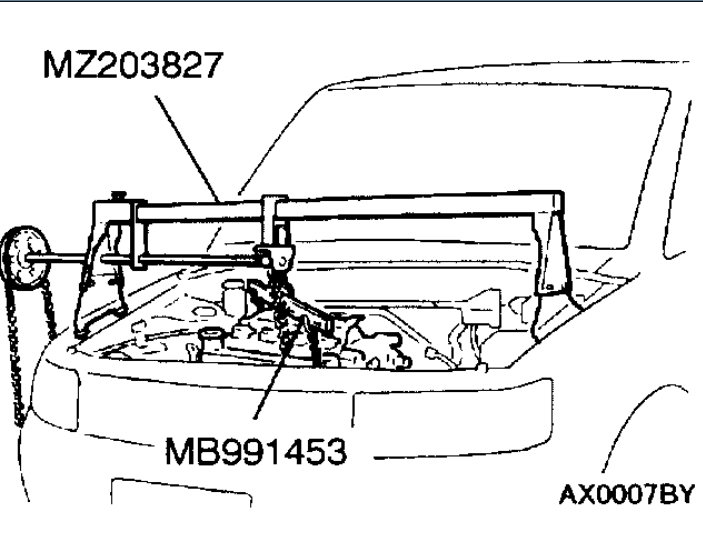

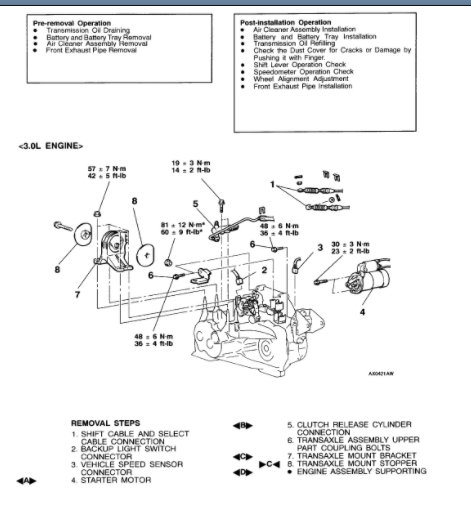

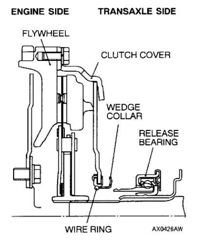

Here is a tutorial showing how to replace a transmission.
https://www.2carpros.com/articles/transmission-replacement-removal-manual
I've attached picture steps below for removal and replacement of the transmission in your car. Hope this helps and thanks again for using 2carPros.
