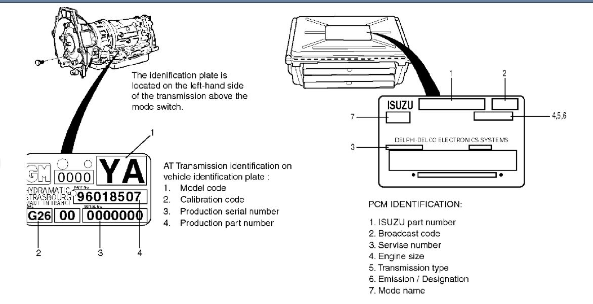

Will a transmission from a 2001 Isuzu Trooper fit in a 2002 Isuzu Axiom? Both 4x4. Trooper has 3.2 motor and the axiom has a 3.5 motor.
Jan 26, 2020 at 1:56 PM
Good afternoon,
The 2001 Trooper 4 wheel drive only lists the 3.5.
The engines are the same.
In order to be sure, I attached a picture of the plate on the side of the transmission. There is a plate on each one. The model number must be the same for it to work.
