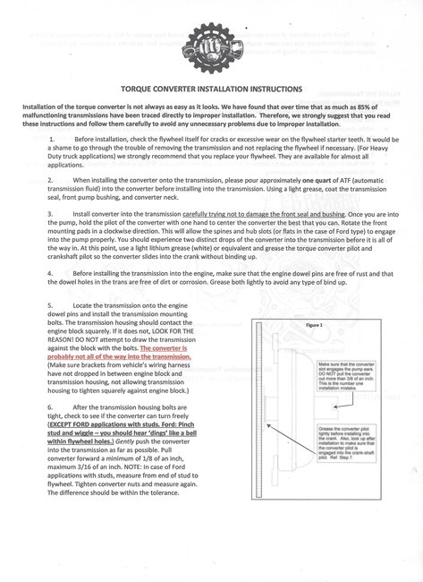

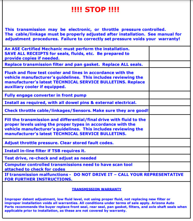

Would you guys happen to have a printable Transmission Installation Checklist that includes everything from flywheel, dowels, filling fluid to cooler and lines? Figure if I'd find a good one anywhere, you'd be the place to have it.
(Preferable a 1 for all type of list)
Thanks a bunch.
(This is what I have so far...)

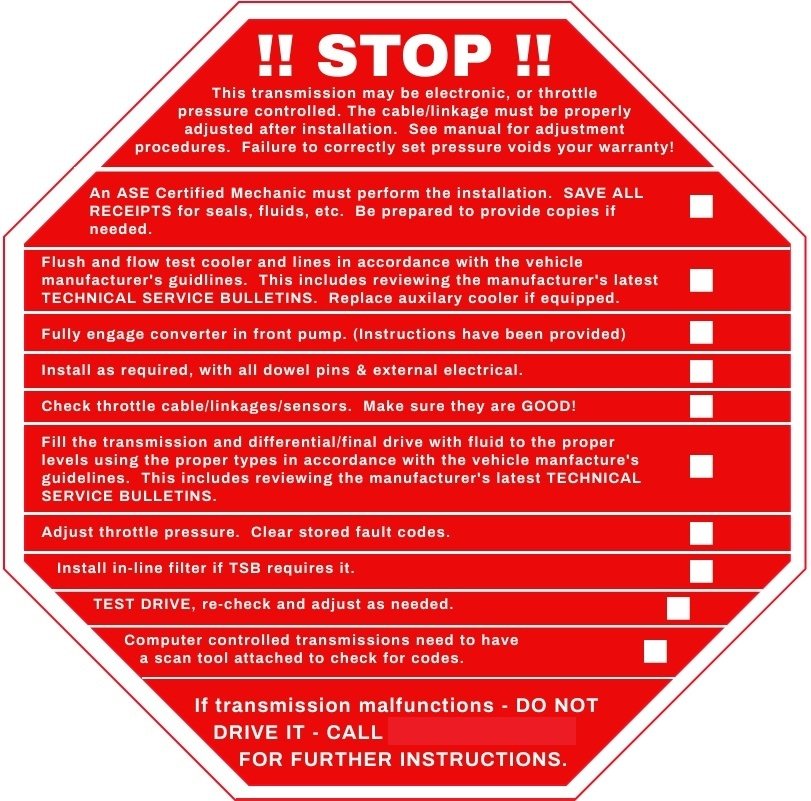

AB AUTOMOTIVEREPAIR TRANSMISSIONS
  • 107 POSTS
This is what I came up with incase anyone else needs a template. :)
Feb 13, 2021 at 3:32 AM

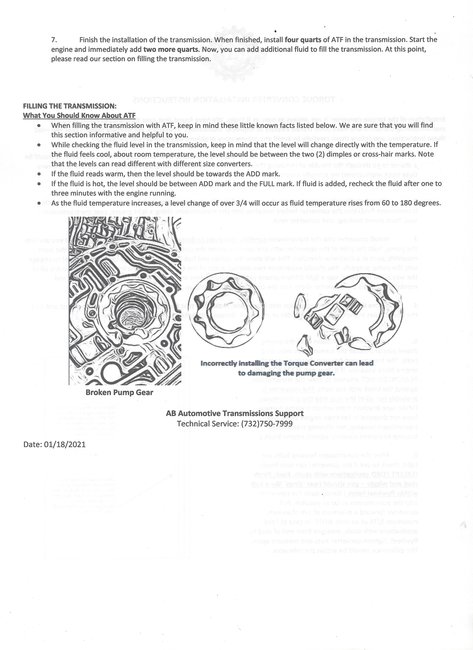

  • 107 POSTS
Danny, that is great for the shop automotive repair side.. did that a couple of years ago, haven't used it once since we are transmission rebuilding owner/operated, but what I need is like a: hold your hand, this is how you install a transmission template... what I have for the converter is pretty detailed now.. still bet they'll mess it up here and there.. SMH
P.S. check out the skilled art... those are actual photos from our customers broken pump photo to sketch... Love that program.

STEVE W.
  • 15,345 POSTS
Don't even need to look, biggest converter issue, not seating it into the pump properly and not shimming it if needed to ensure the ears are seated properly. Result, one trashed pump. Next would be not flushing or replacing the cooler after an internal failure that tossed shrapnel around, that one applies to oil/trans/PS coolers and AC systems equally though.
  • 107 POSTS
We've been attaching the red stop signs to each rebuild and giving them the torque converter instruction sheet, initialing their invoice that they confirm we've given it to them, so far so good.. been working on another project past couple of days, today getting into a 518. Fun times. Thanks for checking in.
