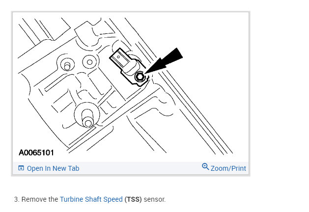

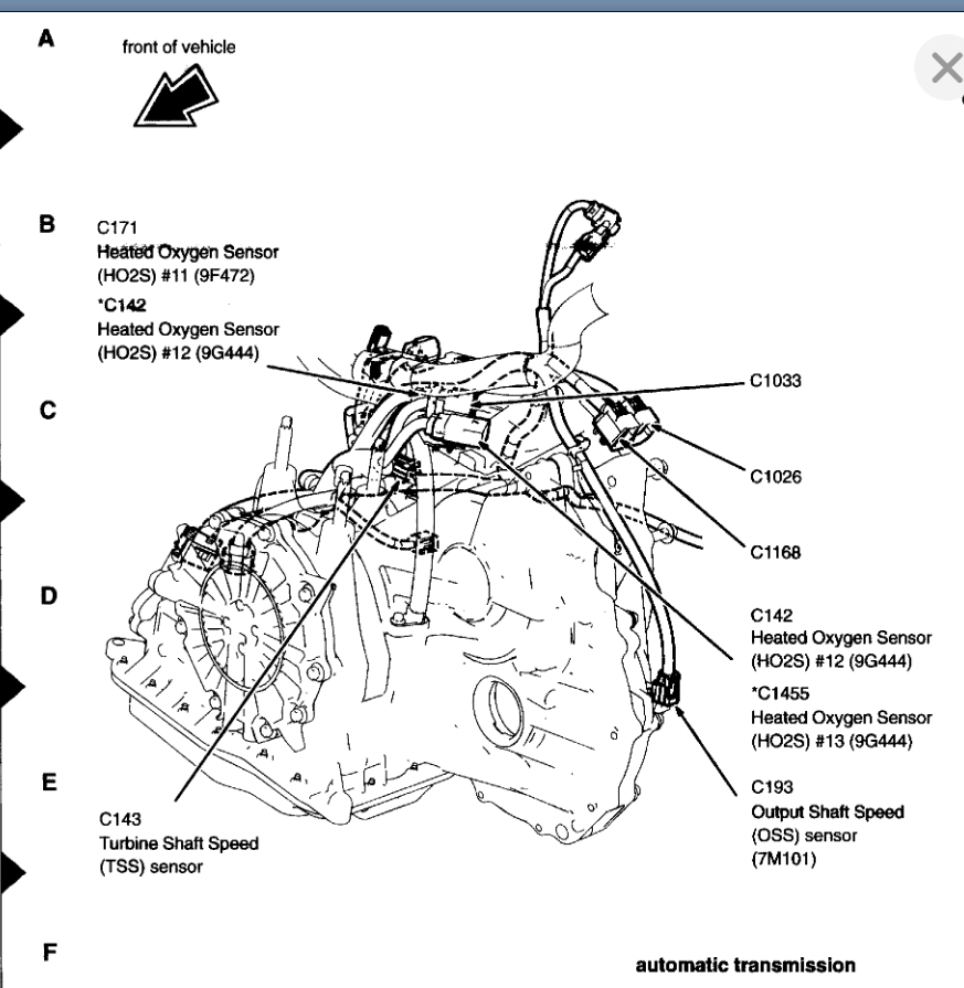

I can't seem to locate the input sensor to replace it.
Aug 20, 2019 at 8:09 AM
Hi Mary,
This sensor is called the turbine speed sensor. I attached a location view but it looks to be on the top in the middle of the unit.
Let me know if you have other questions. Thanks
Aug 20, 2019 at 8:37 AM
MARY CATTERLIN
Thank you for your help! I was able to find and replace it once I removed the air intake hose, air filter housing, battery, and battery tray.

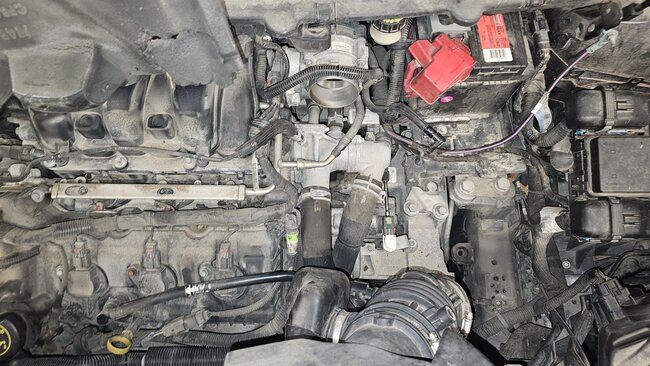

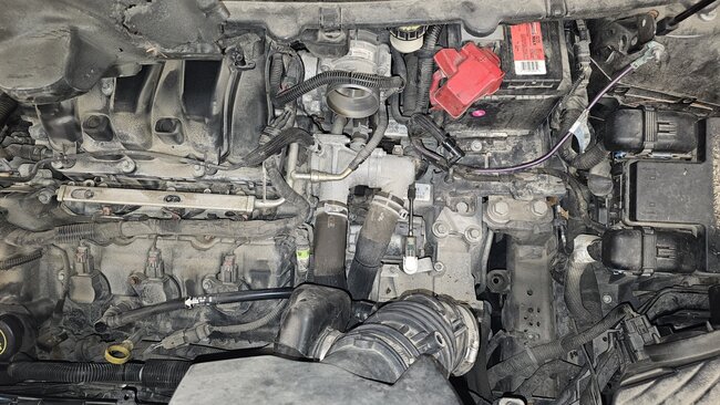

Where are these located on a 2015 ford edge please?
Aug 19, 2025 at 1:01 AM
  • 55,711 POSTS
Sure, if you look at the diagrams above it shows the sensor location.
Aug 19, 2025 at 1:08 AM
PROWLER777
  • 11 POSTS
Hey Ken, can you circle that out something for me? This is an overhead Pic of my ford edge engine. i need to find a reference point to find the sensors but it looks nothing like the Pic to me
Aug 19, 2025 at 6:47 AM
  • 55,711 POSTS
Sorry, this post is for a 2005 ford focus, can you please start a new thread? Please post your new question here, you must be logged in.
