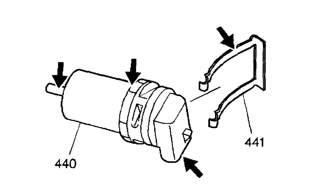

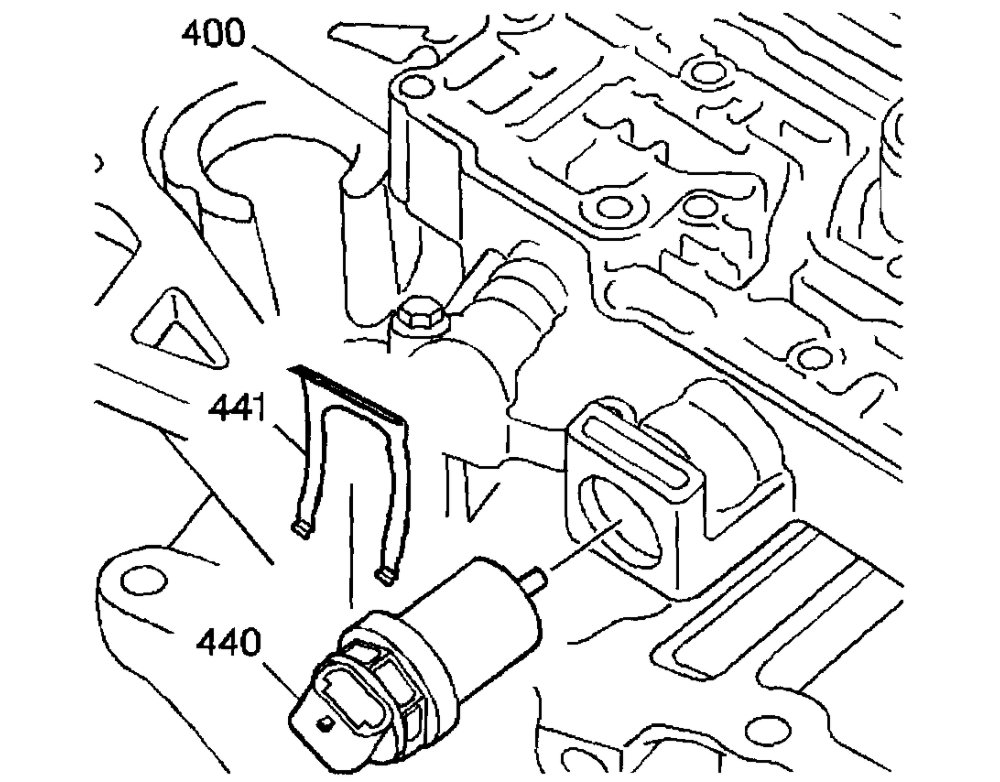

Input Speed Sensor Replacement
Removal Procedure
1. Remove the case side cover.
2. Disconnect the input speed sensor electrical connector.
3. Remove the input speed sensor retaining clip (441).
4. Remove the input speed sensor (440).
5. Inspect the input speed sensor (440) for the following conditions:
^ Damaged or missing magnet
^ Damaged housing
^ Bent or missing electrical terminals
^ Damaged speed sensor clip (441)

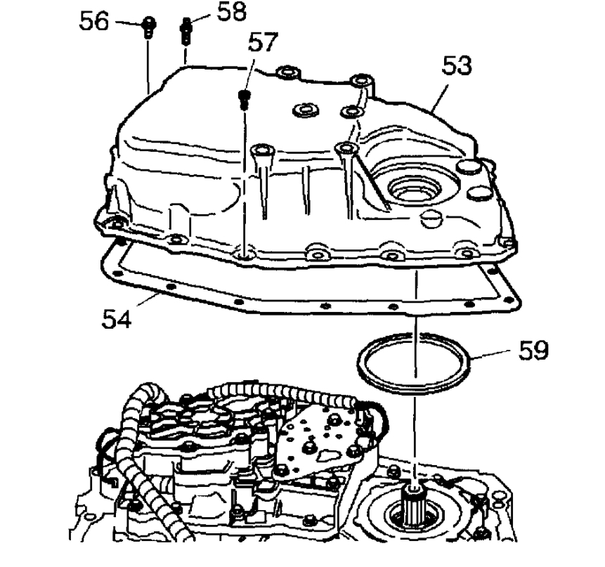

Case Side Cover Replacement
Removal Procedure
1. Disconnect the negative battery cable.
2. Remove the air cleaner intake duct.
3. Remove the engine mount struts.
4. Install the engine support fixture.
5. Disconnect the transmission wiring harness connector.
6. Raise and support the vehicle.
7. Remove the left drive axle from the transaxle.
8. Secure the drive axle to the steering knuckle/strut.
Caution: Failure to disconnect the intermediate shaft from the rack and pinion stub shaft result in damage to the steering gear and/or damage to the intermediate shaft. This damage may cause loss of steering control which could result in personal injury.
9. Remove the intermediate steering shaft pinch bolt and the shaft from the steering gear.
10. Remove the 3-way catalytic converter pipe from right exhaust manifold.
11. Support the right and the left side of the frame with jackstands.
12. Remove the Transaxle mount.
13. Loosen the engine mount lower nuts.
14. Loosen the right side frame bolts and remove the left side frame bolts.
15. Adjust the jackstand to the lower left side of the frame.
16. Position the drain pan under the transaxle.

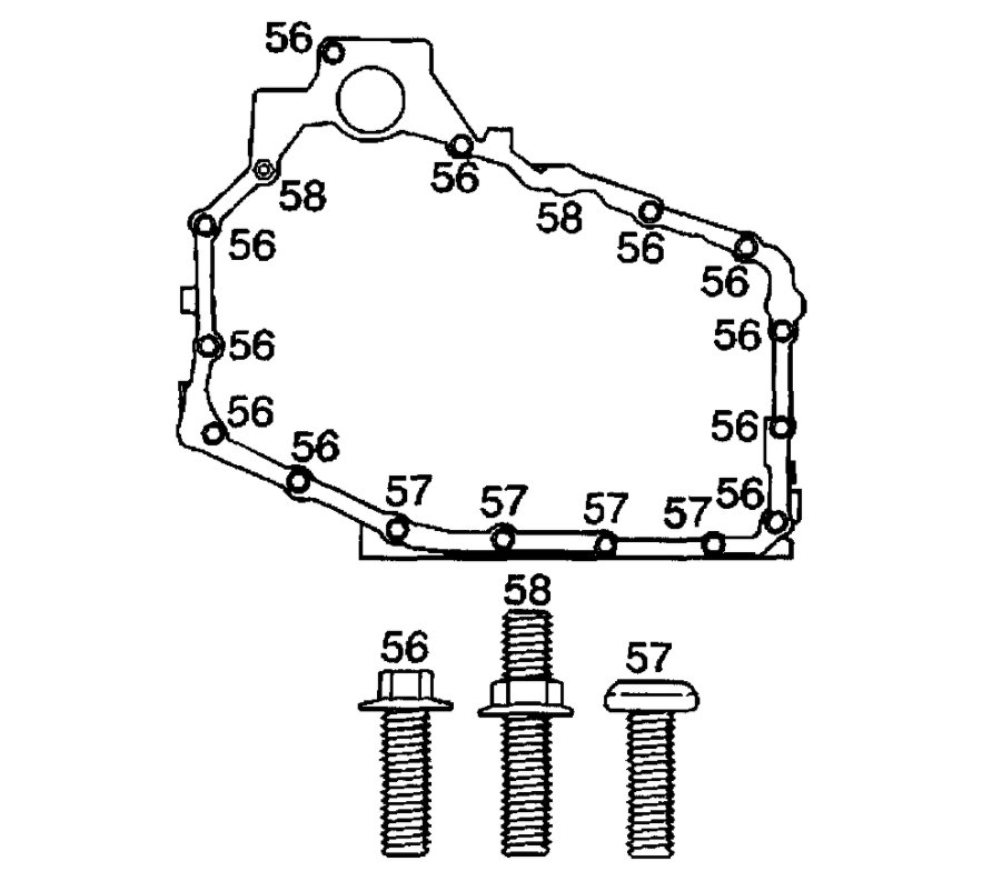

17. Remove the case side cover bolts (56-58).
18. Remove the case side cover pan (53).
19. Remove the case side cover gasket (54).
20. Clean the case.
21. Clean the side cover gasket mating surfaces.
