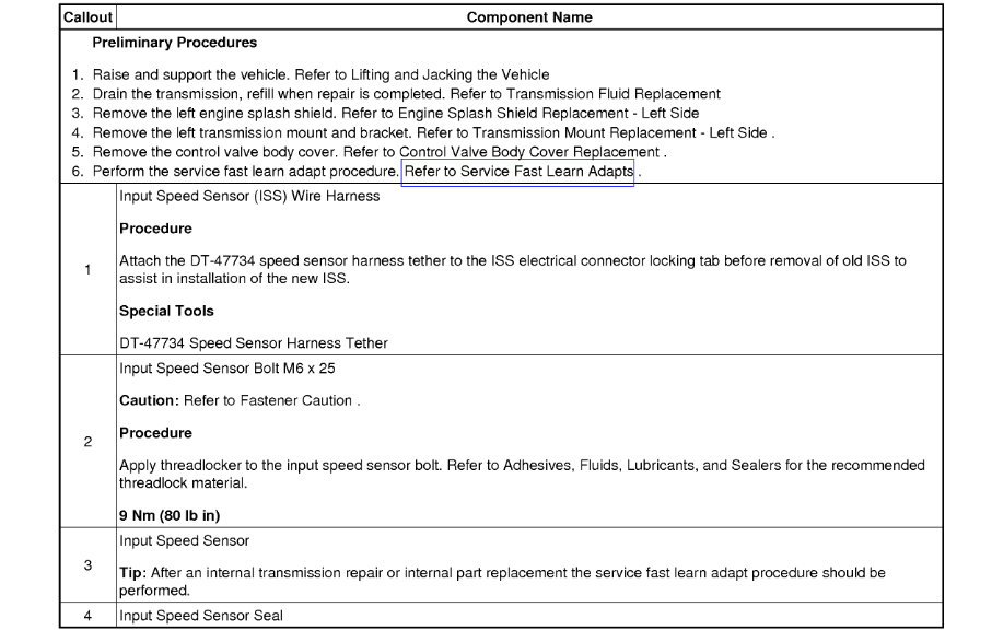

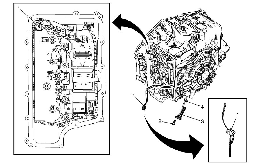

Found the sensor on another transmission listed for your car.
procedure and picture attached.
