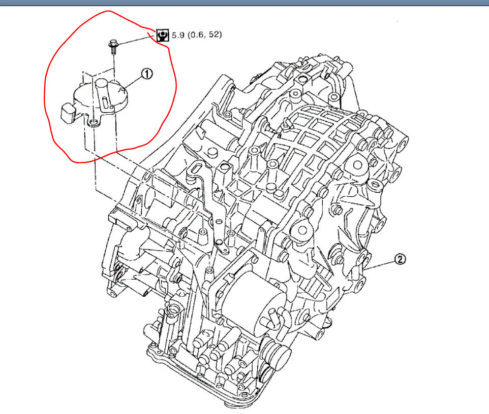

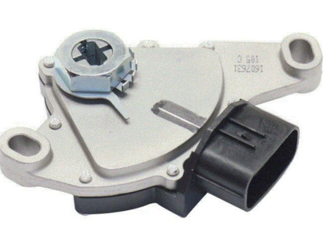

If you lost the gear indicators, it sounds like there is an issue with the transmission range sensor. This electrical component is located on the transmission and usually is either attached to where the shift linkage is located or in the transmission
Check to see if you can locate it. I attached a picture of one below, so you get a general idea of what you are looking for. I believe your vehicle is very similar to our Nissan Sentra, but I can't be 100% sure. Pic 1 shows the sensor and pic 2 shows the location on a Nissan Sentra.
Let me know if this helps.
