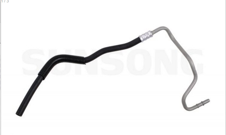

There is a hose connected on top of the transmission filter that burned out but I cannot seem to find where the other burned piece is. The burnt hose leaks transmission oil. How can I find the other end of it? Want to replace but do not know where it ends.

I am assuming you have an auxiliary oil cooler look in front of radiator or on side in front of radiator it may even be under car pictured is an auxiliary transmission cooler hose. They have all of them at rock auto.
