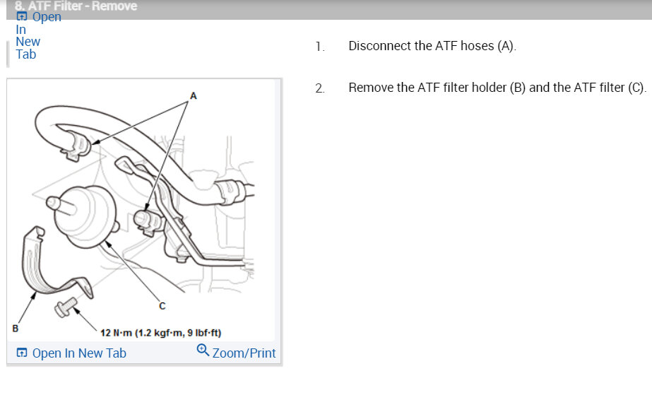

You would need to weigh the costs plus I think the extended warranty you must have it a length of time before you can use it. I would run the codes to see if any are stored.

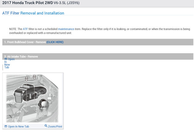

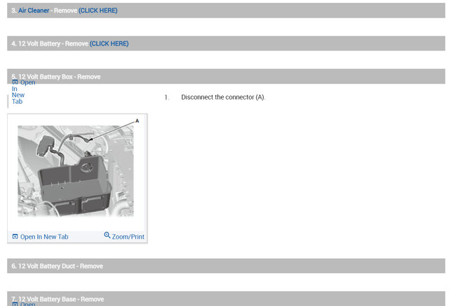

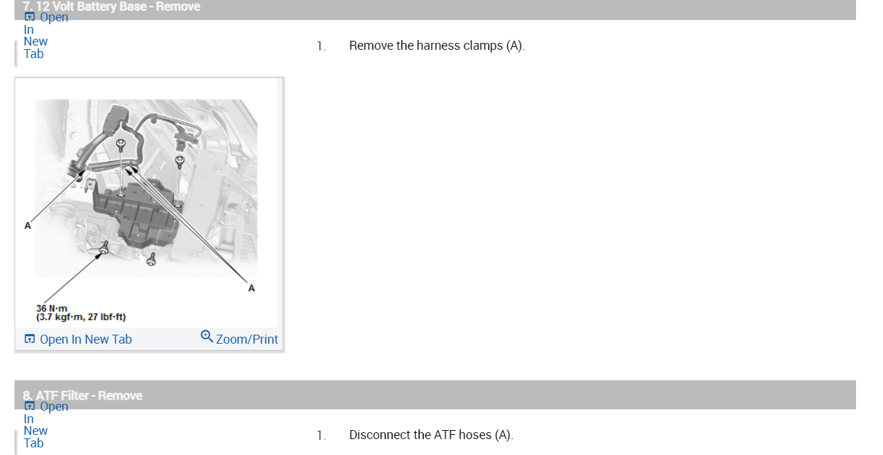

This vehicle has an external transmission fluid filter which I would change.
Use genuine Honda Automatic Transmission Fluid (Type 3).
Note: Using the wrong type of ATF can affect shift quality.
Here is how the job is done: Check out the images (below). Let us know what happens and please upload pictures or videos of the problem so we can see what's going on.
