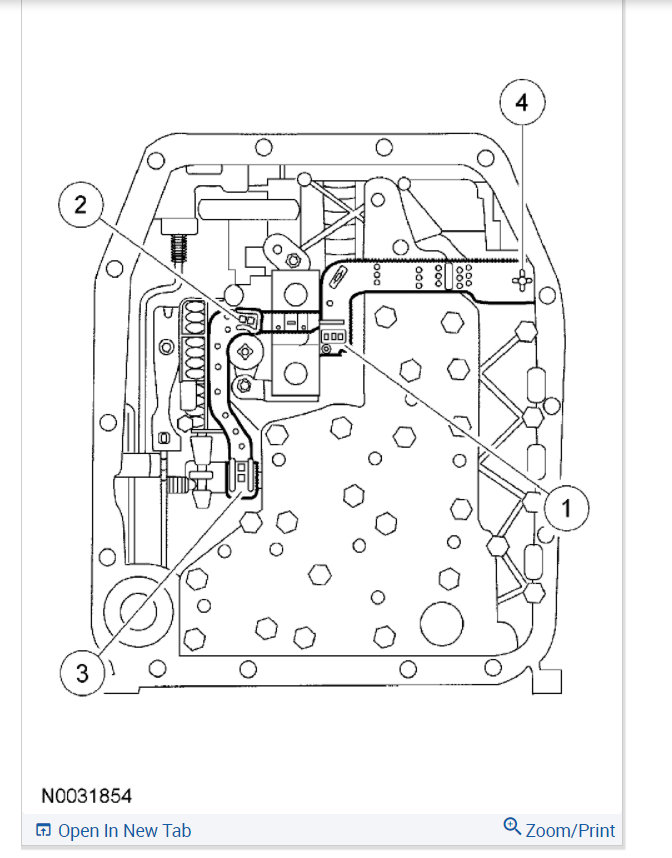

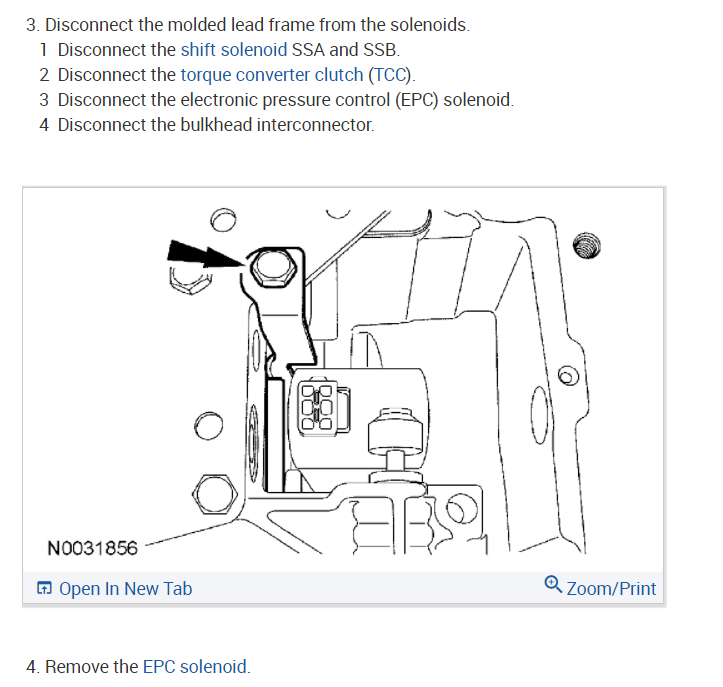

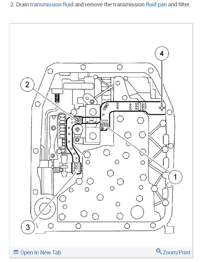

The vehicle listed above with original transmission no oil change, level is good, no codes. Problem is: Put on Drive press the gas first gear start moving very slowly stay the same even if you press more the pedal it takes time to change gear. second gear normal operation, third gear normal operation, reverse is normal operation.
What could be the problem?

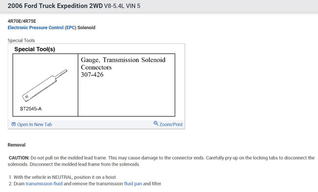

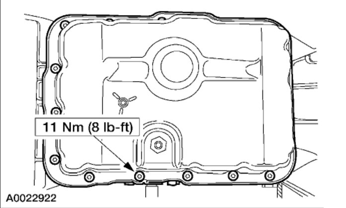

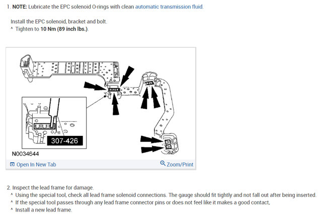

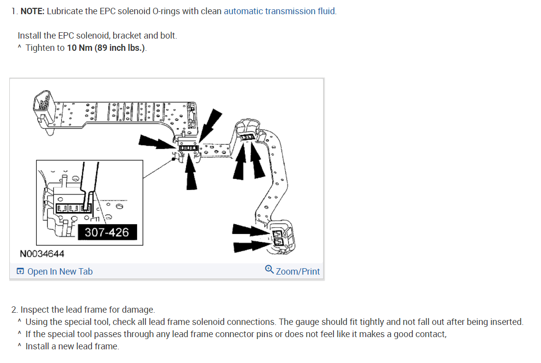

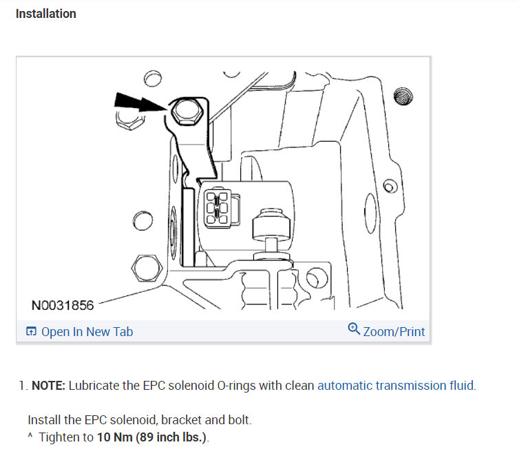

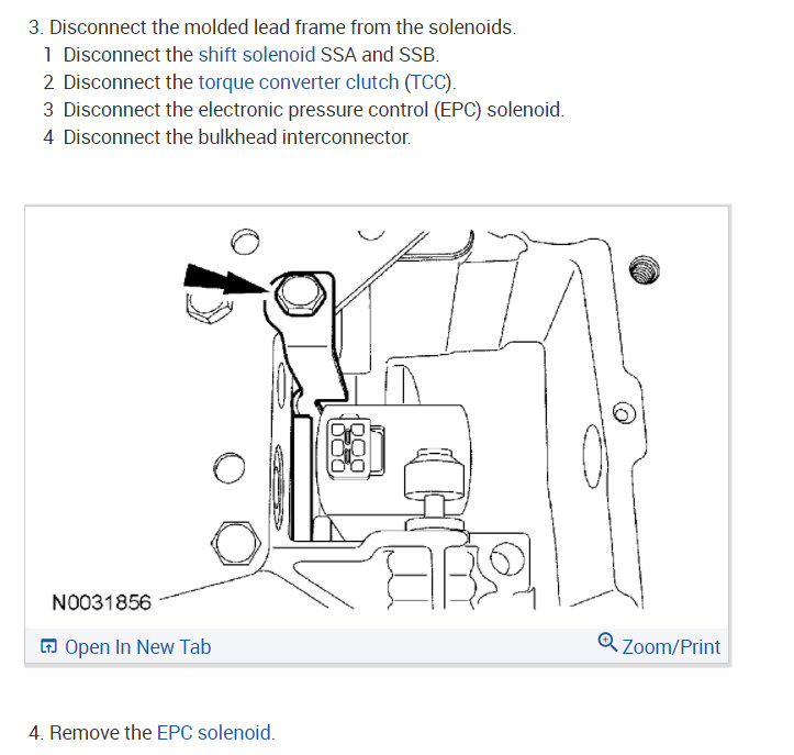

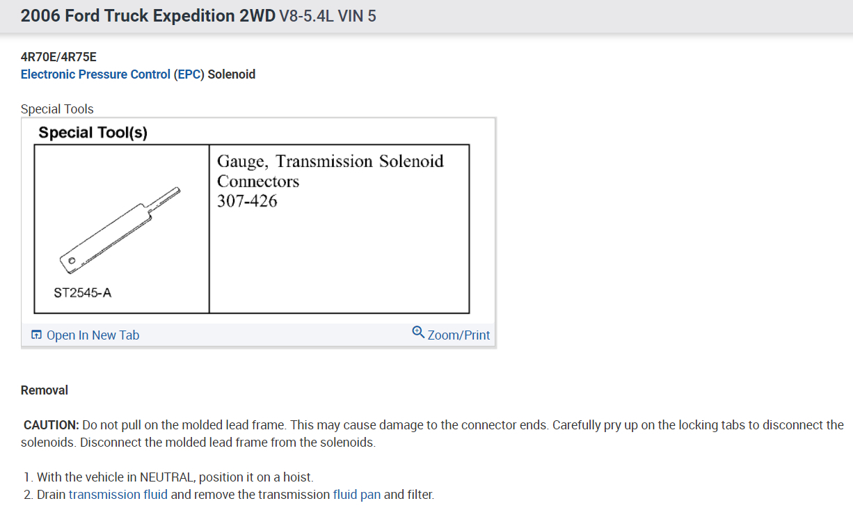

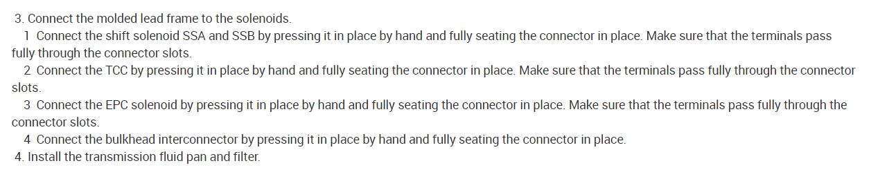

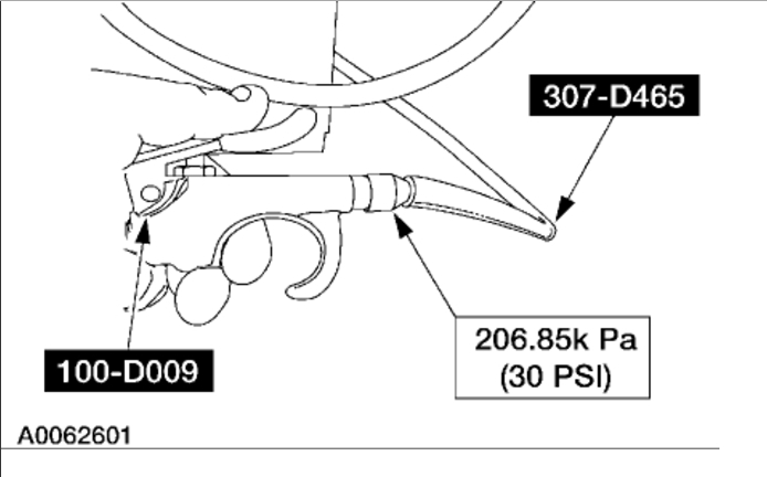

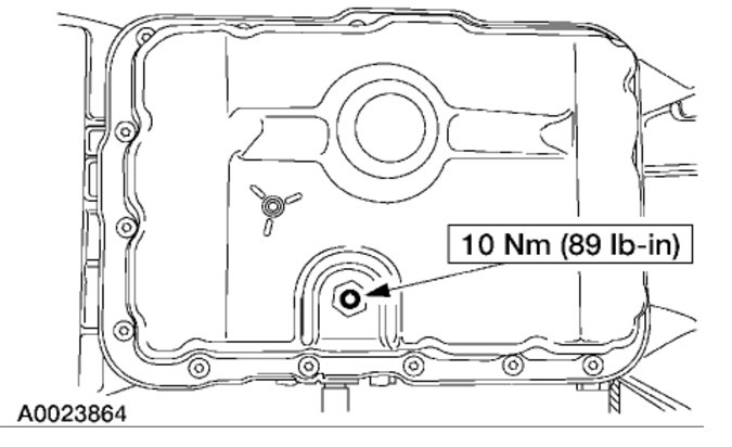

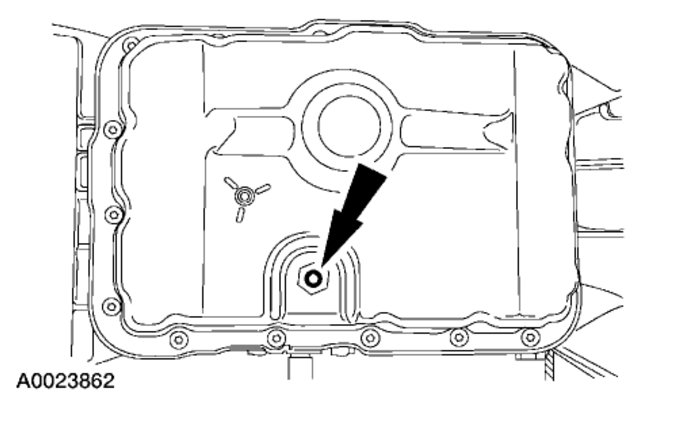

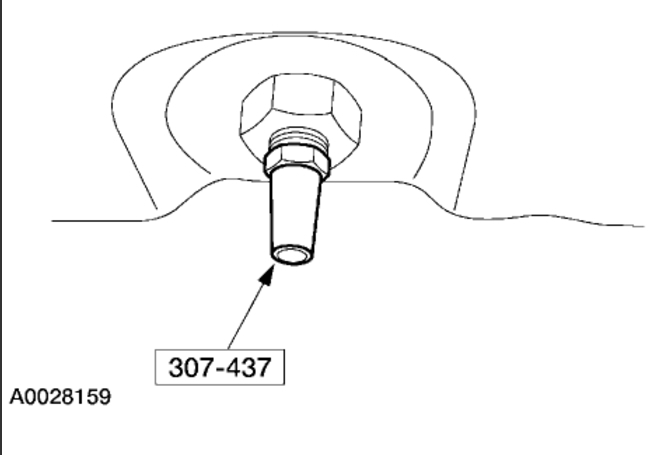

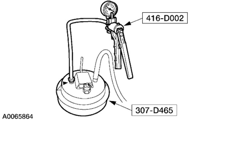

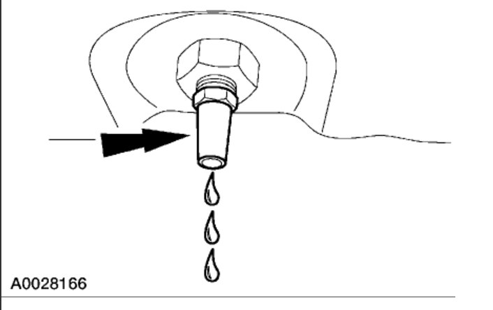

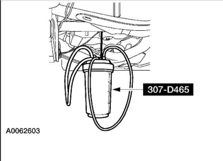

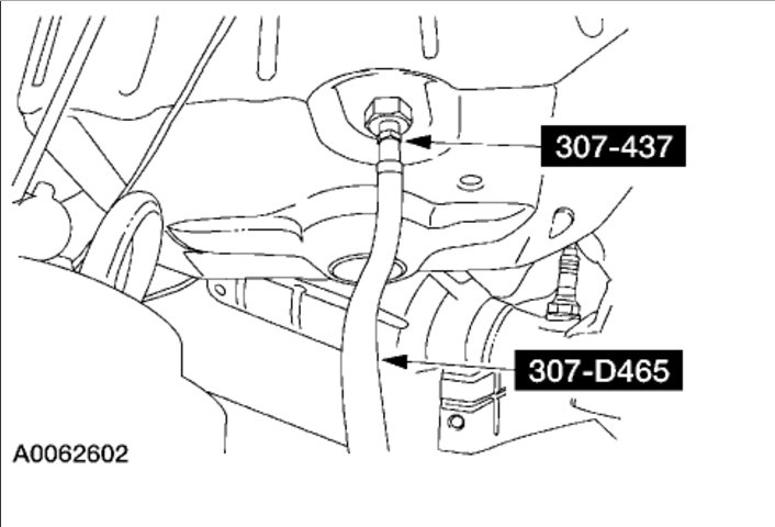

This happens when the fluid pressure sensor goes out you should change the fluid as well. here are guides and diagrams below to show you how to make the repair:
and
