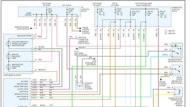

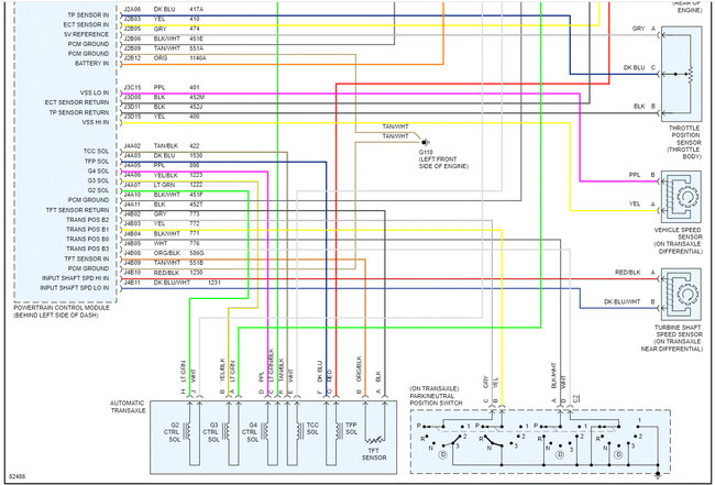

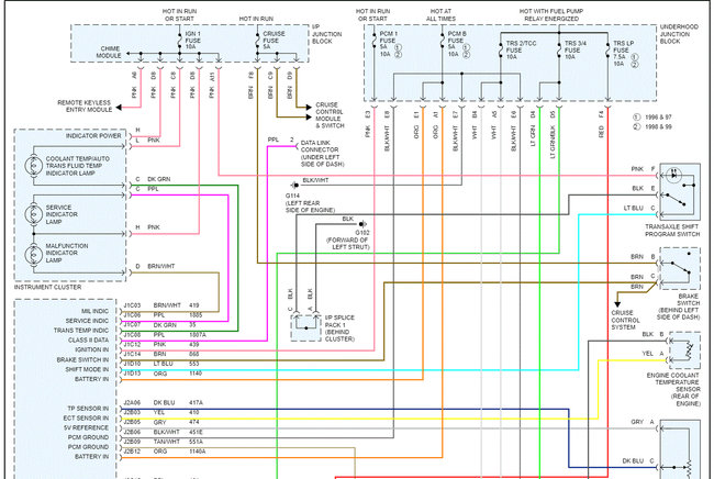

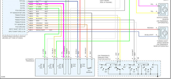

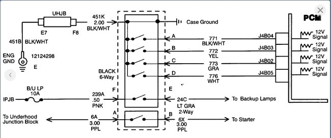

I attached the wiring schematic for the transmission circuit. I had to cut the pic in half to make it readable for you, but I did overlap them so you can follow from one to the next.
Take a look through them and let me know if you notice any variations from what you have done. Also, let me know if the new wiring harness was a direct fit component.

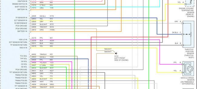

Well, I can't read diagrams well and three of the wires were the same color so I'm not sure what to do from here.
Mar 23, 2022 at 12:02 PM
  • 110,251 POSTS
I will break the schematic into three. See if that helps. Also, if the wiring colors match, confirm they are going to the correct places.

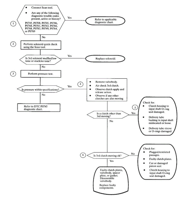

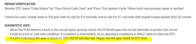

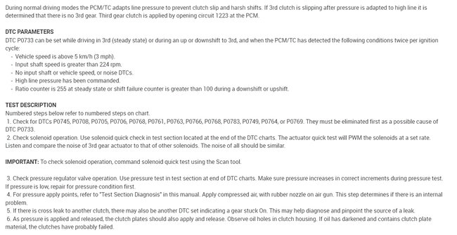

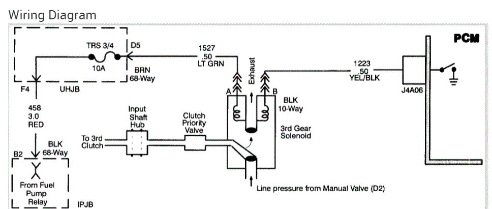

Is the P0733 the only code left? I ask because this can be the result of the 4th gear solenoid. See the last pic below
The pics below are the diagnostics for the P0733. Let me know if there are any other codes set. P0734 is specific to a hydraulic condition with the 4th gear clutch so that one is important. However, there are several others listed in the pics below.

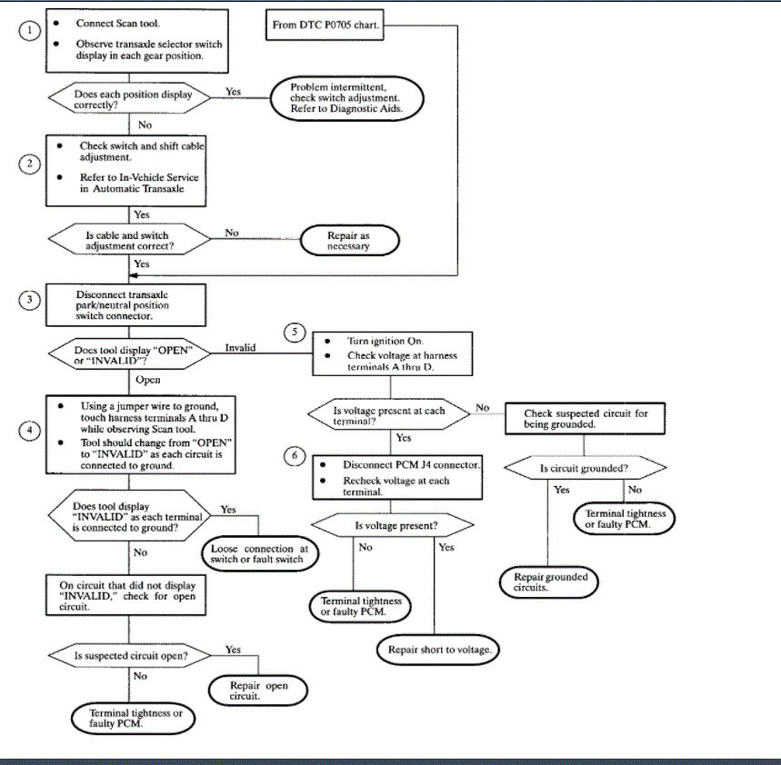

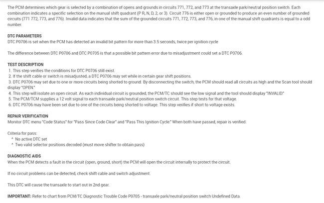

Okay,
The aforementioned diagnostics identify several codes that need to be addressed prior to focusing on a P0733. The only one you have that is present is the P0706, so let's see if we can get to the bottom of that code. It may be the cause of the 733 and the problems.
I attached the directions below which seem to focus specifically on the transmission range sensor. Take a look through them and let me know if you are comfortable performing the tests. I have a feeling this is where the problem is originating.
