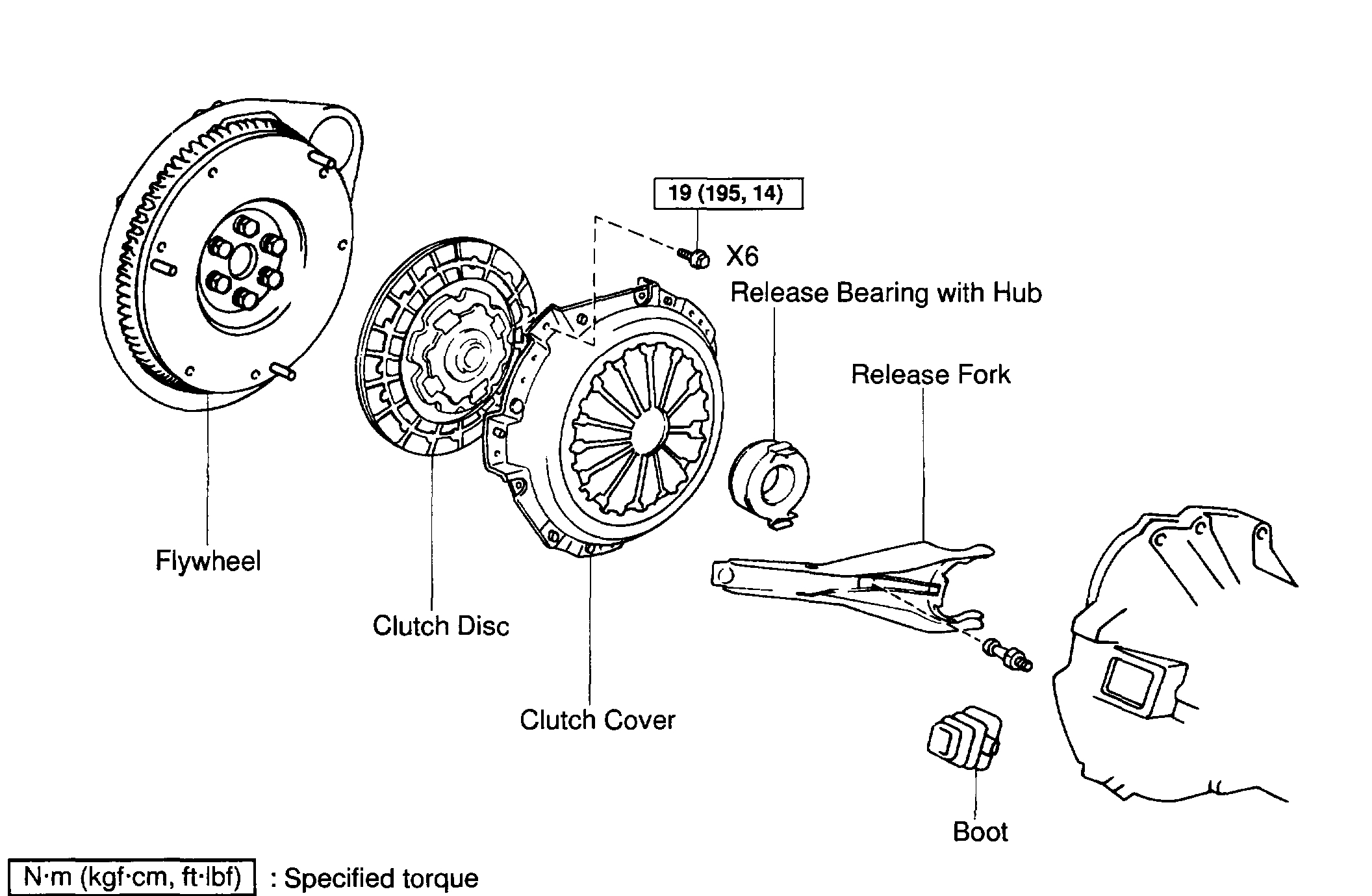

Hello, i make a clutch change to this car and now it doesn't want to apply. I put every thing where it goes. I didn't make any changes to the transmission.
I center the clutch with the right alignment tool, it came with the clutch kit.
What you think it happen?

Here are the directions for removal and replacement of the clutch. The first picture is an exploded view of the system.
___________________________
COMPONENTS
REMOVAL
pic 1
1. REMOVE TRANSAXLE FROM ENGINE

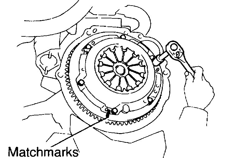

2. REMOVE CLUTCH COVER AND DISC
a. Place matchmarks on the flywheel and clutch cover.
b. Loosen each set bolt one turn at a time until spring tension is released.
c. Remove the set bolts, and pull off the clutch cover with the clutch disc.
NOTICE: Do not drop the clutch disc.
pic 2

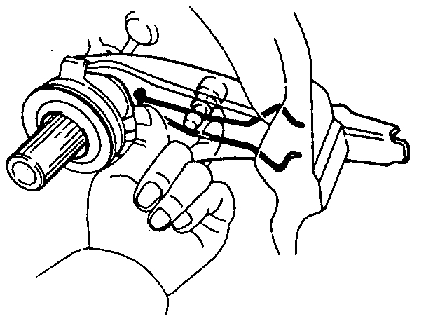

3. REMOVE RELEASE BEARING AND FORK FROM TRANSAXLE
Remove the release bearing together with the fork and then separate them.

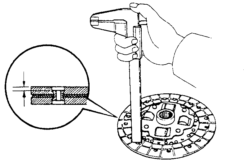

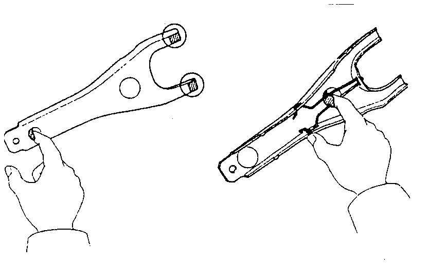

1. INSPECT CLUTCH DISC FOR WEAR OR DAMAGE
Using calipers, measure the rivet head depth.
Minimum rivet depth: 0.3 mm (0.012 inch)
If necessary, replace the clutch disc.

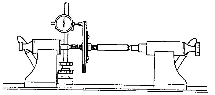

2. INSPECT CLUTCH DISC RUNOUT
Using a dial indicator, check the disc runout.
Maximum runout: 0.8 mm (0.031 inch)

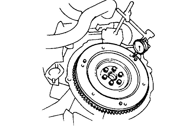

3. INSPECT FLYWHEEL RUNOUT
Using a dial indicator, check the flywheel runout.
Maximum runout: 0.1 mm (0.004 inch)
If necessary, replace the flywheel.

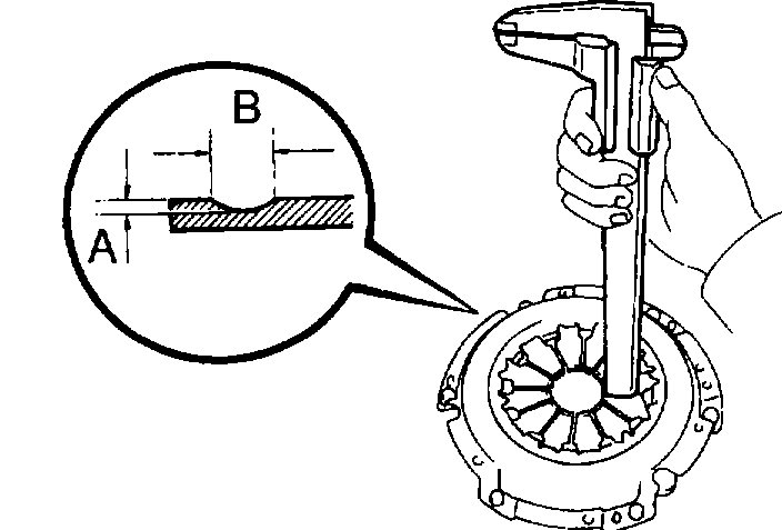

4. INSPECT DIAPHRAGM SPRING FOR WEAR
Using calipers, measure the diaphragm spring for depth and width of wear.
Maximum depth: A: 0.6 mm (0.024 inch)
Maximum width: B: 5.0 mm (0.197 inch)
If necessary, replace the clutch cover.

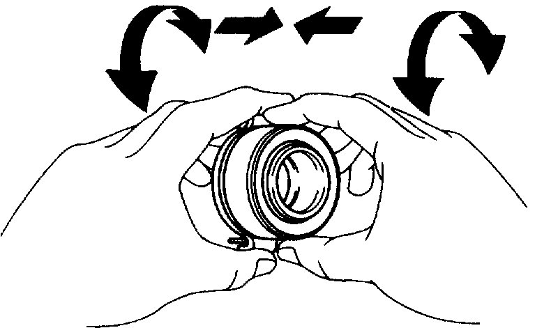

5. INSPECT RELEASE BEARING
Turn the bearing by hand while applying force in the axial direction.
HINT: The bearing is permanently lubricated and requires no cleaning or lubrication.
If necessary, replace the release bearing.

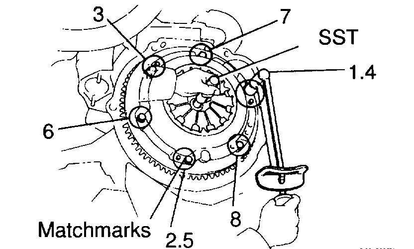

1. INSTALL CLUTCH DISC AND CLUTCH COVER ON FLYWHEEL
pic 8

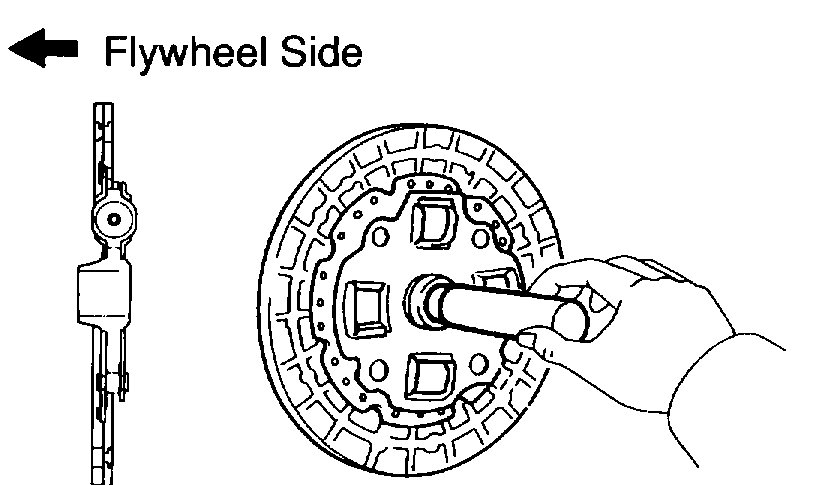

a. Insert Special Service Tool (SST) in the clutch disc, and then set them.
SST 09301-00210
pic 9
b. Align the matchmark on the clutch cover with the one on the flywheel.
c. Torque the bolts on the clutch cover in the order shown.
Torque: 19 Nm (195 kgf-cm, 14 ft. lbs.)
HINT: Temporarily tighten the No.1 and No.2 bolts.

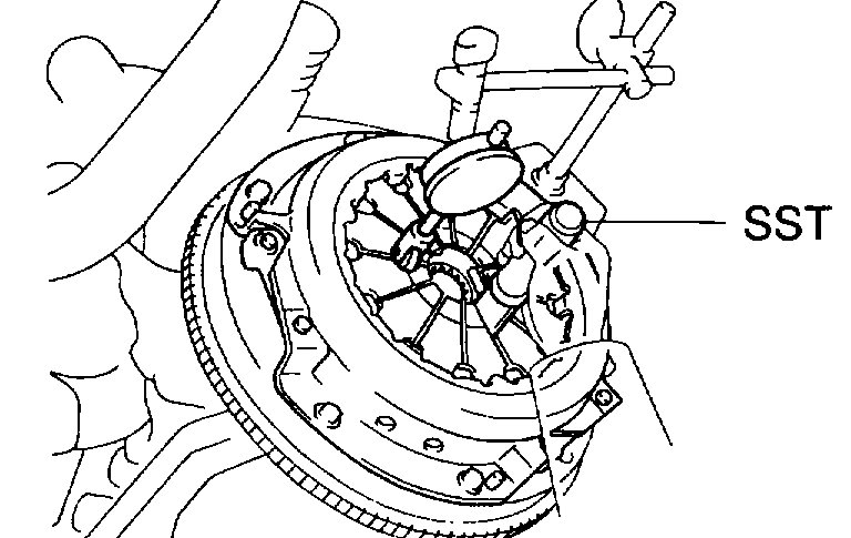

2. CHECK DIAPHRAGM SPRING TIP ALIGNMENT
Using a dial indicator with roller instrument, check the diaphragm spring tip alignment.
Maximum non-alignment: 0.5 mm (0.020 inch)
If alignment is not as specified, using SST, adjust the diaphragm spring tip alignment.
SST 09333-00013

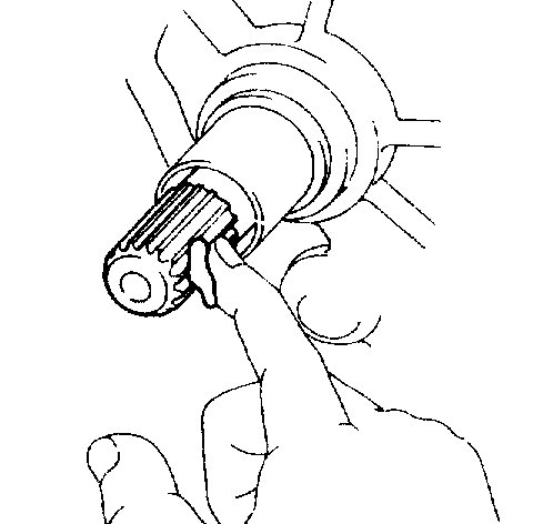

pic 12
b. Apply clutch spline grease.
Clutch disc spline
HINT: Recommended grease part number 08887-01706 (100 g).
4. INSTALL RELEASE BEARING AND FORK TO TRANSAXLE
Install the bearing to the release fork, and then install them to the transaxle.

Jacobandnickolas, thank you very mucho. I did an error. I didn't measure the old clutch with the new one, i need to extend the slave pin to push the fork a little bit more.
I can do it right?

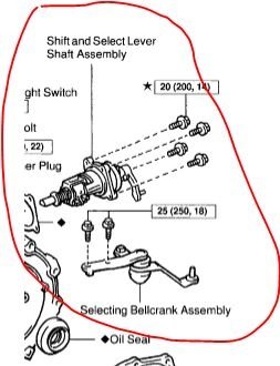

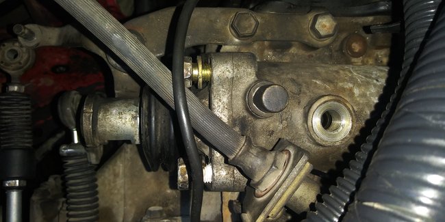

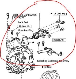

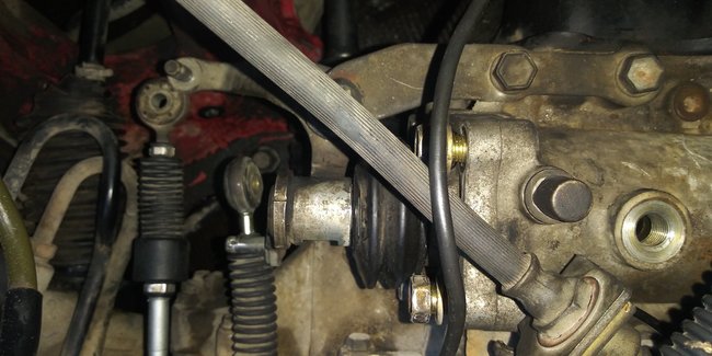

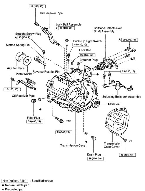

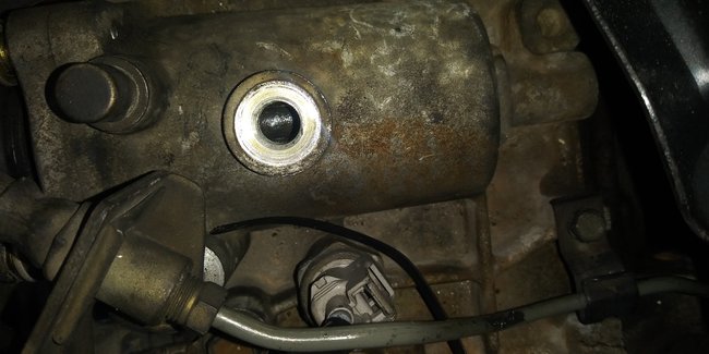

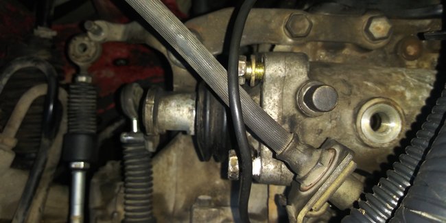

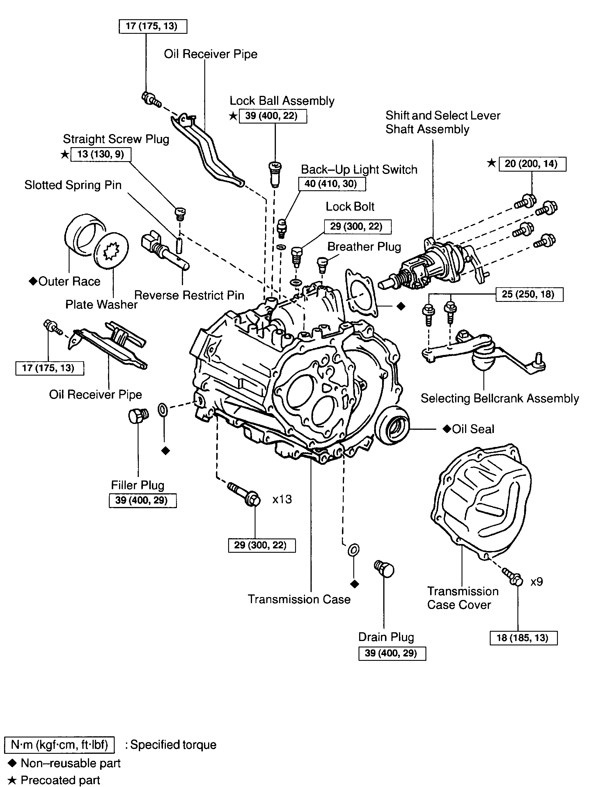

Thanks, can you tell me what is this component of the transmission.
I steel have the problem.
May 21, 2019 at 4:09 AM
  • 110,194 POSTS
Welcome back:
I'm not sure which part you are referring to. I do see the disconnected cables. Take a look at the pictures to see if you can identify which part it is. Let me know. I believe you are looking at the shift lever assembly, but I'm not sure.
