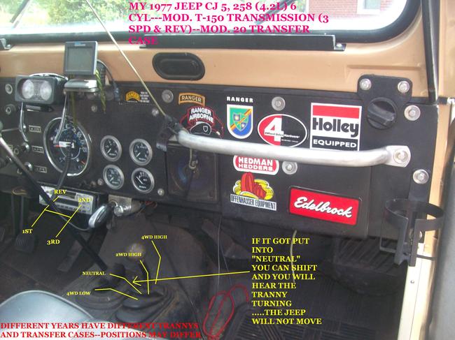

THE FIRST TIME IT HAPPENED TO ME WAS ANOTHER FELLER MESSED WITH IT UPON EXITING MY JEEP (NOT KNOWING)
THE REST OF THE TIME, IT'S BEEN MY EVIL BUDDIES DOING IT TO ME.....I RECKON THEY THINK I AIN'T GOT IT FIGGERED OUT.........BUT ONLY OWNING CJs SINCE I WAS ALLOWED ON THE ASPHALT IN 1981........I KNOW THE DEAL WELL.......IT ONLY TAKES SHIFTING THRU THE GEARS AND NOT MOVING......ONE TIME.......AND I GOT IT!!!
SEE IF YOUR TRANSFER CASE HAS BEEN BUMPED INTO NEUTRAL!!!!!!!!!
OTHER THAN THAT, MORE SEVERE
........HAS SOMEONE STOLEN YOUR DRIVESHAFT????........BEEN THERE TOO!
.......THEN I'D INVESTIGATE THE CLUTCH POSSIBILITY

And on to you dear Sir (of CJ Medevac), I do not quite understand what you meant by 'the transfer case bumped into neutral' because its a manual transmission (with 4 gears & Rev of coz). Kindly elaborate.

there should be a shifter for the tcase for low and high and in the middle it's neutral.as far as what you are tal;king about in the trans check fulid first then check the shifter for adjustment or wear. if this is one tha tgoes inside the trans get a pair of channel locks push down and turn the collar an dthe whole shifter will come out. then make sure it looks like a square or rectangle wher ethe shifter goes if not it is hung up between gears then take a large screwdriver and make everything line up then put shifter back in and see if it will shift if it does you are ok in not the trans has a problem inside.

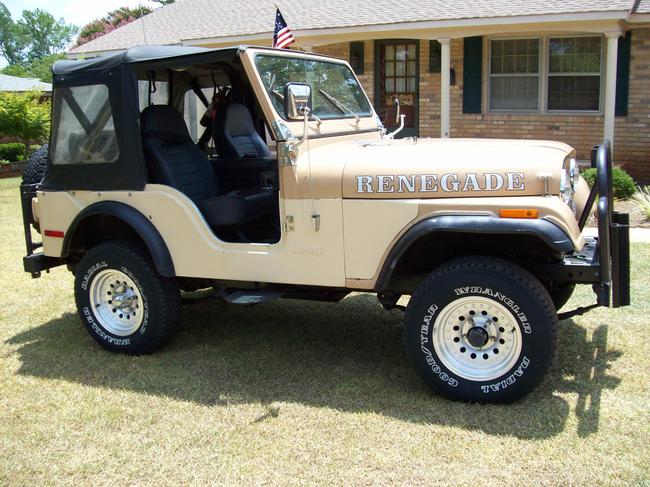

YOU MAY HAVE TO YANK HARD TO MOVE THE TRANSFER CASE LEVER
GIMME THE 1ST 8 DIGITS OF YOUR VIN....I MAY BE ABLE TO TELL YOU YOUR NOMENCLATURE
HECK.....SEND US A PIC!
KEEP IN MIND THIS IS "MY" '77 CJ5 LEVERS IN THE PIC
DEPENDING ON WHAT YOU HAVE---I HAVE PICS ON THE TRANNY'S INNARDS, FROM WHEN I REBUILT MINE

Apologies for my delayed responses. Having read your replies there's like a bunch of light bulbs that goes blink..blink..blink & when I saw your photo particularly of the 'neutral gear'...I felt like a dumb bimbo (or himbo) & began to wonder if I ain't masculine enough for a Jeep...(of what I see as a real man's auto). I'm definitely gonna follow your advice (to the letter) & will get back to ya on any progress. Hopefully I could address you as St. CJ Medevac in my next reply (your sainthood for being my savior).
Okee dokee..about my VIN no. I have to admit I'm kinda 'embarrassed' on this little issue. I'm actually located in Malaysia (42yr-old male) but I spent about 4 years in the States (Missouri) getting my degree. Back then, I was a biker..I rode a Honda Silverwing 500cc but my Harley buddies were always giving me a tough time (good-naturedly of coz) on me and my Jap bike! A chink on a jap bike! (well it's not racism if one's refering to oneself rite?) Now you see my Jeep has a Jap engine! A Nissan 6-cyclinder 2.5L engine. I guess that's probably why my VIN info doesn't look like what I see in the manual. Oh boy, now I feel like half the man I used to be, having to reveal this little secret...hahaha! All the 'machoness' on the outside hiding a teeny-weeny 2.5L Nissan engine. My late dad had it replaced due to the large difference in road tax payment between a 4.0L and a 2.5L engine.
Have to say looking at your photo, my Jeep's dashboard design especially with the large speedometer in the centre & 4 smaller gauges by the side + lighter/ashtray below looks identical to yours. Even the gear shift stick too.
