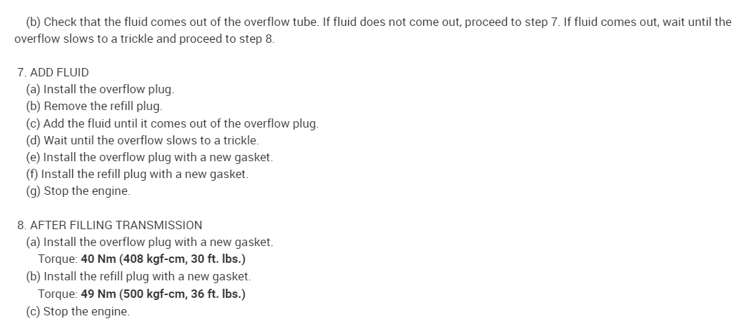

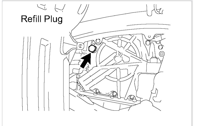

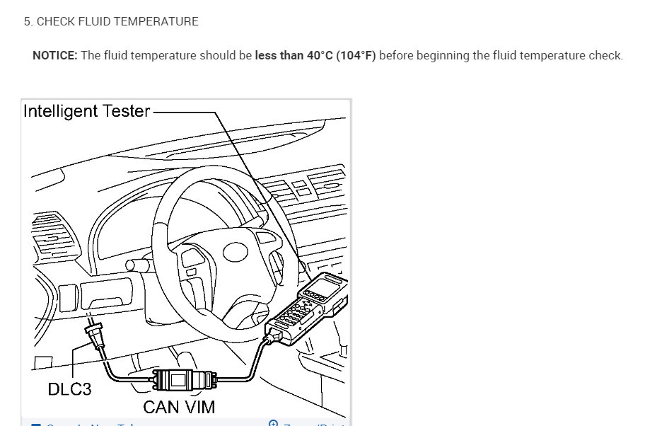

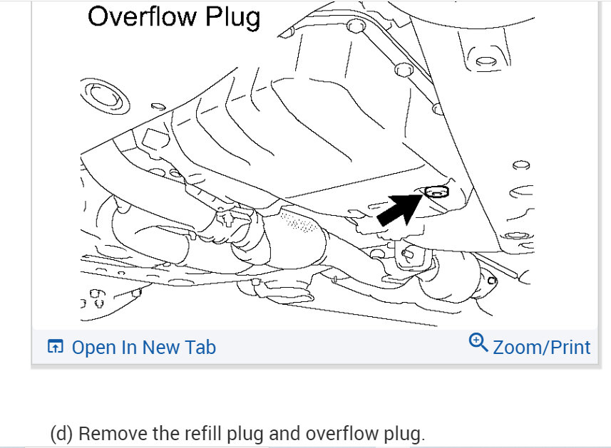

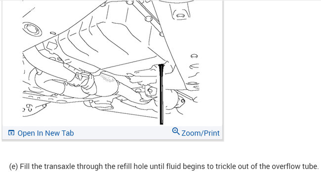

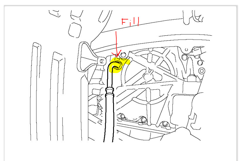

Where is the fill plug on the transmission on the car listed above? It has the transmission without a dipstick.
Jan 18, 2023 at 9:41 AM
Experienced Mechanic
110,248 POSTS

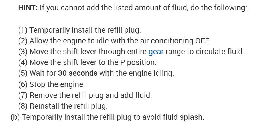

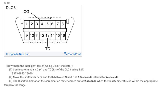

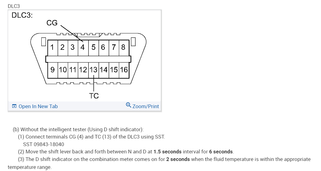

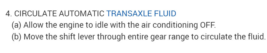

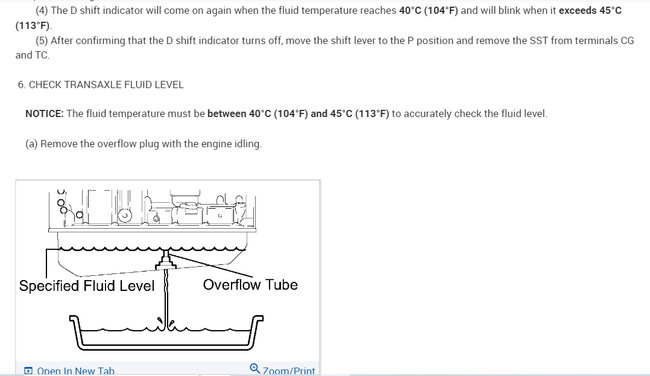

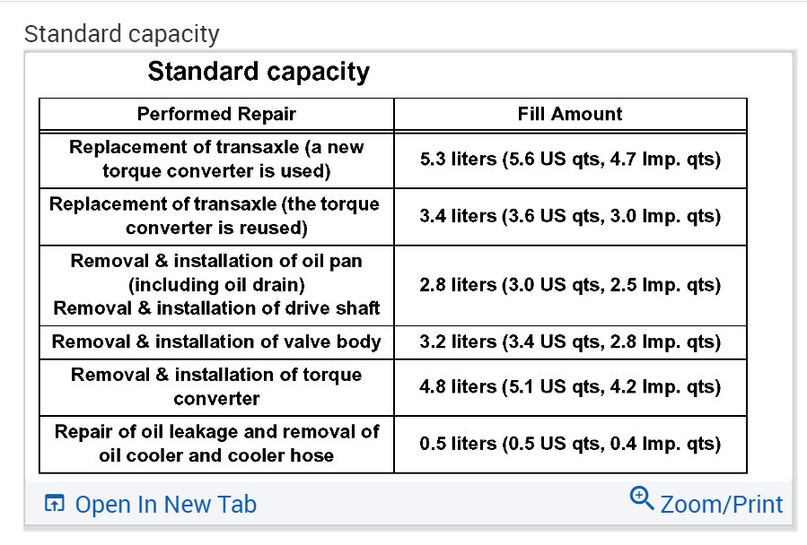

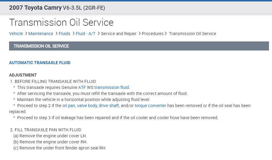

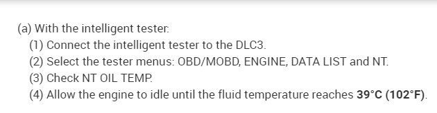

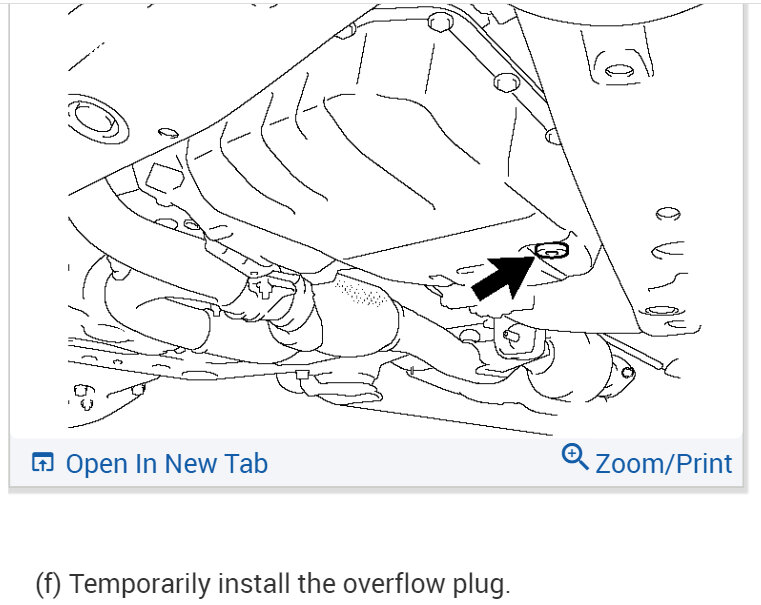

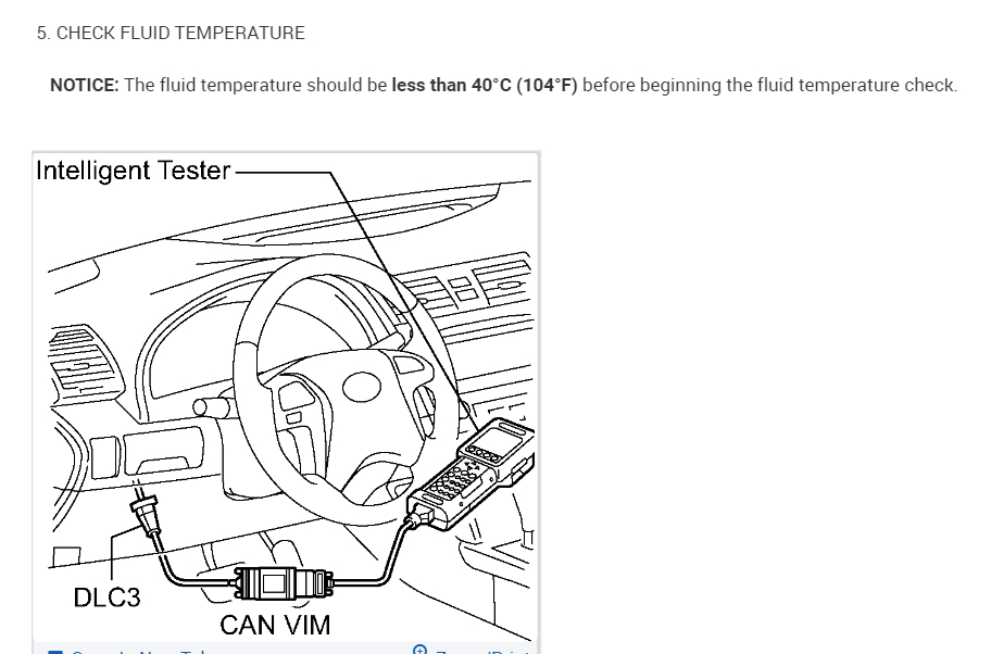

The fill plug is on the right side of the transmission. It requires the removal of the underside engine covers.
I attached the directions for refilling it below. The directions are based on different procedures and indicate how much to add for each.
Take a look through them and let me know if you have questions.
Let me know if this helps.
