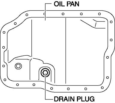

Also, here are the directions for a drain and fill for your vehicle. The attached pic correlates with the directions.
2014 Mazda 5 L4-2.5L
Automatic Transaxle Fluid (ATF) Replacement
Vehicle Maintenance Fluids Fluid - A/T Service and Repair Removal and Replacement FS5A-EL Transmission Automatic Transaxle Fluid (ATF) Replacement
AUTOMATIC TRANSAXLE FLUID (ATF) REPLACEMENT
2014 - Mazda5 - Transmission/Transaxle
AUTOMATIC TRANSAXLE FLUID (ATF) REPLACEMENT [FS5A-EL]
WARNING:
- Do not perform the servicing when the ATF temperature is high. Otherwise, it could cause severe burns or serious injury.
1. Drain the ATF.
a. Pull out the dipstick.
b. Remove the aerodynamic under cover. See: Air Dam > Removal and Replacement > Aerodynamic Under Cover Removal/Installation
c. Remove the drain plug and washer and drain the ATF.
pic 1
2. Add ATF.
a. Install a new washer and drain plug.
Tightening torque
- 30-41 N-m [3.1-4.1 kgf-m, 23-30 ft-lbf]
b. Install the aerodynamic under cover. See: Air Dam > Removal and Replacement > Aerodynamic Under Cover Removal/Installation
c. Add ATF from the oil filler tube.
ATF
- Mazda Genuine ATF M-V
Added amount (Reference)
- If ATF is drained from drain plug: 3.0 L [3.2 US qt, 2.6 lmp qt]
- If transaxle is overhauled: 5.0 L [5.3 US qt, 4.4 lmp qt]
d. Insert the dipstick.
3. Inspect the ATF level. See: Fluid - A/T > Component Tests and General Diagnostics > Automatic Transaxle Fluid (ATF) Inspection
