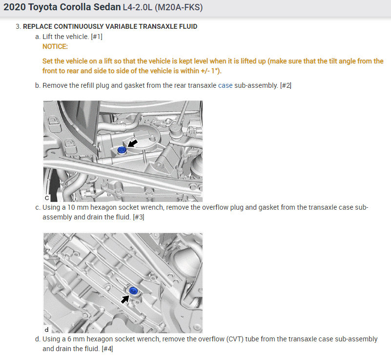

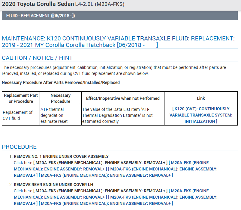

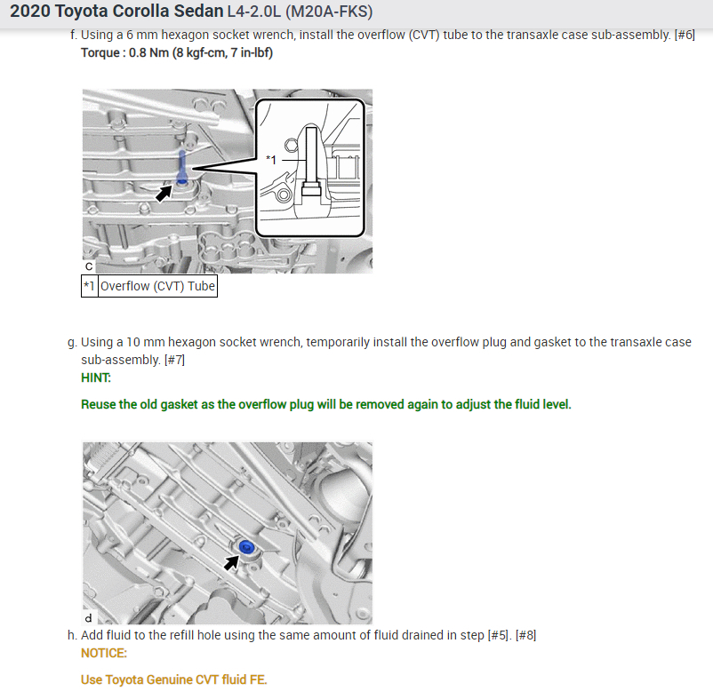

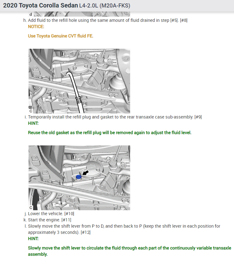

How do you do a transmission flush on my car? its a CVT. I have the car listed above SE model. I am asking for help with draining my CVT transmission. I noticed that the transmission drain plug is much more larger than 2018 Honda Accords. My 2020 looks like a 10 mm hex and a 2018 Accord use a Allen Wrench for the drain plug and for the straw plug inside the drain hole. My question was, do my 2020 Accord have a straw plug inside the drain hole that needs to be screwed out to drain more CVT Fluid?
Aug 30, 2021 at 7:07 PM
SQM
  • 6,383 POSTS

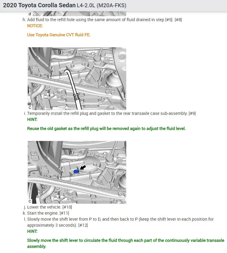

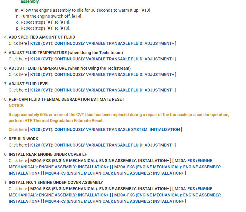

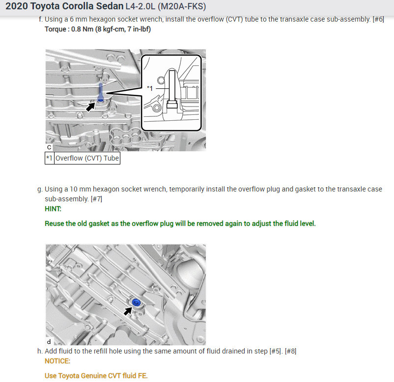

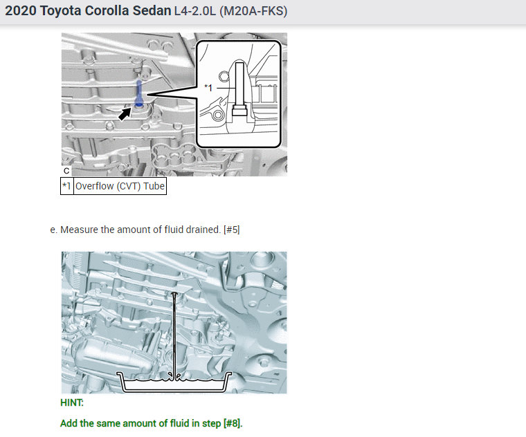

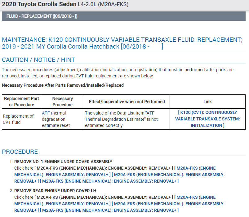

For the transmission fluid change you will have to remove 2 plugs. One is 10 mm hex another is 6 mm hex.
I have attached the fluid change procedure for your reference.

WILSON007
The last time i check my transmission looks different than the one showing in your pictures. once my girl friend returns I will send you pictures if you don't mind because i'm a little confuse with the pictures.
Sep 2, 2021 at 4:38 AM
SQM
  • 6,383 POSTS
Sure no problem. Just upload pictures when you are able to and we will get this figured out.
Sep 2, 2021 at 4:44 AM
