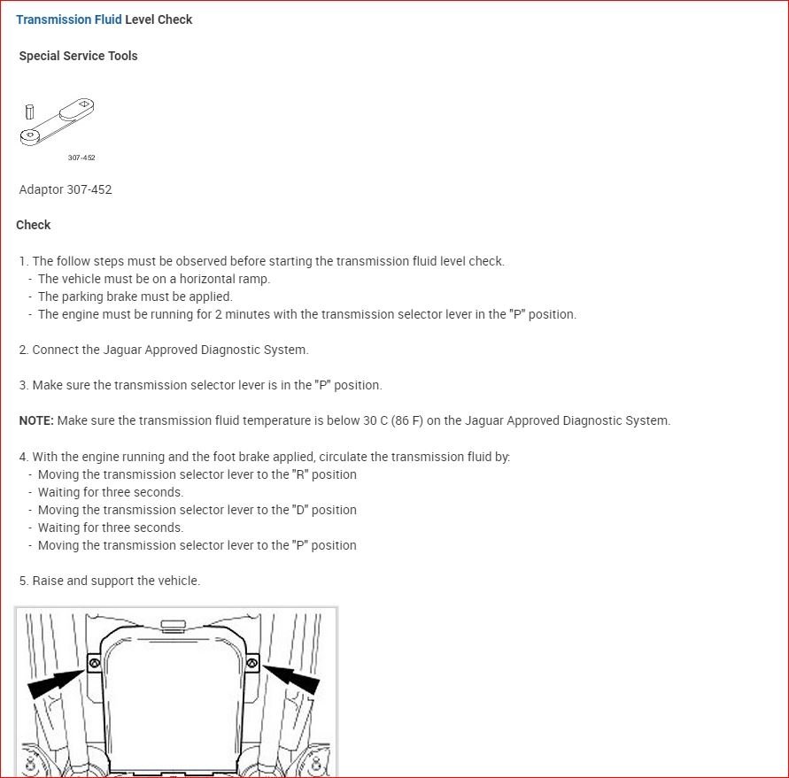

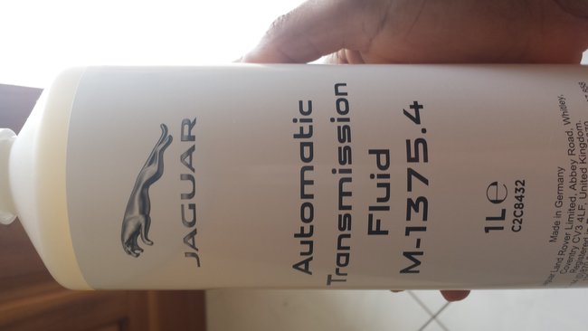

Good afternoon, I have bought the transmission fluid for my car. Can you tell me the steps in putting in the transmission fluid? Can you send images or video if possible please.Thank you for a speedy response! Kindly, see a picture of the transmission fluid that I bought below please .Thanks!

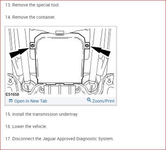

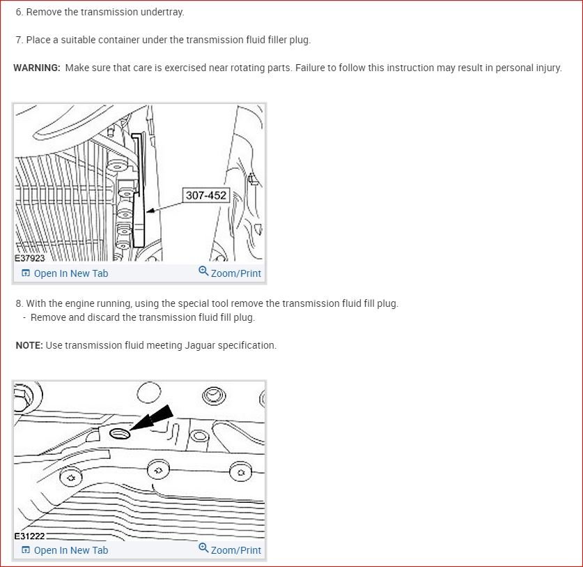

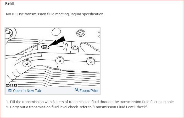

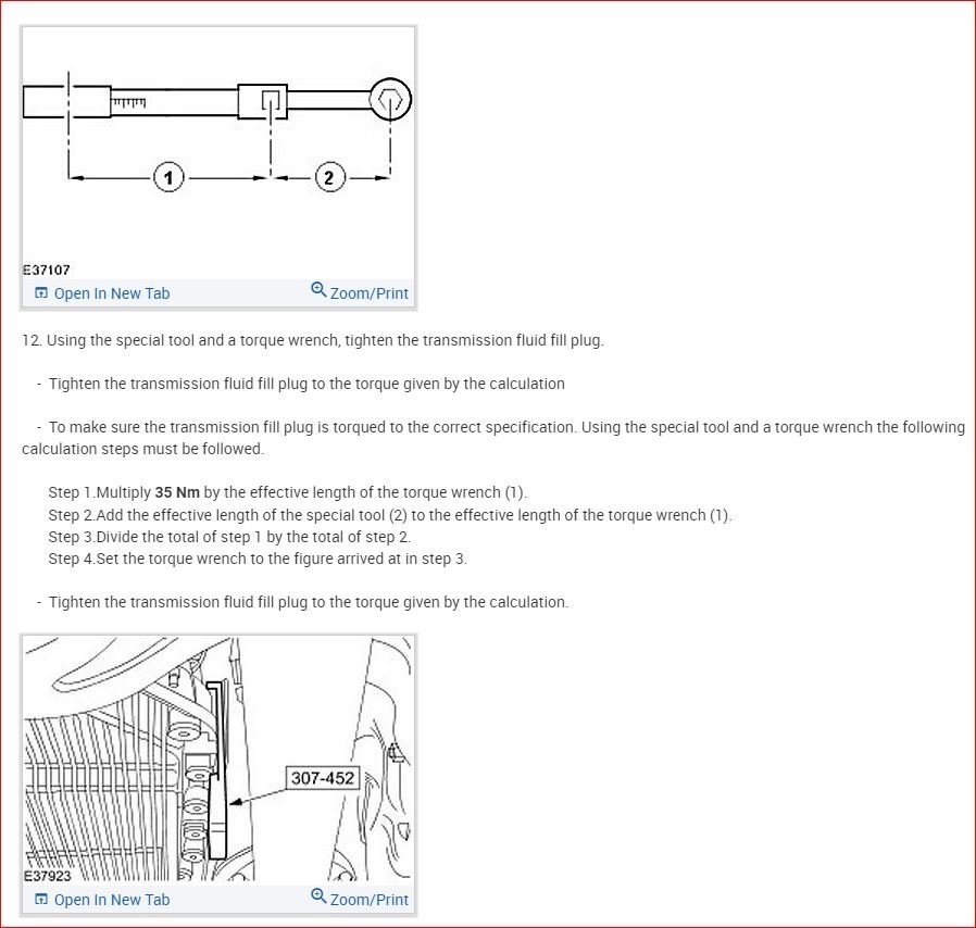

Hi Austino,
Unfortunately, this one is a little complicated. It is not just pouring in fluid like most other transmissions. I included the procedure on how to check and fill the fluid.
Please let me know if you have any questions. Thanks
