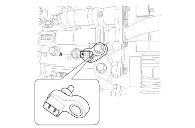

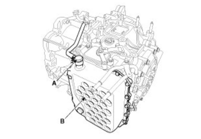

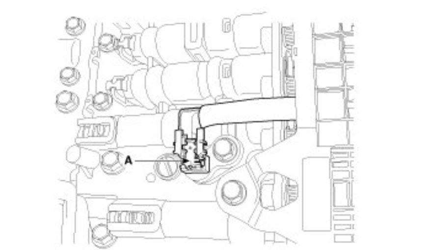

My car started shifting hard and the check engine light came on. I took it to auto zone and had the code read. It came up as p0711 Transmission Fluid Temperature Sensor "A" Circuit Range/ Performance. I have searched all over for a Diagram with the location of the sensor for my cars motor and there is none. Can you tell me where the particular sensor would be located?

It is inside the cover for the valve body. I attached the procedure and pictures for you to view.

3. Replace new gasket and the plug after draining the automatic transaxle fluid by removing the drain plug.
4. Remove the valve body cover (B) and eyebolt (A).
Tightening torque:
(A) 34.3 - 44.1 N.m (3.5 - 4.5 kgf.m, 25.3 - 32.6 lb-ft)
(B) 13.8 - 14.7 N.m (1.3 - 1.5 kgf.m, 9.4 - 10.8 lb-ft)

5. Disconnect the oil temperature sensor connector (A).

6. Remove the oil temperature sensor (A) after removing a bolt.
Tightening torque:
9.8 - 11.8 N.m (1.0 - 1.2 kgf.m, 7.2 - 8.7 lb-ft)
