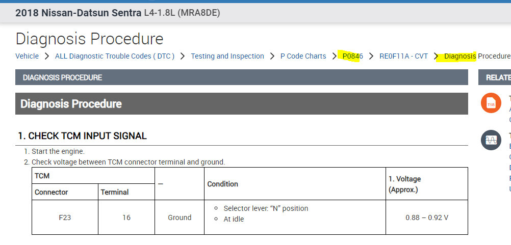

Where is the transmission fluid pressure sensor located?
2018 NISSAN SENTRA
140,000 MILES • AUTOMATIC
BIGT79
Location of the transmission fluid pressure sensor circuit b.
Jan 13, 2024 at 8:45 AM
  • 110,194 POSTS

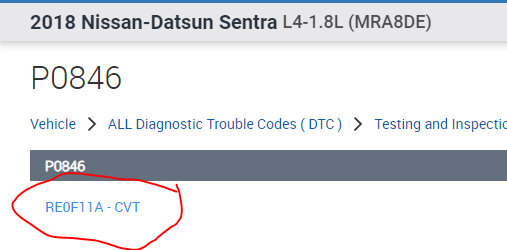

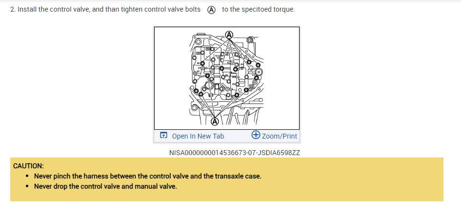

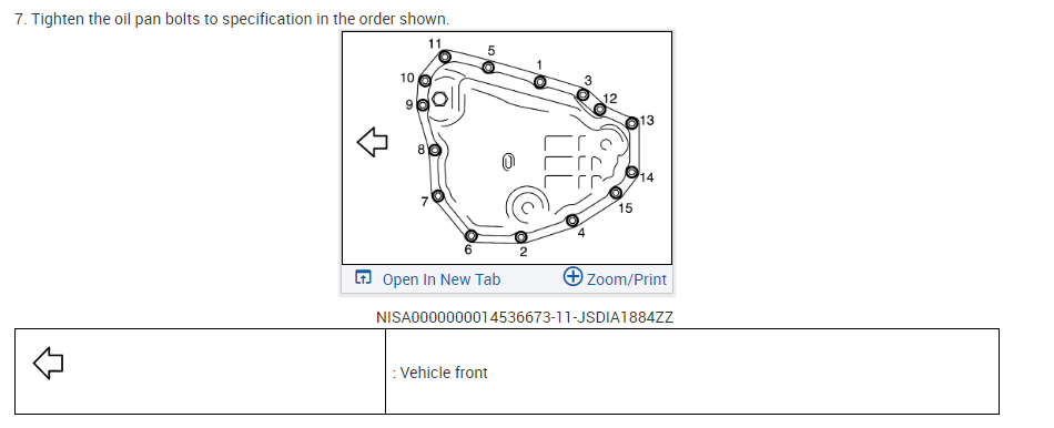

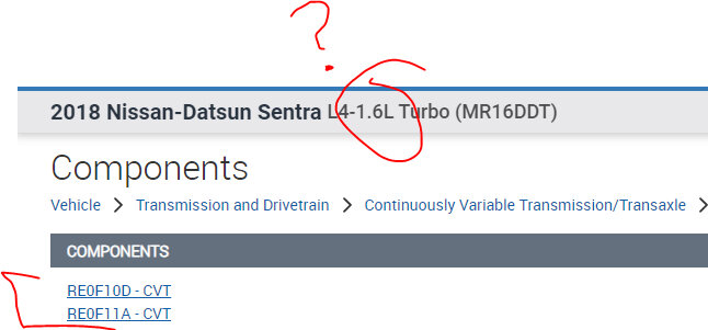

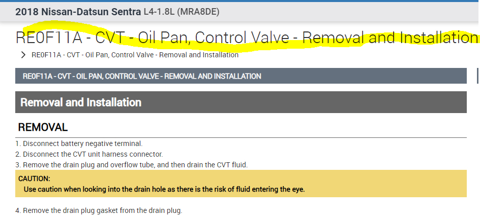

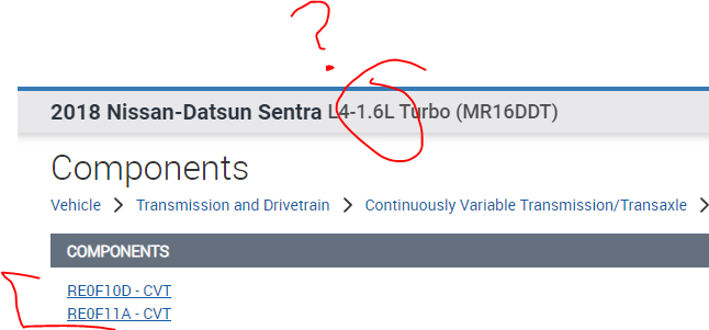

I need to know some general information. What size engine does it have? Also, just FYI there are two different transmission options. I suspect the engine size will be related (pic 1). Also, there are different pressure sensors. See pic 2.

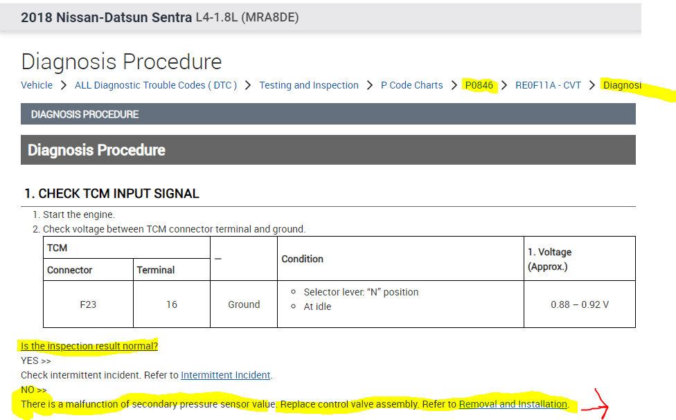

If you can, let me know what code you are getting. That will point me in the right direction.
Jan 13, 2024 at 4:59 PM
BIGT79

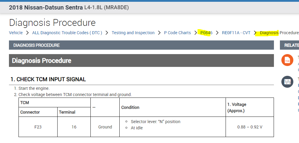

It's non turbo and the code is po846.
Jan 14, 2024 at 2:16 AM
  • 110,194 POSTS

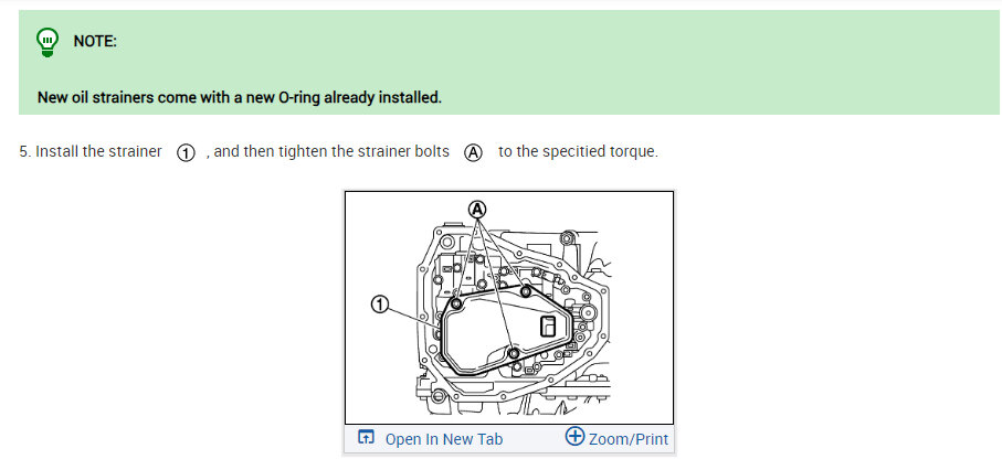

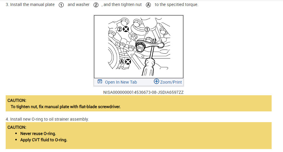

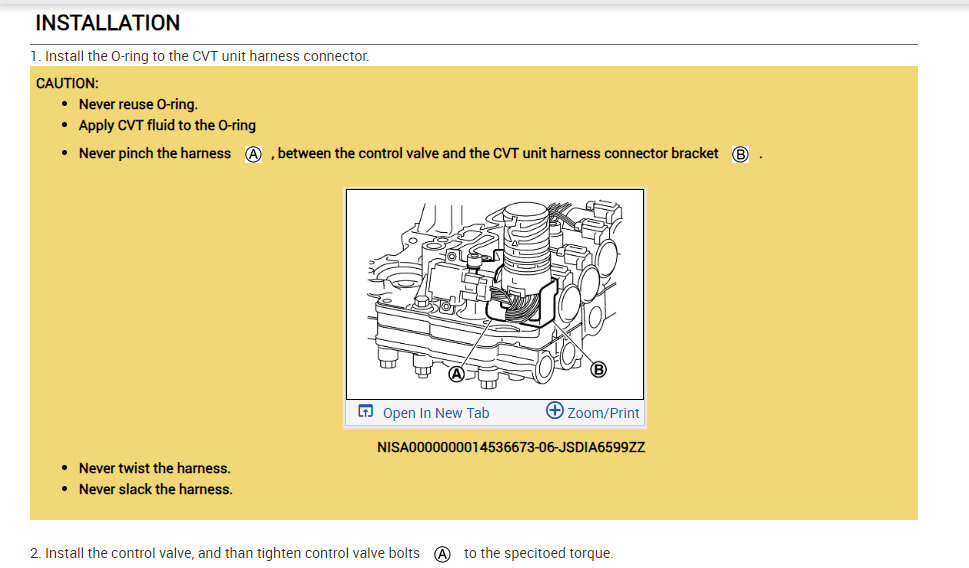

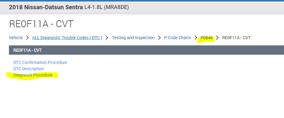

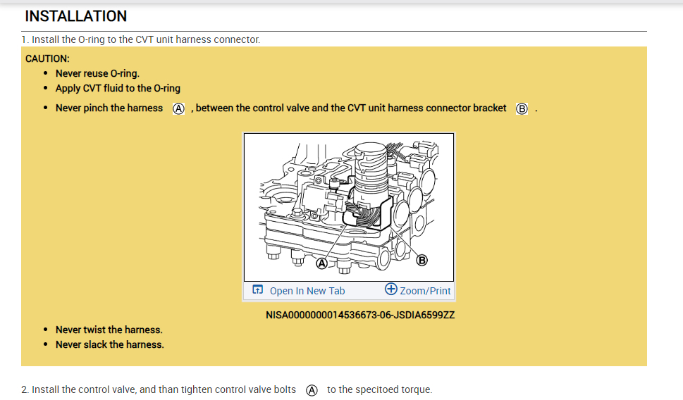

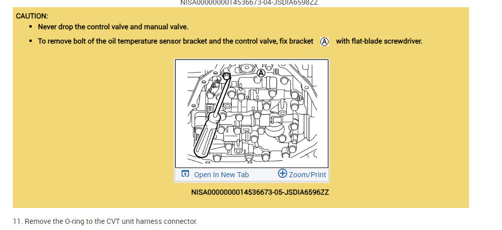

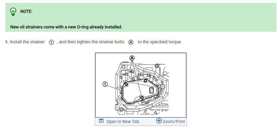

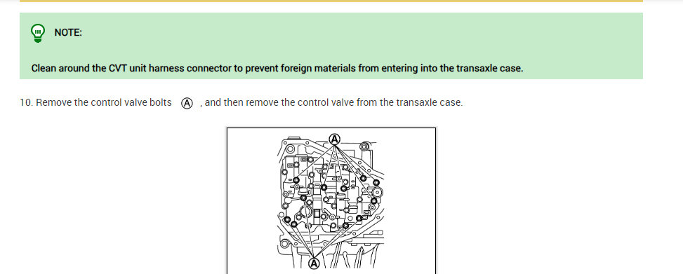

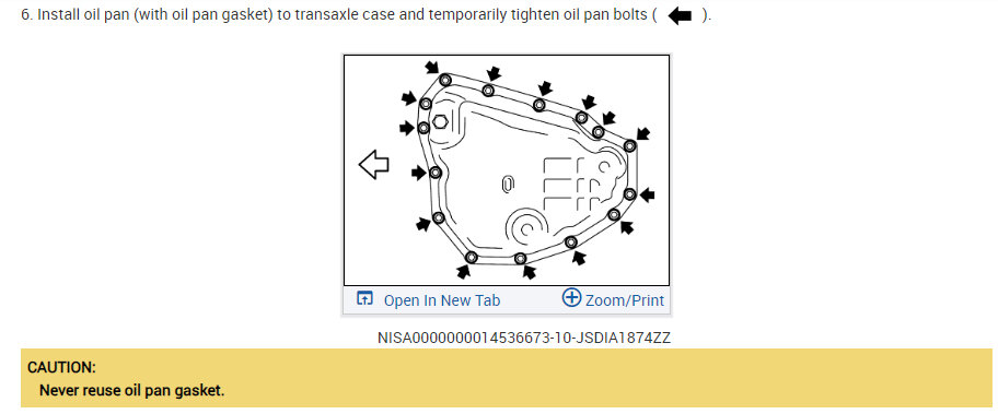

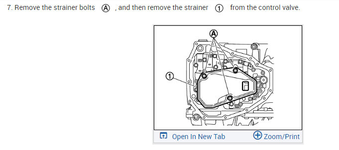

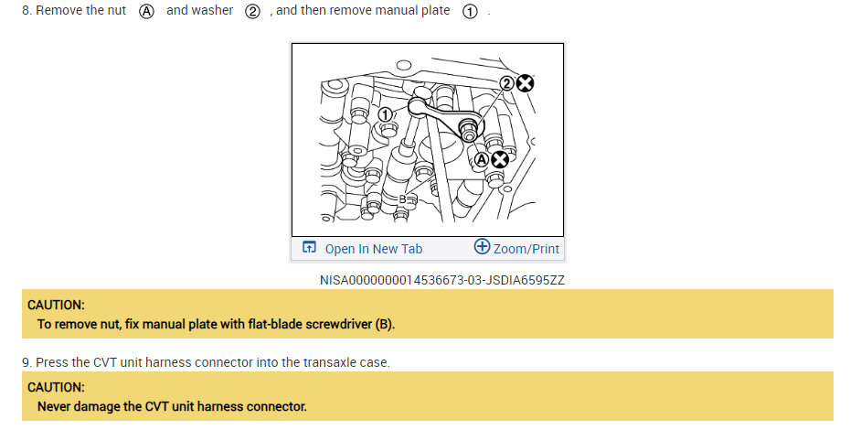

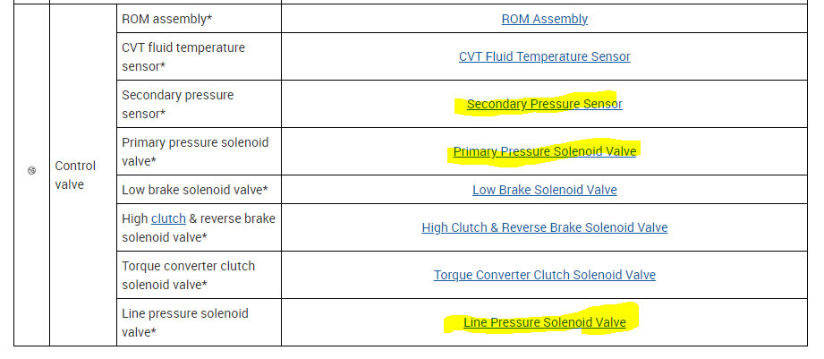

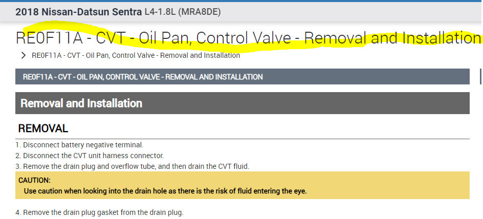

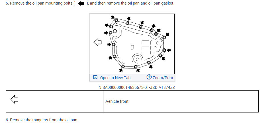

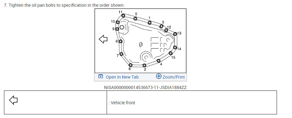

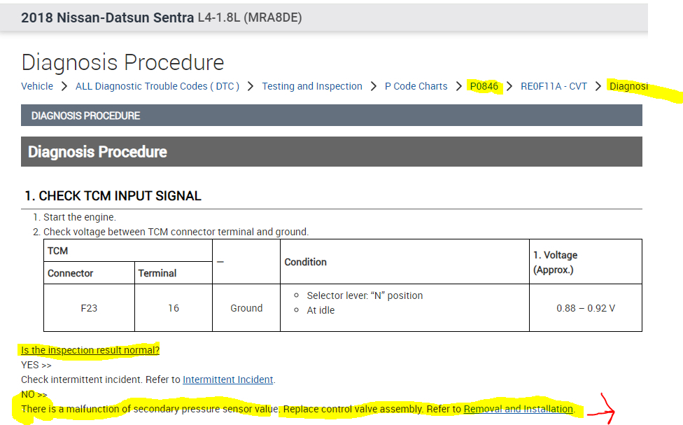

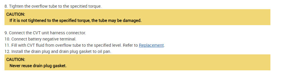

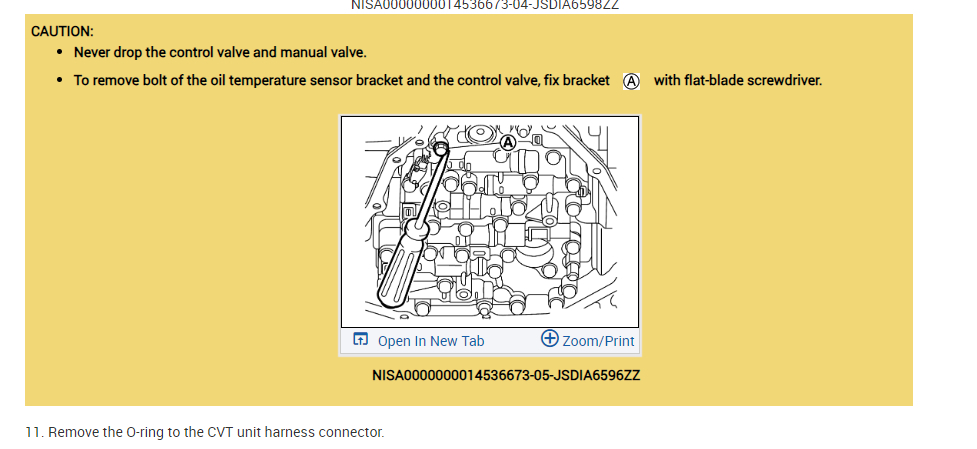

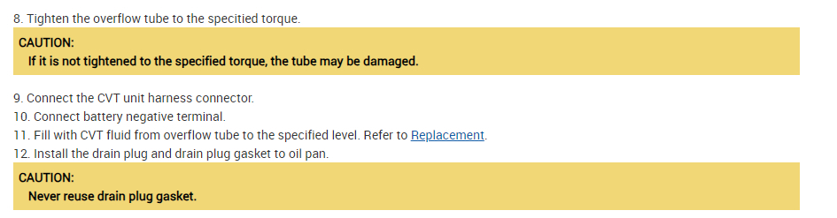

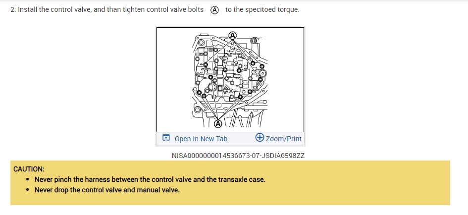

If you look below, I provided the description of the code, the diagnostics, and how to perform the repair.
Take a look through the pics and let me know if you have questions. Also, let me know if it helps.
