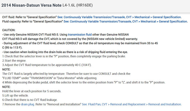

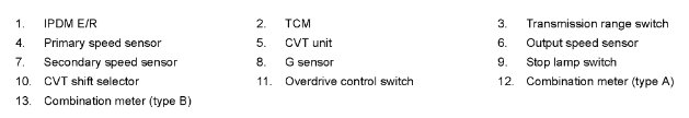

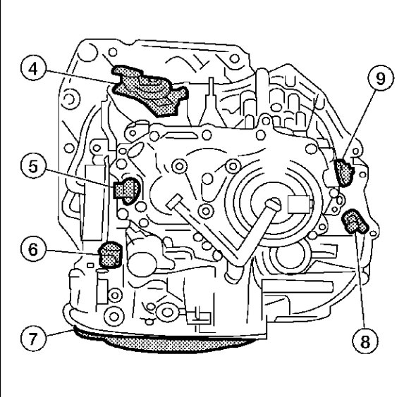

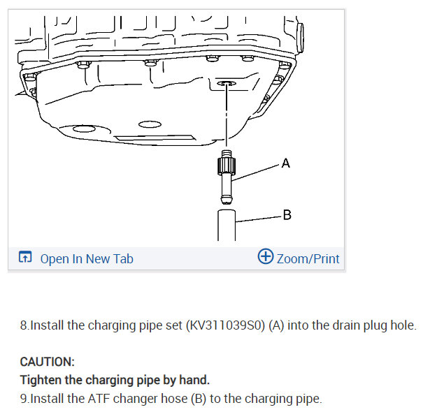

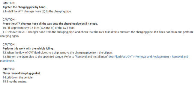

The P0846 code indicates an issue with the transmission fluid pressure (TFP) sensor/switch B circuit. Here is the location of the sensor but this can be because of low fluid levels.
Fluid Types
Continuously Variable Transmission (CVT) Fluid (If equipped)
Type .................... Genuine NISSAN CVT Fluid NS-3*
*Use only Genuine NISSAN CVT Fluid NS-3. Using transmission fluid other than Genuine NISSAN CVT Fluid NS-3 will damage the CVT, which is not covered by the NISSAN new vehicle limited warranty.
Capacities
Capacity .................... 7-1/4 qt (6.9L)
Here is how to check the fluid level. Please check out the images below

Thank you so much for the reply. Do you know how it looks a picture of the same and where I can buy it because here in Zambia, I have failed to find it?
