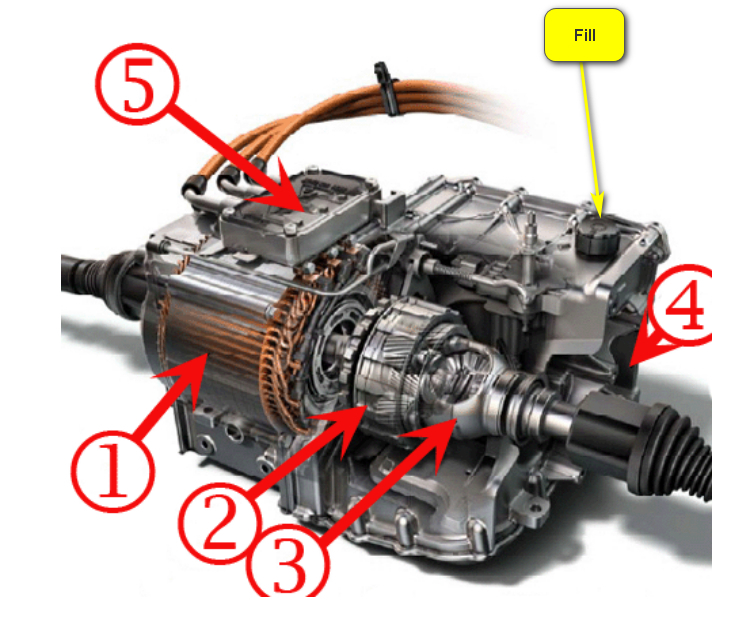

How can I reach Transmission Fluid Fill Cap?
2014 CHEVROLET SPARK EV
96,000 MILES • 2WD • AUTOMATIC
AHMAD2330
MEMBER
5 POSTS
A proper way and are there good images explaining that?
Jan 15, 2024 at 6:51 AM
BORIS K
Experienced Mechanic
836 POSTS

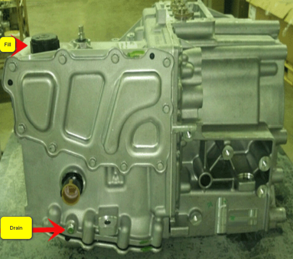

The filler cap is on top of the transmission.
See image below.
Hope this helps.
Cheers, Boris
