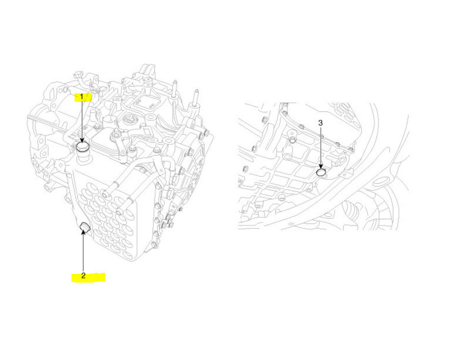

Where do I add transmission fluid on this car?
2011 KIA FORTE
100 MILES
RAY F HERNANDEZ
Where is the transmission fluid entry on the car listed above?
Feb 26, 2022 at 12:19 AM
SQM
  • 6,383 POSTS
For the automatic transmission, the fluid needs to be added through a plug located on the top of the transmission housing.
I have attached a diagram below showing the location. The number 1 is where you add fluid, and the number 2 plug is the fluid level plug.
The fluid type of SP-IV
