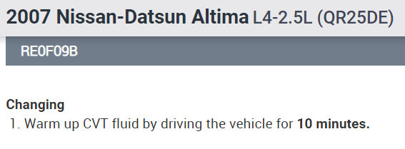

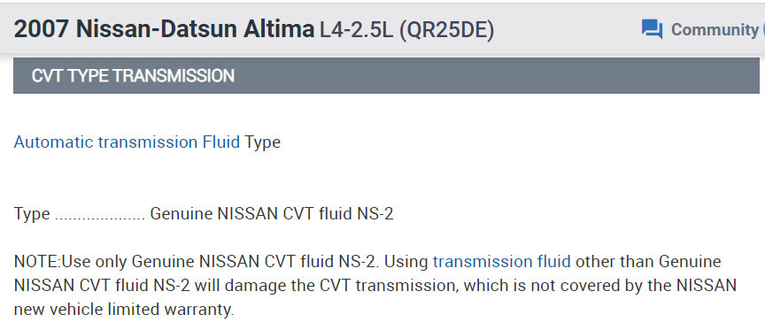

Can I use either one of these transmission fluids when changing my transmission fluid?
2007 NISSAN ALTIMA
102,000 MILES • 2.5L • 4 CYL • 2WD • AUTOMATIC
DUWHOP31
  • 151 POSTS
Can i use either one of these transmission fluids when changing my transmission fluid?
Jan 8, 2021 at 3:13 PM
DANNY L
  • 5,648 POSTS
Hello, I'm Danny.

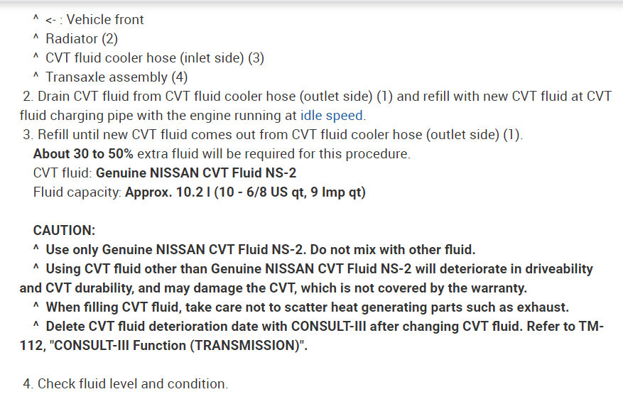

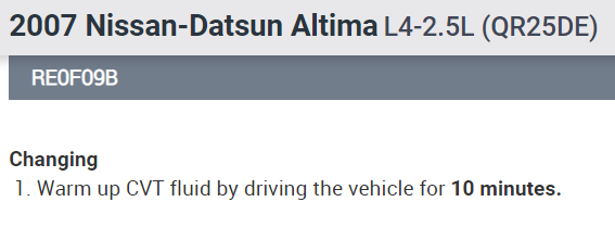

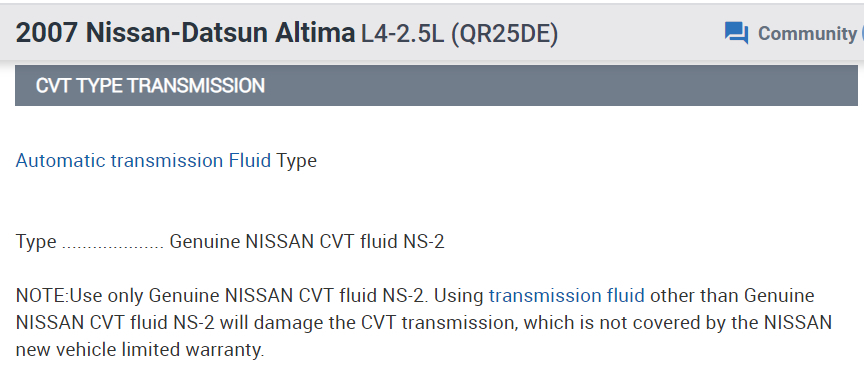

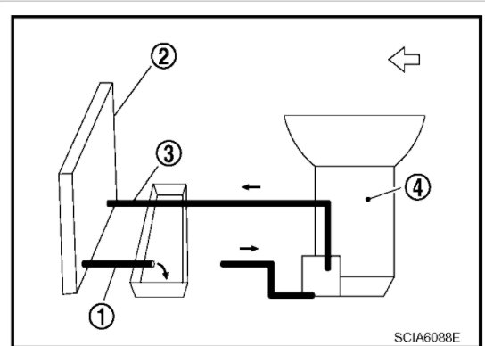

Here is the information you requested. First, here is a tutorial showing how to change the automatic transmission fluid:
I've attached picture steps below on how to service the transmission for your car. The first picture shows the Nissan dealer cvt - continuously variable transmission type fluid that is required. The picture you attached below showing Valvoline brand looks to be cvt transmission suitable. Hope this helps and thanks for using 2CarPros.
May 1, 2021 at 1:24 PM
