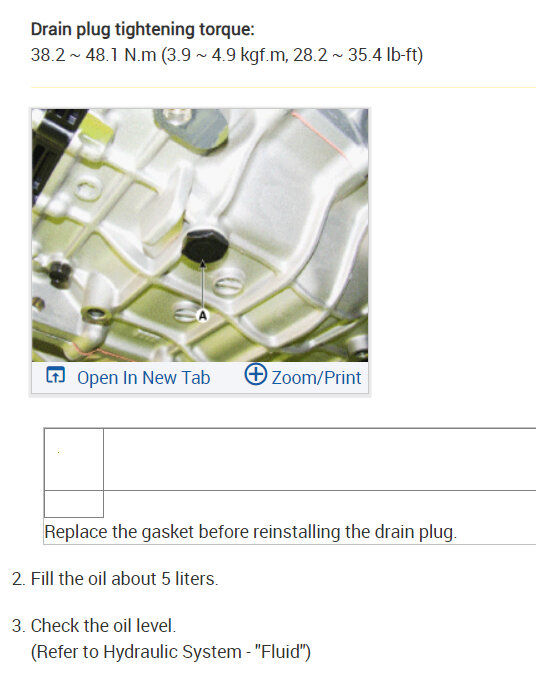

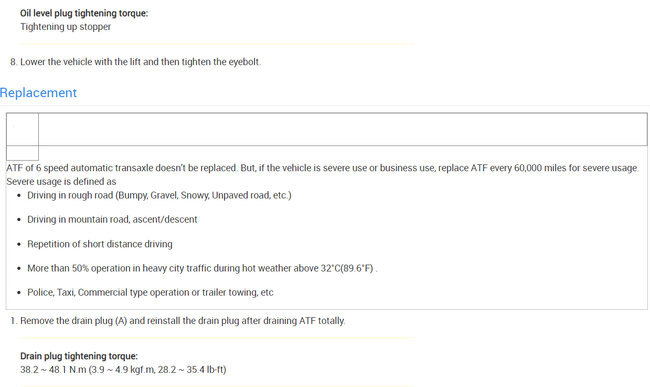

How to drain and fill the transmission fluid?
142,000 MILES • 2.4L • 4 CYL • 2WD • AUTOMATIC
BHAMDOC1973
  • 2,007 POSTS
This is the 2.4l one, need to drain and fill, can you send instructions?
Also, the capacity and type of fluid recommend, please.
Dec 4, 2023 at 5:13 AM
  • 55,851 POSTS

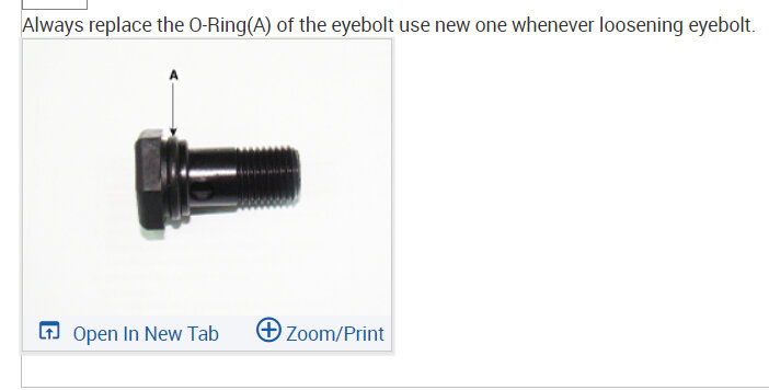

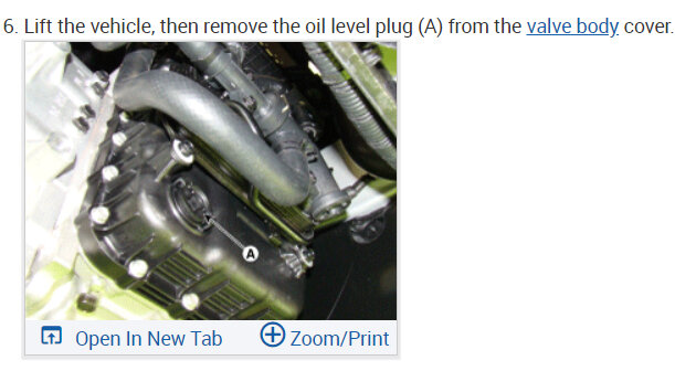

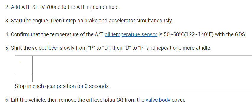

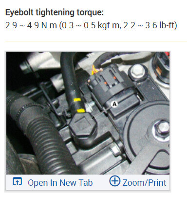

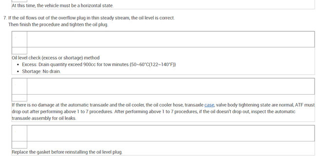

Here is how to change the transmission fluid including type and capacity:
Fluid Types:
Automatic Transaxle Fluid
Type .................... MICHANG ATF SP-IV, SK ATF SP-IV, NOCA ATF SP-IV, HYUNDAI genuine ATF SP-IV or other brands meeting the specification approved by Hyundai Motor Co.
Capacities
Capacity .................... 7.50 qt (7.1L)
Check out the images (below). Let us know if you need anything else.
