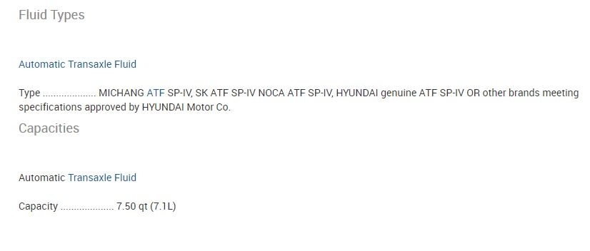

What is the transmission fluid capacity for a flush and fill?
Wednesday, January 13th, 2021 AT 5:08 PM
MECHANIC
52,796 POSTS
Good evening,
I attached the fluid type and capacity below for you.
