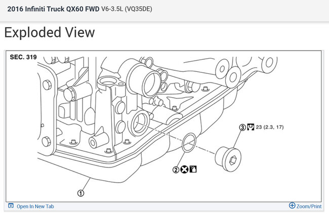

I need to drain and fill my transmission which is all good, my issue is my scanner doesn't log transmission temperature on live data at least to my knowledge. Can i go off coolant temperature in order to get an idea of when I have 'warmed' it up enough to cycle the new fluid before checking/adding until it drizzles from the level plug? I'm also wondering if a 2013 JX35 transmission dipstick would fit the fill tube on my model year and read correctly?

Let us know if you need anything else.

Yes, the fluid level should be close to nothing as it the engine warms up, it is like the old style of manual transmission, I forgot to add the fill plug location for clarity. Check out the images (below).

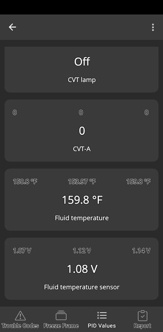

Great news I finally got a way to read trans temp so run the car until normal temp then drain all thst will come out and replace just that. Then run through the gears until hot with new fluid and pull the check plug and add until it comes out, correct?
May 22, 2025 at 11:41 PM
  • 55,691 POSTS
Yep, that is correct.

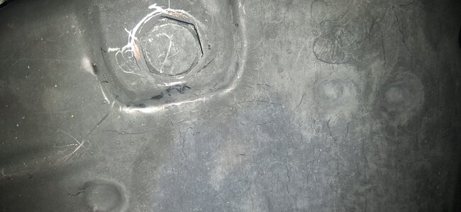

So all went good as far as swapping the filter because the drain bolt will not move and seems like it's been stripped or cross threaded because nothing fit on the head of it and it seems like the one time use (get the vehicle to the shop) plugs that can be installed. So I'm left to siphoning . Is the dipstick tube seem realistic to try and get it out of?

  • 55,691 POSTS
There is no dipstick tube FYI, just a fill plug which the fluid will run out of when full. I would remove the transmission pan and repair the drain plug because if it is stripped it will leak. Please go over the image in the above post.
