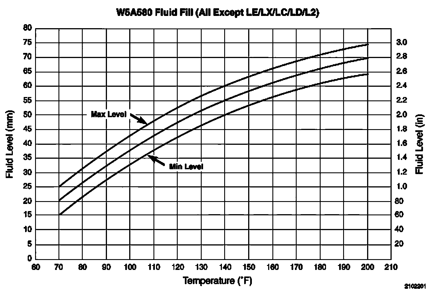

how do I check and add transmission fluid?

7. With the transmission in "P", determine the height of the oil level on the dipstick and using the height, the transmission temperature, and the Transmission Fluid Graph, determine if the transmission oil level is correct.
8. Add or remove oil as necessary and recheck the oil level.

I don't see a dipstick.
Oct 1, 2025 at 12:22 PM
  • 55,433 POSTS
There should be a fill plug usually on the drivers side, please go over this guide to help.
https://www.2carpros.com/articles/how-to-check-and-add-transmission-fluid
Please go over this guide and get back to us.
