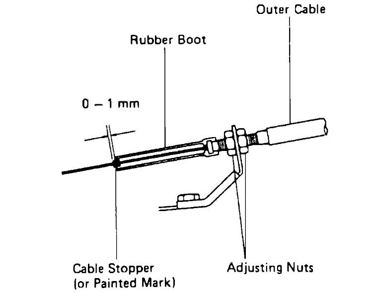

I have another question. Transmission is not slipping or anything but it takes a while for it to shift gears like first and second the rpms go way up before it shifts and when it wants to go to 3rd gear, I have to let off the gas for it to shift. What is the problem? Could it be the throttle linkage or the kickdown cable or what could it be?
Sep 1, 2019 at 12:39 AM
There is a throttle cable on the throttle body and it is adjustable. It is held by 2 nuts. You can loosen the nuts and move the cable back and forth. Each time you adjust it, road test it to see if you went the right way until it comes down.
1. Remove air intake hose, fully depress accelerator pedal and ensure that throttle valve is fully open. If not, adjust accelerator linkage.
2. Hold accelerator pedal fully depressed, and adjust cable to obtain 0-0.04 inch clearance between end of housing and inner cable stop, Fig. 1.
3. Tighten adjusting nuts to secure adjustment and release accelerator pedal.
4. Fully depress accelerator pedal and recheck adjustment.
5. Install air hose and road test vehicle.

I tried it and still same issue. It shifting a little hard.
Sep 1, 2019 at 10:58 AM
Did the shift points change?
Sep 1, 2019 at 11:11 AM
KVONLUCAS
  • 24 POSTS
No still the same.
Sep 1, 2019 at 11:41 AM
Okay, then you have valve body issues. The throttle pressure valve may be sticking inside the bore.
You will need to drop the valve body to access the valve.

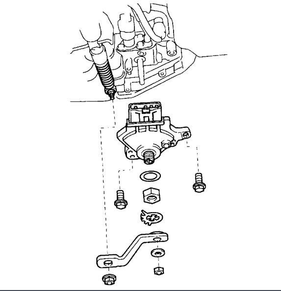

Okay thanks. I had also realized that the d light doesn't even light up on the dashboard after I had installed the previous transmission. It had used to come on when I had shift it to drive. But it doesn't come on anymore. Is it just telling me something or just could be a blown bulb in the dashboard?
Sep 12, 2019 at 11:42 AM
Okay, the range switch controls that and maybe the issue.
I attached a picture and the procedure below for you.
1. Remove control shaft lever
a. Remove the nut and control cable.
b. Remove the nut, washer and control shaft lever.
2. Disconnect park/neutral position switch connector
3. Remove park/neutral position switch
a. Pry off the lock washer and remove the nut.
b. Remove the 2 bolts and park/neutral position switch.
4. Install park/neutral position switch
a. Install the park/neutral position switch with 2 bolts.
torque: 5.4 nm (55 kgf-cm, 48 inch lbs.)
b. Install a new lock plate and the nut.
torque: 6.9 nm (70 kgf-cm, 61 inch lbs.)
c. Bend claws on the lock plate to fix the nut.
d. Adjust the park/neutral position switch.
5. Connect park/neutral position switch connector
6. Install control shaft lever
a. Install the control shaft lever, washer and nut.
torque: 13 nm (130 kgf-cm, 9 ft. Lbs.)
b. Install the control cable and nut.
torque: 15 nm (150 kgf-cm, 11 ft. Lbs.)
