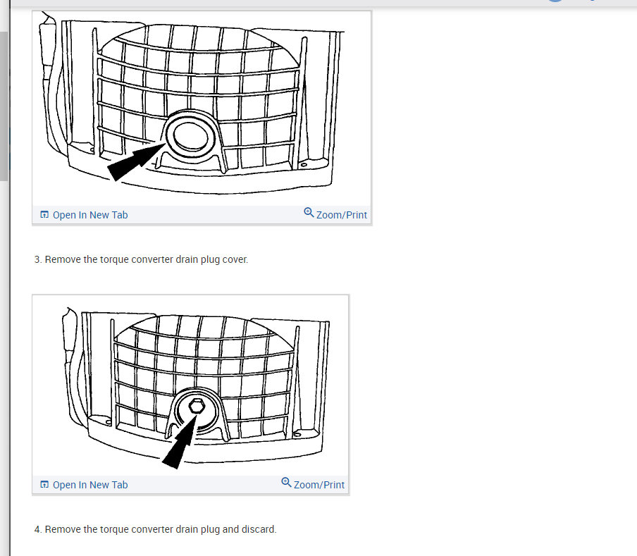

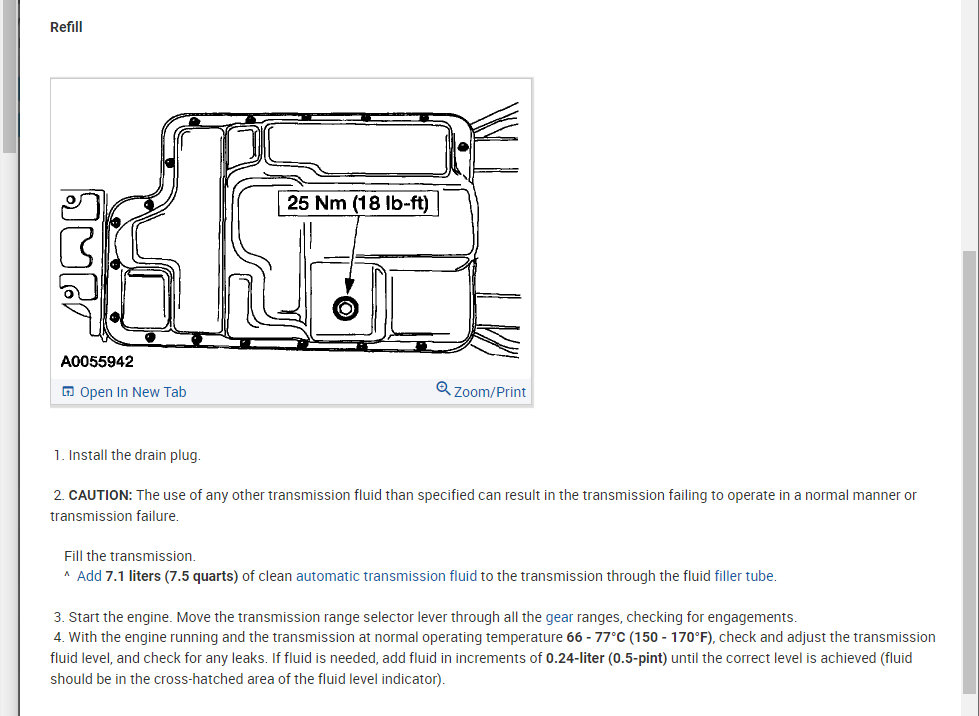

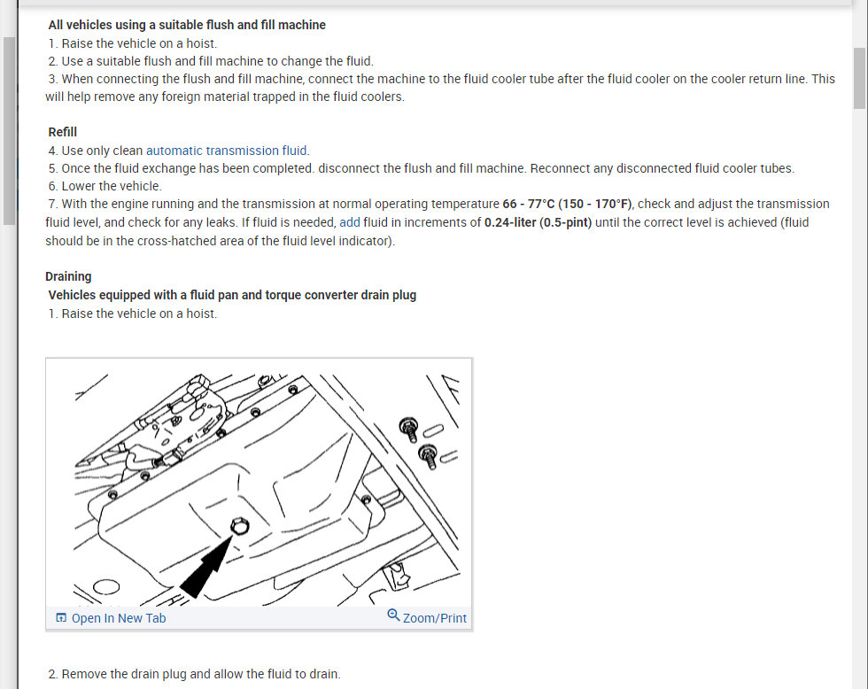

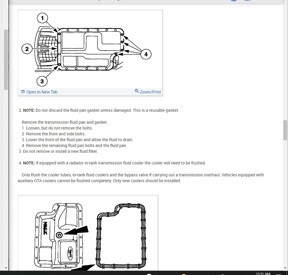

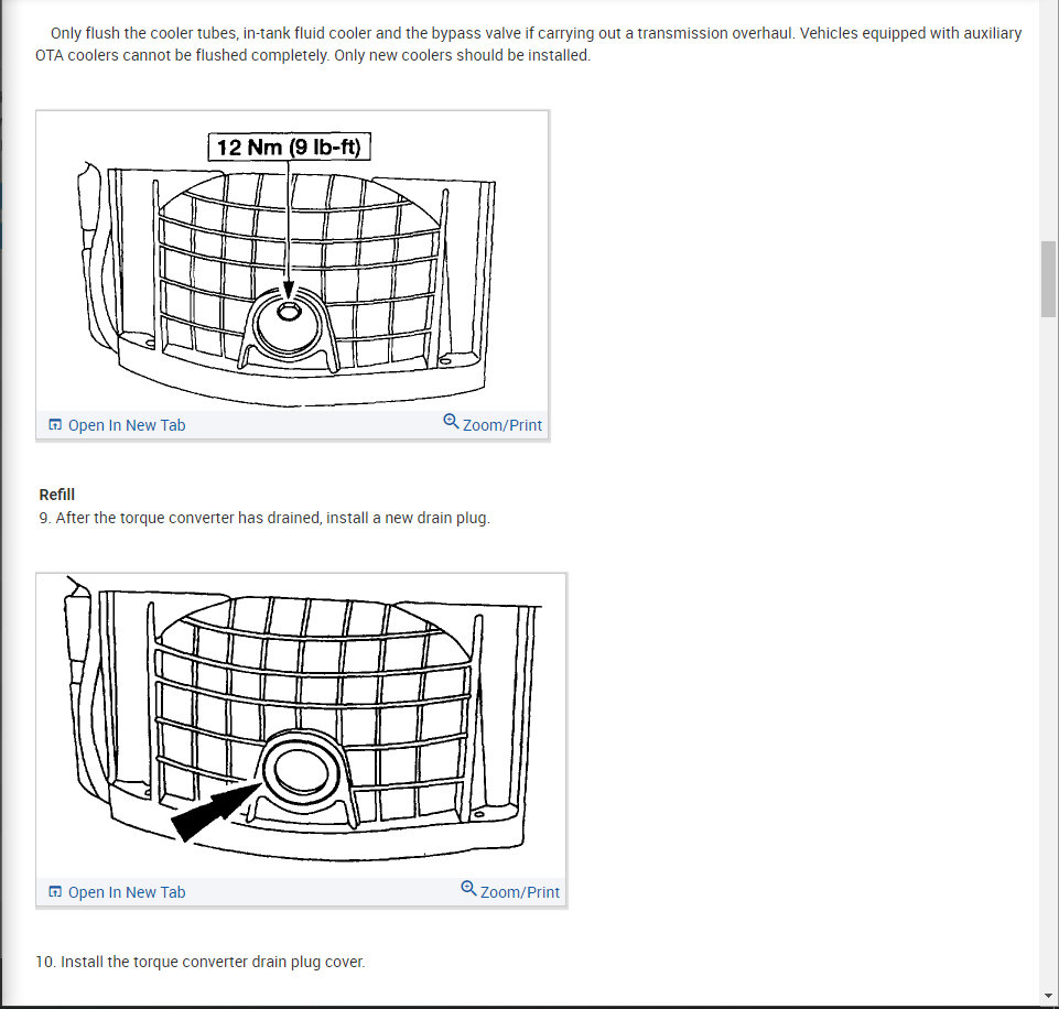

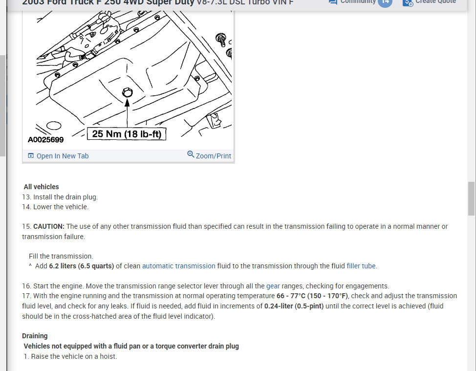

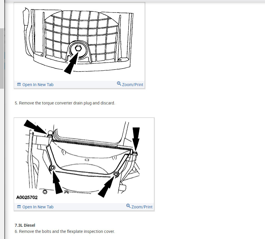

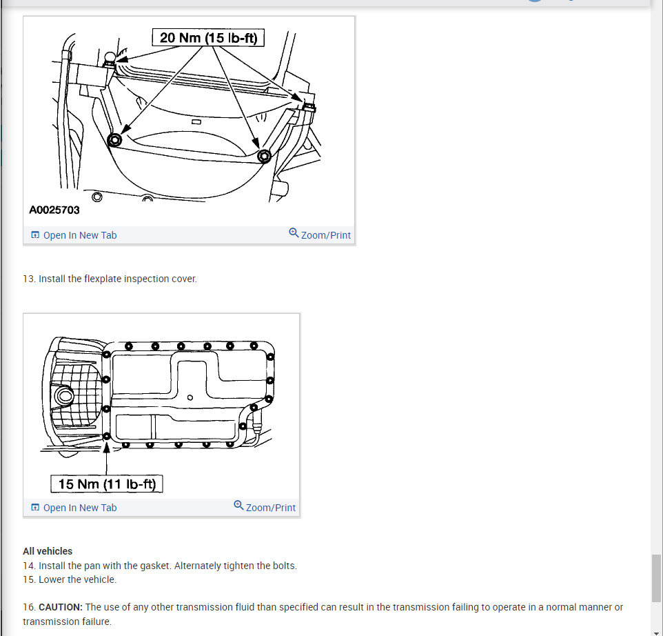

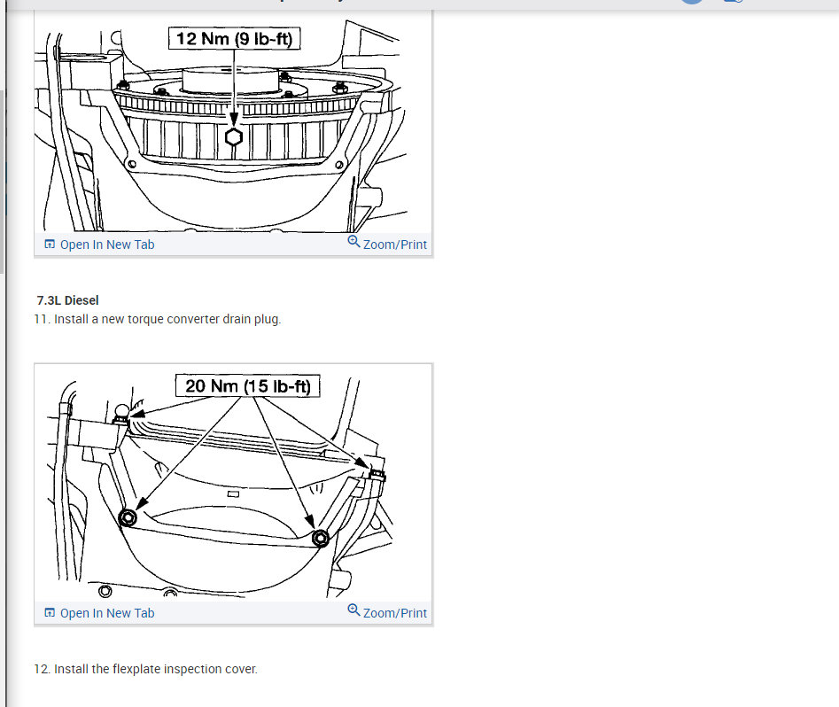

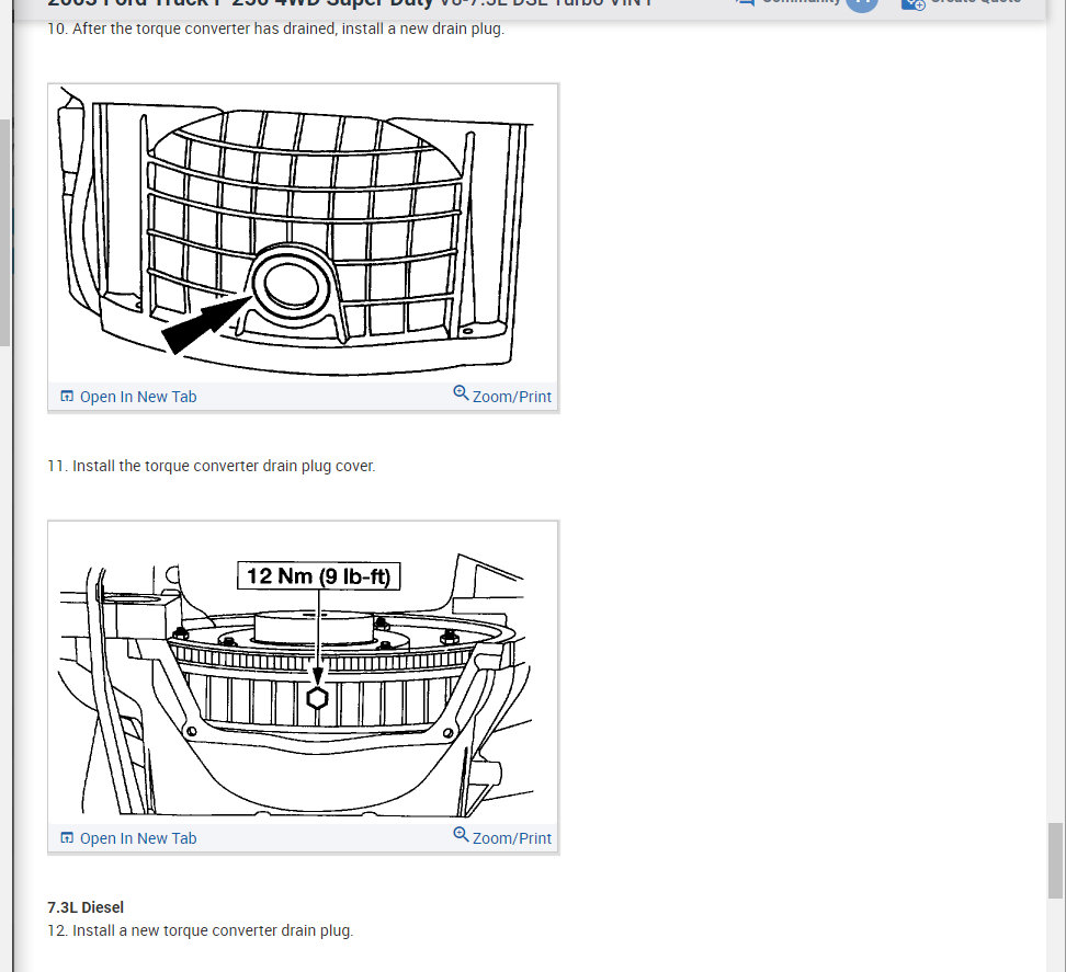

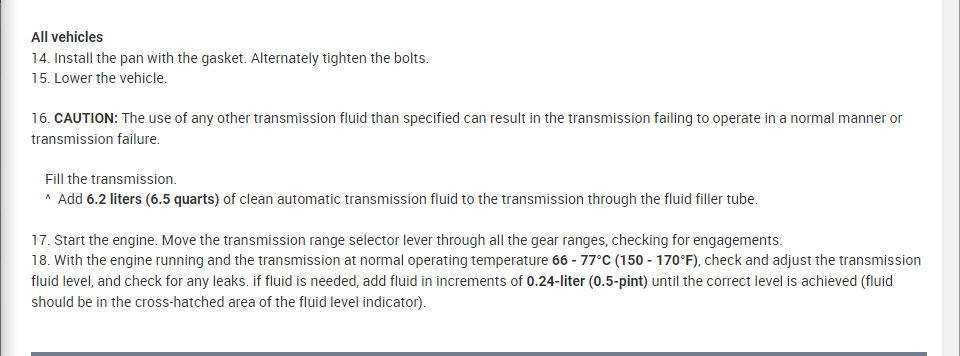

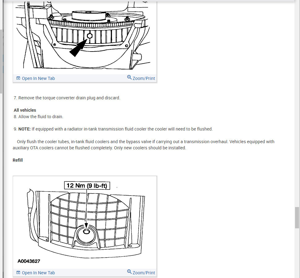

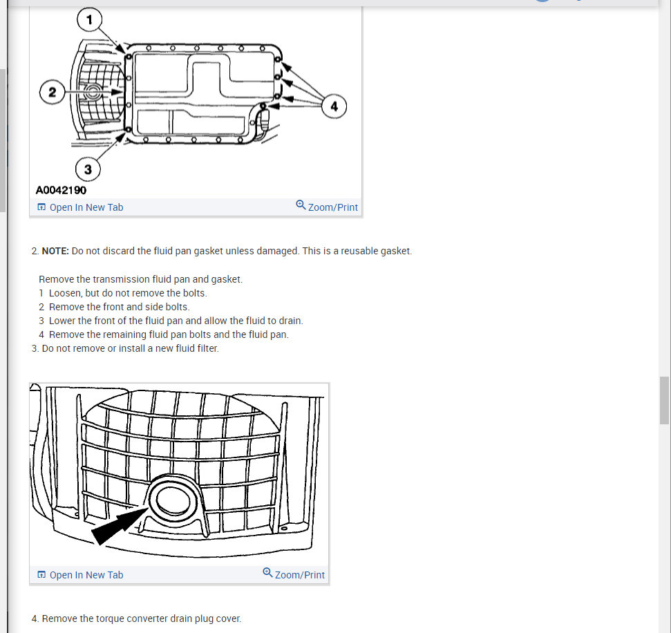

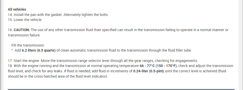

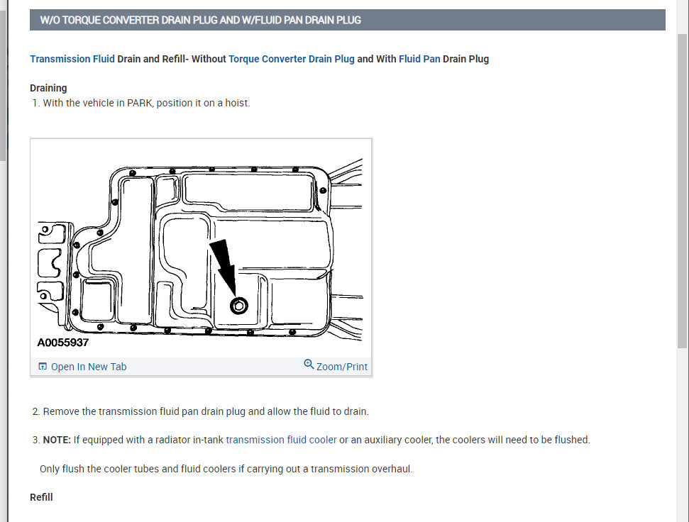

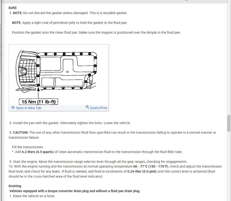

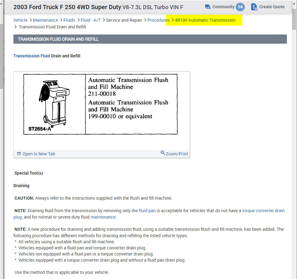

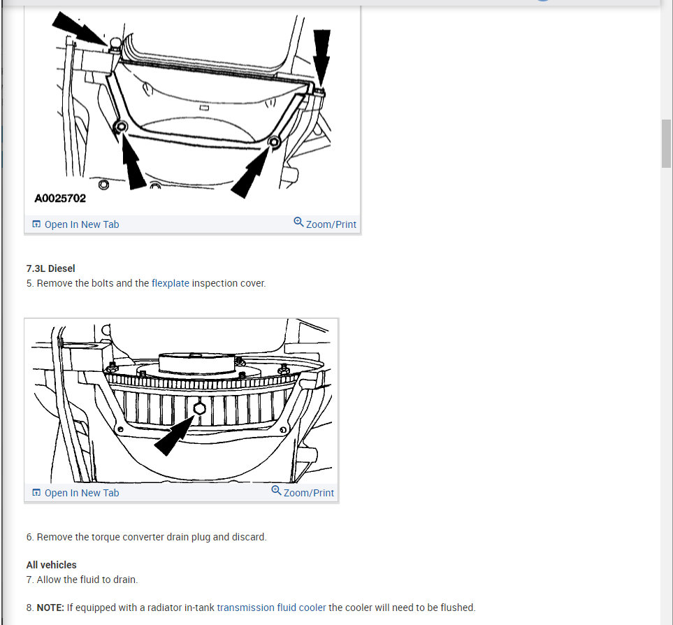

How many quarts does it take?
Oct 17, 2018 at 10:09 PM
This all depends on what transmission you have. There were two options for this engine so I am going to include both processes and info.
Here are a couple guides that will help with general info and a video that shows how to do this on an F-150. Clearly it is slightly different but same basic steps.
https://youtu.be/A-X4afWLLO8
Below you will find the info from the manual that will help with any other detail needed. Please let us know if you have other questions. Thanks
