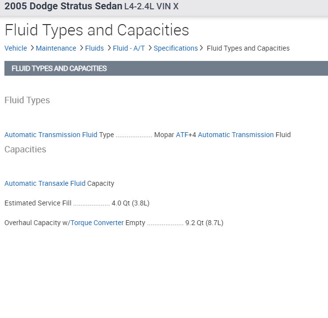

I am unsure on exactly how many quarts does it take of transmission fluid. We just had a used transmission put on it.
Jun 18, 2022 at 10:05 AM
SQM
  • 6,383 POSTS
The total capacity is 9.2 quarts of ATF+4.
If you are doing a simple drain and fill, it will use four quarts.
Let me know of any questions.

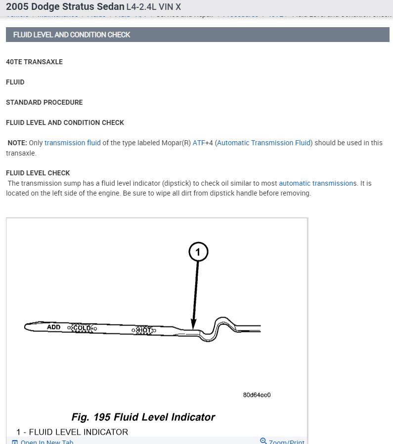

https://www.2carpros.com/articles/how-to-check-and-add-transmission-fluid
