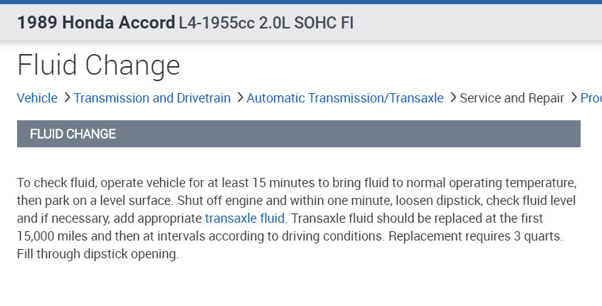

What is the proper way to check the transmission fluid level on my car

I've heard people say to warm it up first, but other people say check it cold. What's the right way for this car?

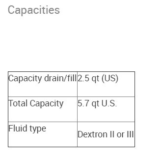

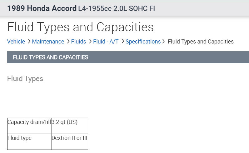

In the diagrams down below I have included the proper way to check your vehicle's Automatic Transmission Fluid from the vehicle manufacturer. I have also included the recommended fluid type and capacities for you as well. Please go through these guides and get back to us with how everything turns out.
