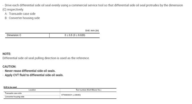

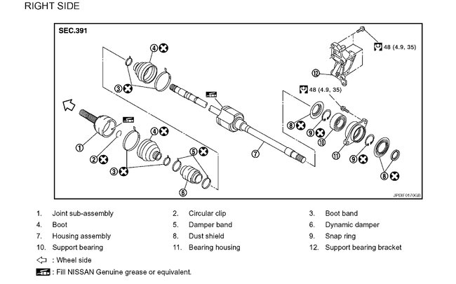

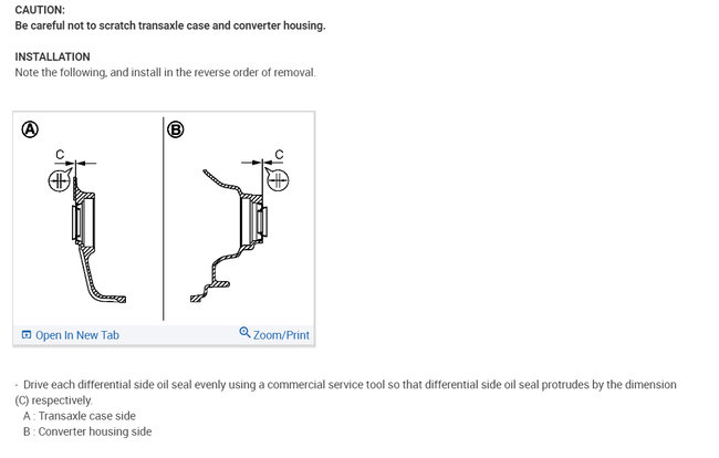

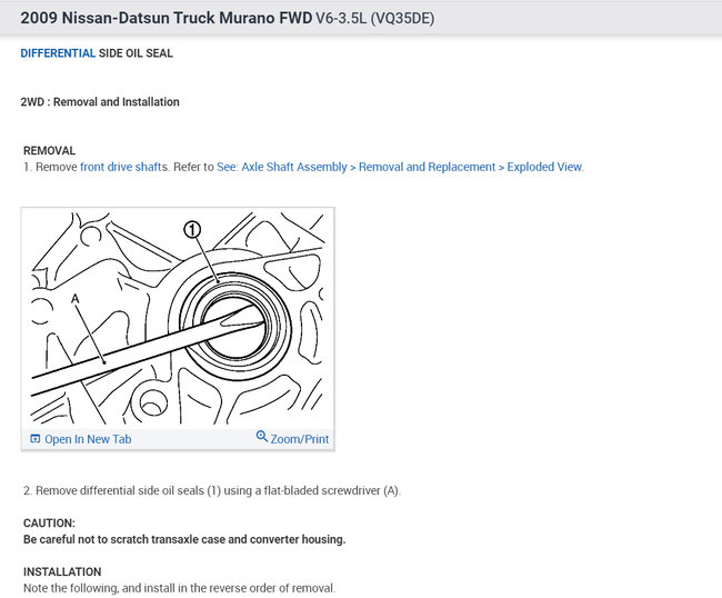

It sounds like the seal is not in correctly or the CV axle is not all the way installed into the transaxle. If you can upload a video or picture of the leak, I can tell for sure. Here are the instructions for replacing the CV axle and seal. Make sure you don't damage the seal upon installation. Check out the diagrams (below). Please let us know what happens.

Sorry, the video does not show the axle but for a split seconds but from what I could see it is not installed completely. I would remove the axle and adjust the "C" clip so it is not so tight, also you can use grease to help center the clip when you installing the axle. This clip is what holds the axle out from being installed completely.
