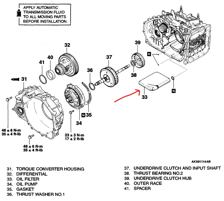

Where is the transmission filter located?
200,000 MILES • 2.4L • 4 CYL • 2WD • AUTOMATIC
SLIDE65
I couldn't find any videos or helpful information on how to replace it or anything else.

The filter is inside the transmission which cannot be changed unless you take the transmission part. Please check out the images below to see what I am talking about.
