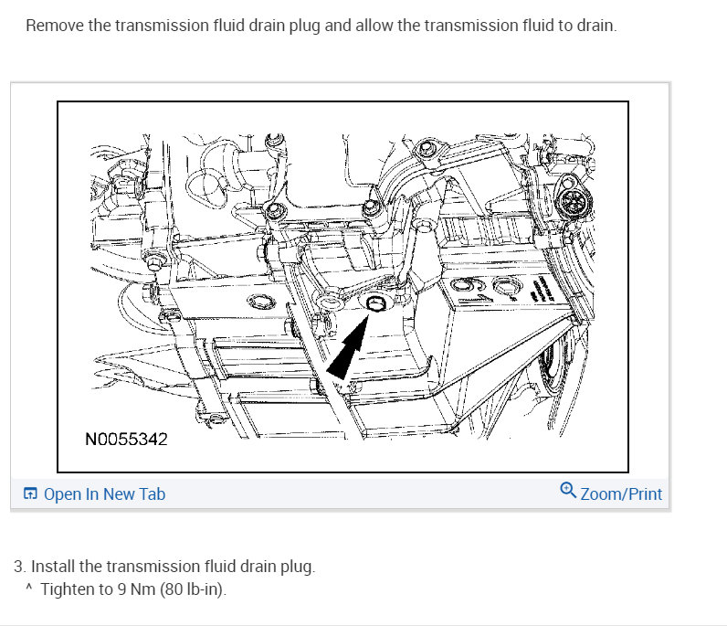

I need to find out where the transmission filter is located in my car listed above. It needs to be replaced.

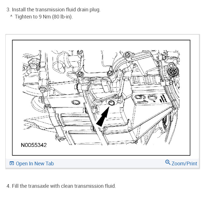

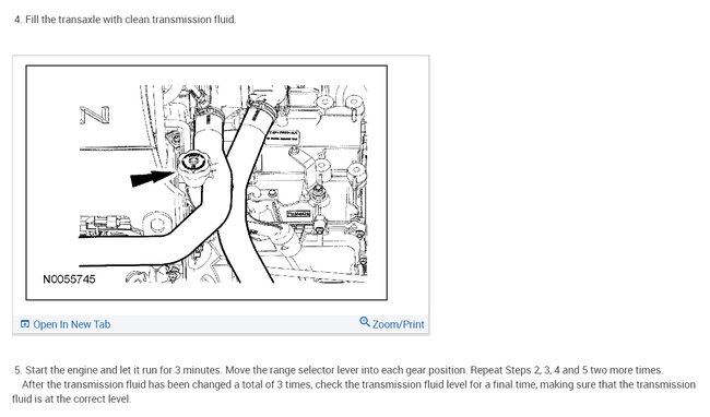

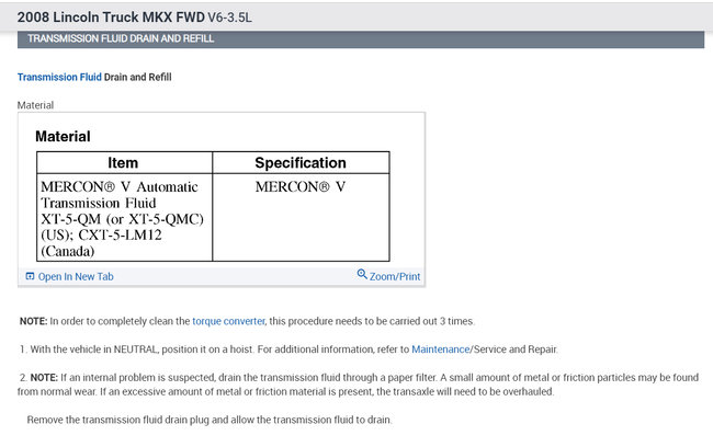

This transmission does not have a filter it kind of like a Honda transmission where you just change the fluid. here is a guide to help you see what you will be doing and instructions on how to service the transmission in your car in the diagrams below.
Fluid Types
Transmission Fluid Type
Type .................... MERCON V XT-5-QM
Capacities
Transmission Fluid .................... 10.0 quarts (9.5 liters) Empty when you service the transmission it should only take about 6 quarts.
Note: Indicates only approximate dry-fill capacity. Some applications may vary based on cooler size and if equipped with an in-tank cooler. The amount of transmission fluid and fluid level should be set by the indication on the dipstick's normal operating range.
