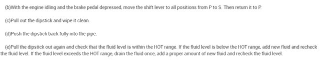

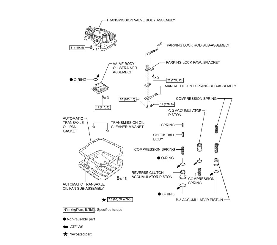

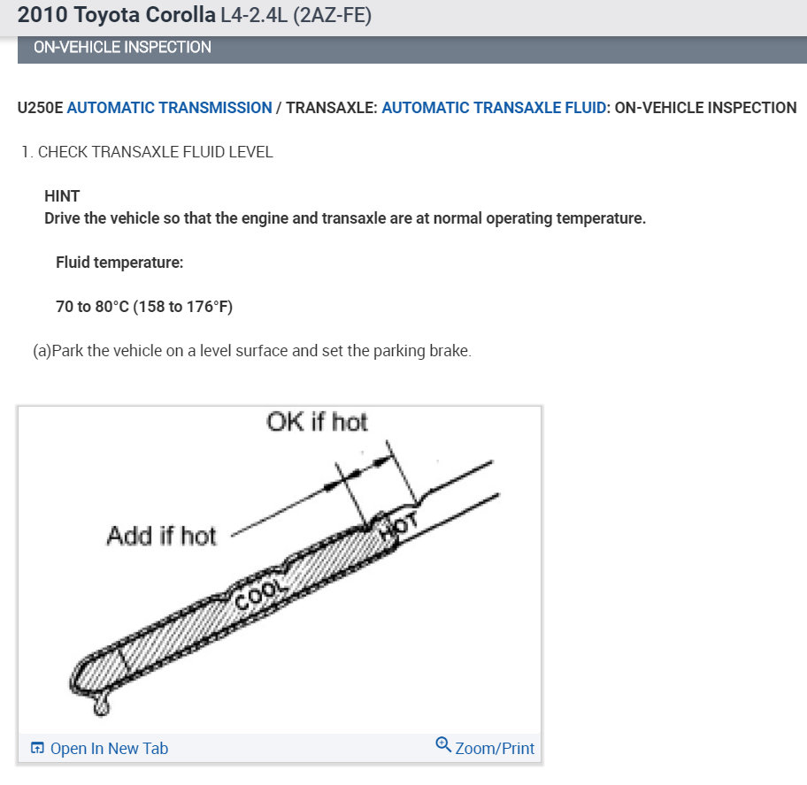

Yes, I would change the fluid these transmission need all then help they can get. Here is a guide to help walk you through the steps and spec and instruction in the diagrams below:
As far as a recommendation goes, Toyota says its good for life, but if I was changing the fluid at say 50-60k I would do a filter as well
Automatic Transaxle Fluid
Capacity .................... 8.2 qt (7.8L)
Type .................... Toyota Genuine ATF WS
Using automatic transmission fluid other than "Toyota Genuine ATF Type WS" may cause deterioration in shift quality, locking up of your transmission accompanied by vibration, and ultimately damage the automatic transmission of your vehicle
