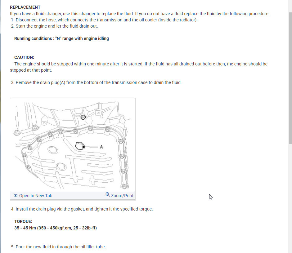

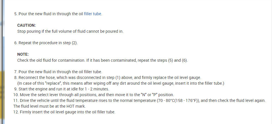

How do I change my transmission filter and fluid?
Apr 26, 2016 at 3:20 AM
Experienced Mechanic
18,907 POSTS
Here is a guide that will help with step by step instructions on how to do this service:
Below you will find the process from the manual that will give the additional detail needed.
Please run through this material and let us know if you have other questions. Thanks
