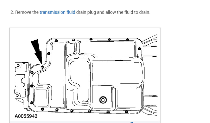

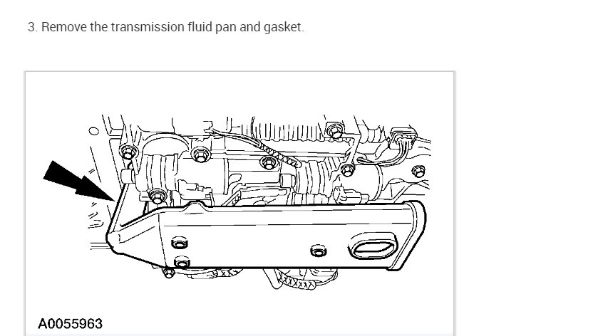

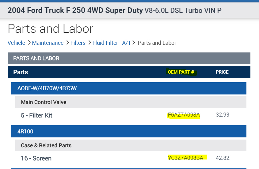

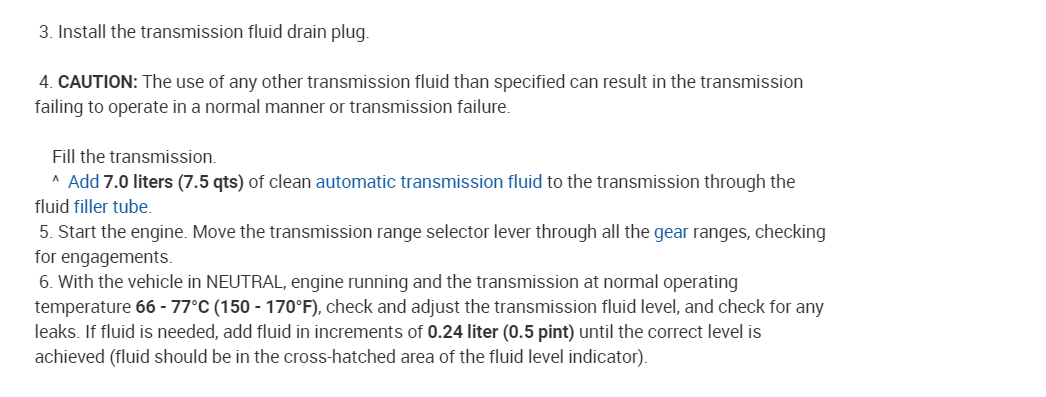

TAKTO101

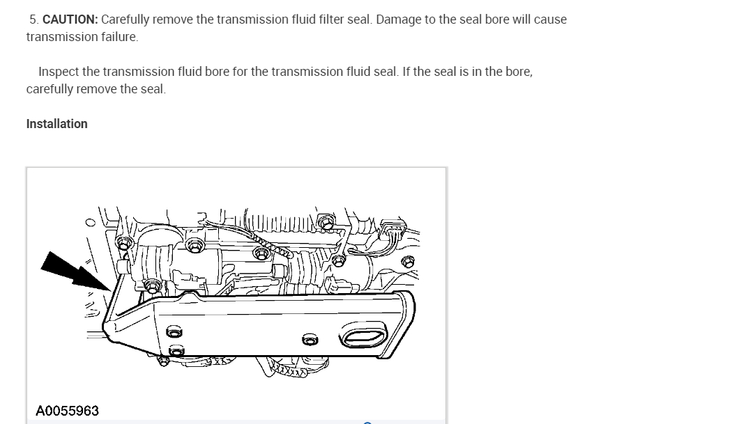

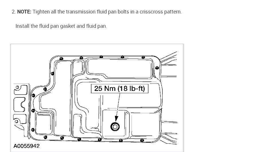

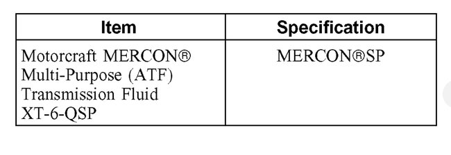

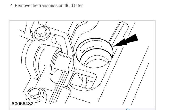

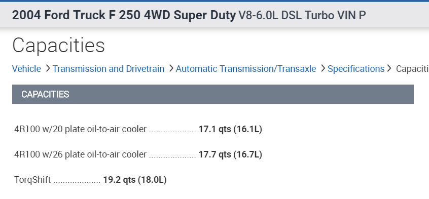

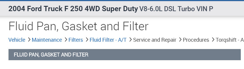

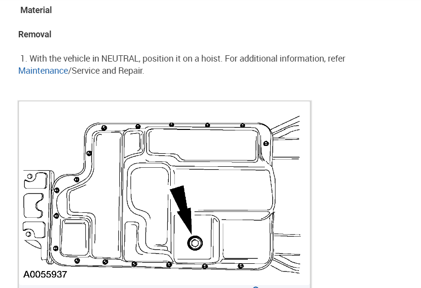

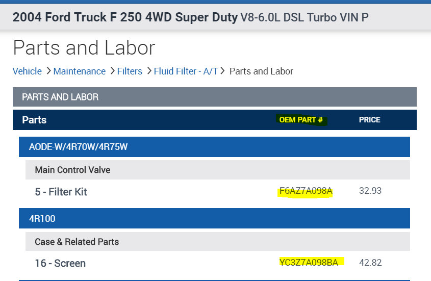

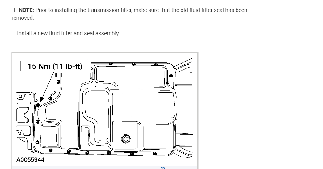

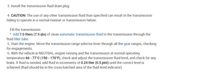

i would just like to know what transmission filter i need to order for the thing? Thank you
Sep 2, 2019 at 2:07 PM
SCGRANTURISMO
  • 4,897 POSTS
In the diagrams down below I have included the Original Equipment Manufacturer (OEM) parts numbers and the instructions for the removal and installation of your vehicle's transmission filter. I have also included the capacity for refilling your transmission as well. Please go through the guides and get back to us with how everything turns out.
