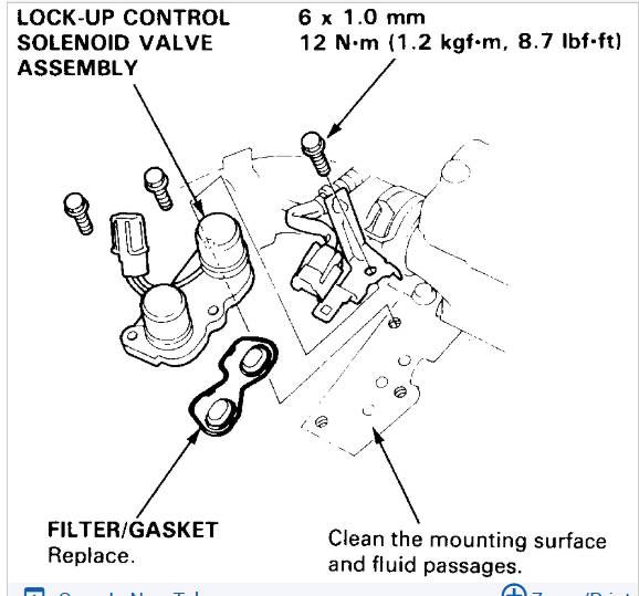

What is the procedure for changing the transmission filter and also I am getting a flashing d4 drive light and check engine light resulting in a code p1753

A P1753 code is usually related to the automatic transmission lock-up control system, commonly the lock-up solenoid / torque converter clutch solenoid circuit, not normally a clogged transmission filter by itself. I would swap out the control solenoid pack, fortunately it is easy because Honda did a great job designing the transmission. Check out the images (below). Please let me know what happens.

I have swapped it out and now that is why him getting the flashing drive light now and idk if the part I got is faulty or what is going on exactly or how to make this problem go away

When you swapped the part out did you change the transmission fluid? If the fluid is worn out or low it can cause issues. Also, did you have the same problem before changing the part out?

No we did not change the fluid and it hasn’t been changed since I got the vehicle and it has 220000 miles which is why I asked how tk change the filter also and yes it has a similar problem just a different code resulting tk the solenoid lockup and now I get the 1753 with flashing drive light so hopefully the fluid change will fix it

The filter is more like a screen and it is not serviceable, (inside the case). I would drain the fluid out and refill with fresh fluid. If this does not help something inside the transmission might have failed such as the torque converter, also, I would swap out the shift solenoids again to make sure you did not get a defective part.
