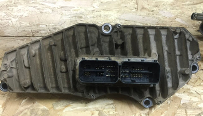

The battery in my car listed above died last night. When I started it up after getting a jump, the message “transmission fault service now” came on as well as the engine light. This morning I had the battery replaced, but the transmission message still comes up, however the engine light is off and when I plugged two different code readers they pulled up 0 codes. Do I just need to do a reset?
Jun 24, 2020 at 8:31 AM
BMDOUBLE
  • CAR REPAIR CONTRIBUTOR
  • 1,139 POSTS
Sounds just like a faulty transmission control module! One thing in common with all of the ones that fail is that the prnd indicator in the instrument cluster will not highlight the gear selected, like park when you first go to start it. Sometimes they will have a trouble code stored either like in your case.

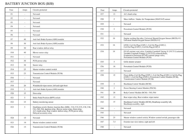

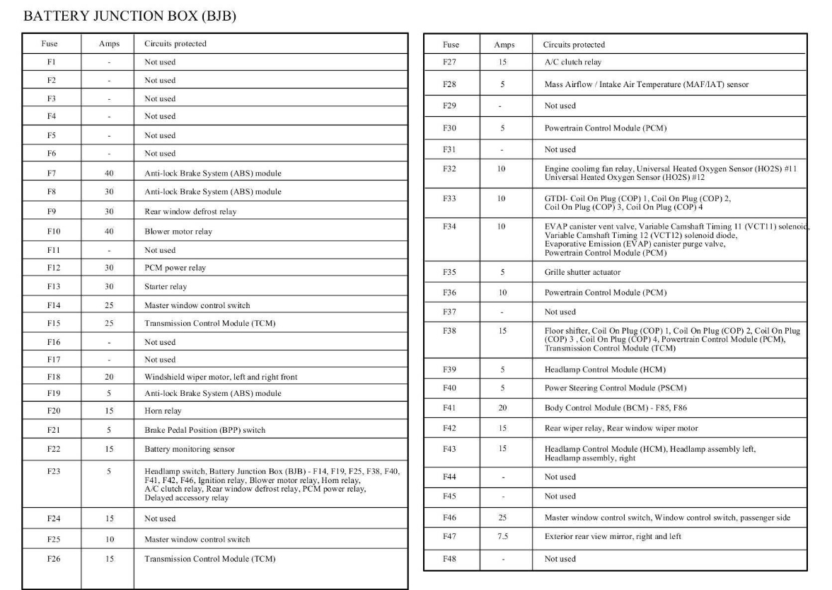

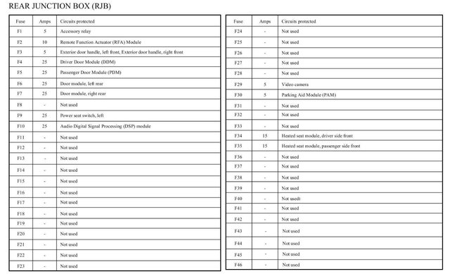

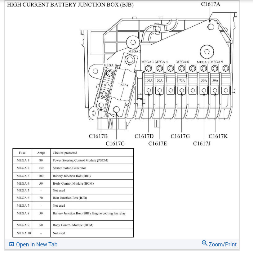

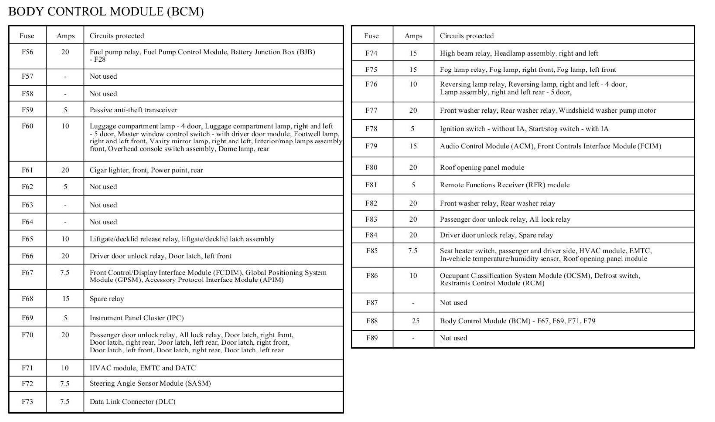

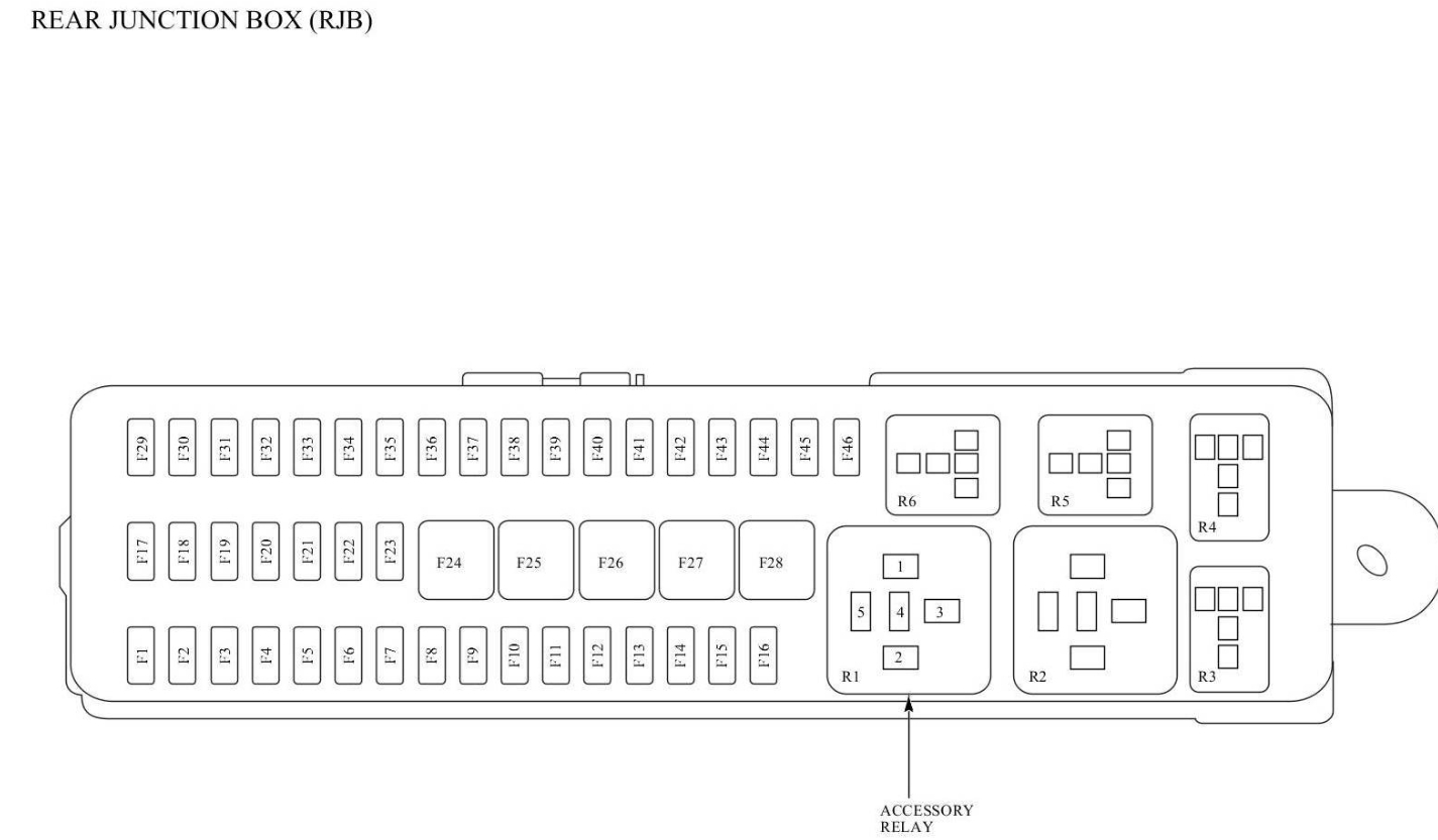

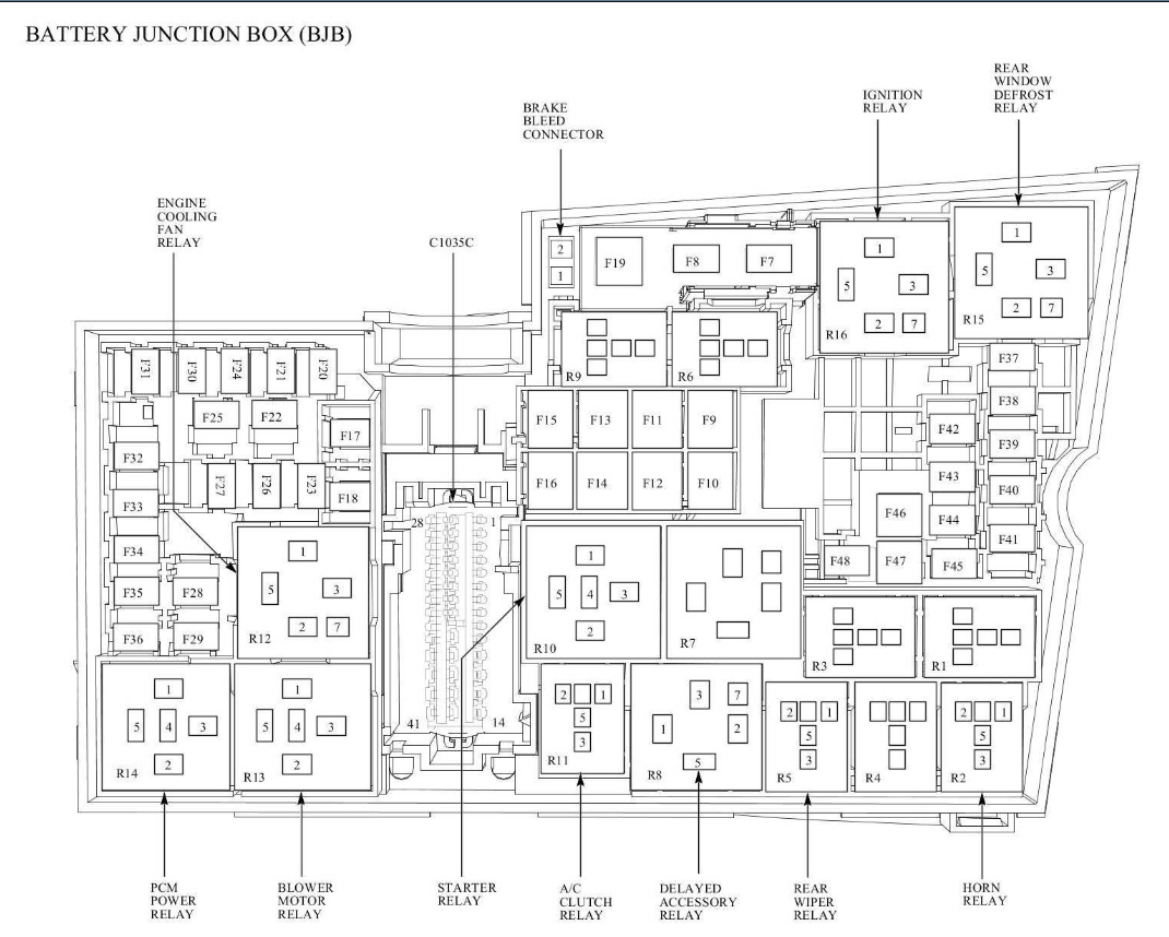

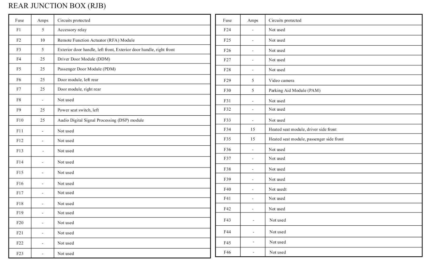

You may have had a voltage surge when the battery was jumped/battery replaced. lets check the fuses just in case one blew. Here is the guide with the fuse location as well:
Check out the diagrams (below). Please run this test and get back to us.
Jun 25, 2020 at 10:51 AM
DANDYJIM
It’s actually starting to act like the transmission is going out. But there’s no check engine light.
Jun 25, 2020 at 11:05 AM
  • 54,189 POSTS
Are the fuses good?
