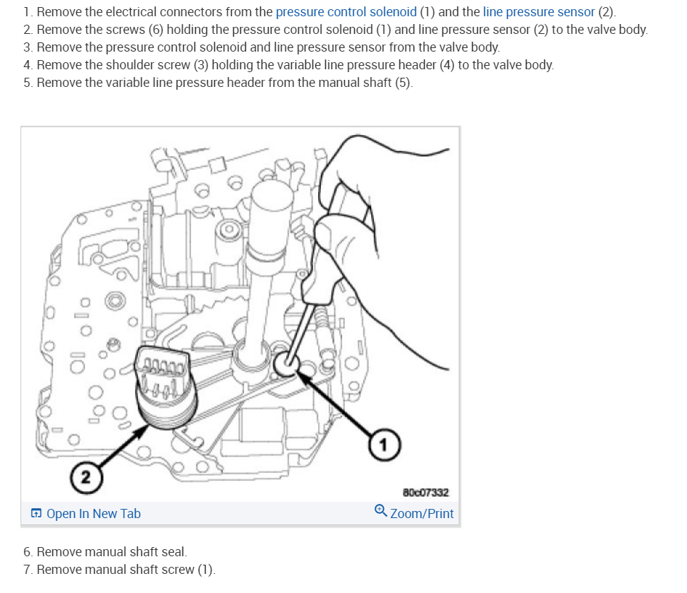

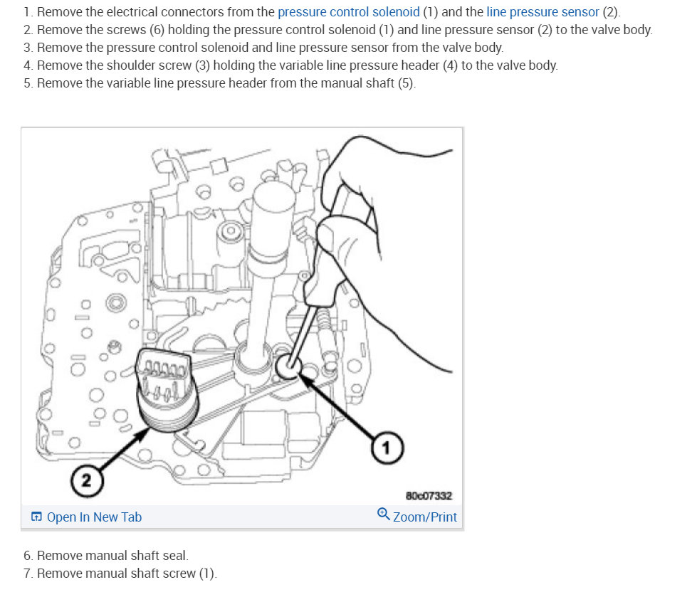

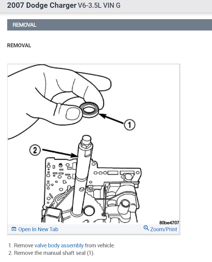

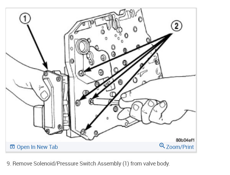

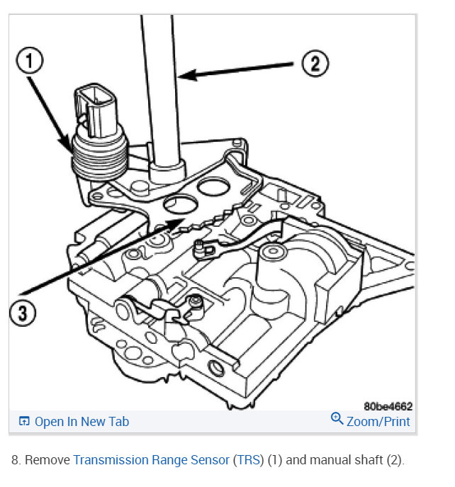

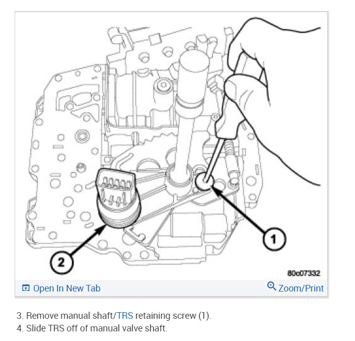

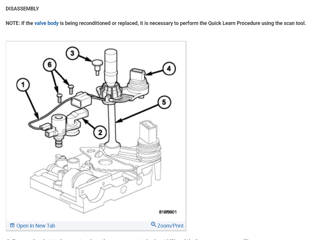

Car drives on one gear, have changed TCU and ECU, I need to know if the transmission switch range sensor is on this car, I am sure this could be the problem. May I have its location on the gear box, I mean the trans switch range sensor. I also changed the ABS Unit, still on one gear, I changed the transmission, bought a new one. Sesame problem. Please let me have a diagram of the transmission switch range sensor.
Aug 21, 2022 at 9:02 PM
  • 55,433 POSTS
Sure, no problem but can I ask if you have run the codes? This guide can help, and I have included the gear range sensor location and replacement instructions in the images below.
It looks like the transmission gear range sensor is inside the transmission connected to the valve body. Check out the images below to see how to replace it. Let me know what happens.
